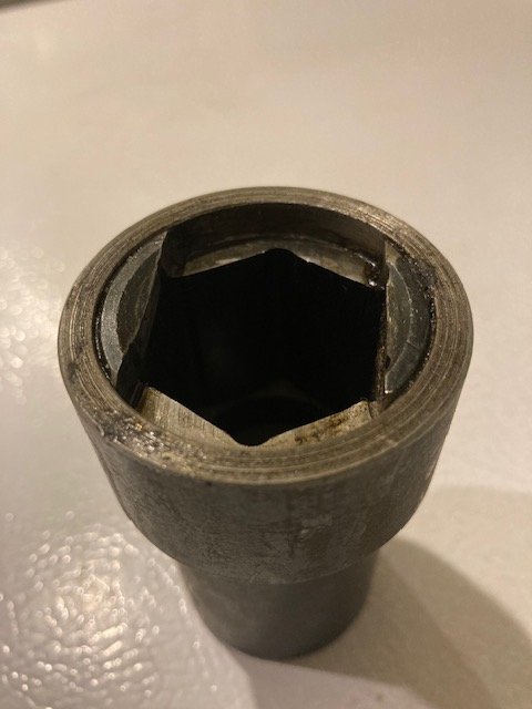

Last I checked cam pins are $1.25 each I try to keep a couple of each new & used on hand all the time. A open end wrench adjustable or
not is not the best option The sockets are kind of pricy but well worth it if you don't have tools to work with. This is the socket I made
for this. One 1 1/8" deep socket ( swap meet or HB set if you don't use that size ) a die grinder & cut off wheel a small piece of 1 1/2"
schedule 80 pipe, bored on the lathe & pressed on in the Hyd. press. Use the old 1/2" impact you almost trough away not the new one. Craig.

Craig,
Your custom built socket is a creative and affordable way to make one. There are other ways to make a crude one that doesn't require a lathe but might require a welder. I enjoy seeing the different ways to solve problems.
