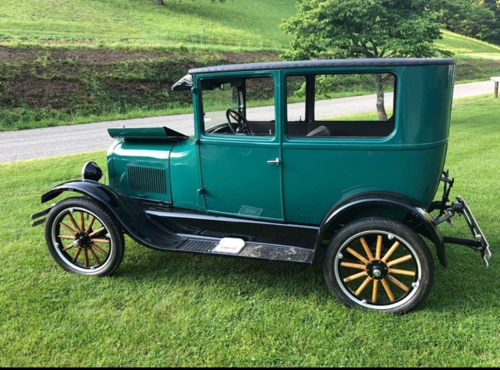

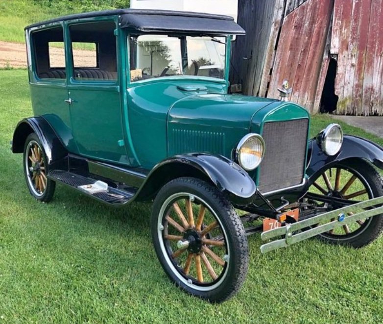

Hello all. This is my first post to the forum. Last week I finally pulled the trigger and bought my first T. A 1926 Tudor.
LOTS to learn but I am enjoying every second of it. I am trying to identify the shade of green the car is painted in but am having some difficulty in getting an exact match. I have.seen others painted this color but no one mentions what shade it is. I am trying to get a touch-up pen for some minor stone chips.

There is no way of knowing what actual color your car was painted, so finding touch up paint based on a paint code is not going to work for you. A good auto paint supplier will be able to match the color based on a sample you provide. The fuel tank door is a nice size part to use as a sample and can be removed by 2 screws and 2 nuts accessible by reaching thru the windshield and under the dash if I remember. They should be able to provide paint in a pen, rattle can, or can. Think if you want enamel, lacquer, epoxy, etc. Price of paint may be a shock if you haven't bought any in a while or ever. You may find leaving stone chips and scratches alone might not be so bad after all.
You have a nice looking T, welcome to the affliction.

Take it by an automotive paint store and get them to scan it. They will be able to get you a very close match.

only thing I would add is that based on what I see on my computer screen, it looks very much like a green paint used on 1929 Model A's. I'd swear it is a match for the '29 I restored when I was in my teens.

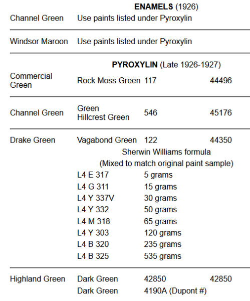

Your best bet is to see if you can find out what it was painted with from the seller. Paint names can be deceiving as well. PPG's "Hunter Green" may be very different than Rust-oleum 's "Hunter Green". Here are the '26 Greens - if you were to Google the names in the second column you might see something to get you in the ball park. But they may return "greens" of a different name and colors on computer screens are never the exact color. So the only real way to match is like the others have said - scan it.

Great looking Tudor, but I have one suggestion. Since the light rims, radiator apron trim piece and radiator neck are nickel plated, I believe it would look a lot better and be more correct for a 1926 Tudor if the radiator shell were nickel plated. Jim Patrick

The last radiator shell I had plated cost $660 to plate, and it was a really nice one to start with. Your painted one may be painted, because rust pitting may have been too deep to polish out. You are well ahead otherwise, having the correct nickel plated bumper irons. Certainly get to a paint shop and have them match what you have.

Eric, that is a nice looking car. My wife likes our Tudor, especially if the weather is on the cool side. I notice it has 30 x 3.5" clincher wheels and tyres. These are not usual on 26 models, though some did come that way. I also see there is no spare tyre on the carrier. if it is missing and you need to find one, be aware that it may not fit your spare carrier. The bolt on Y piece may be for the smaller, more usual 21" rim.
