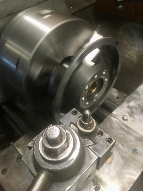

I didn’t see one for February so here goes! drilled out crank pin holes to lessen tail shaft runout. Turned main shaft flange to true up to the crankshaft.

re riveting of drive plate. Pressed in bushing and turned drive plate brake drum mating surface.

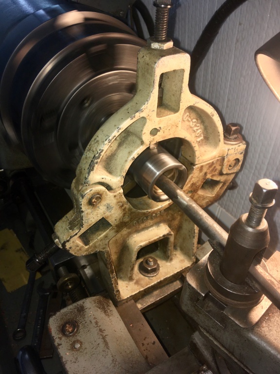

bored drive plate bushing

turned brake drum mating surface and bored brake drum bushing. Not necessarily in that order but the pictures wouldn’t line up right . Oh well :lol:

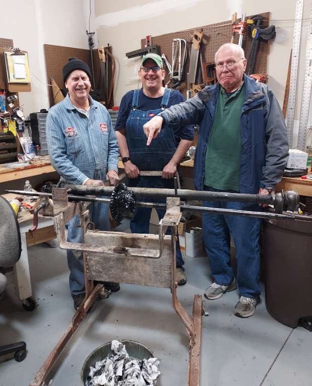

Some of the members of the Northern Michigan T's got together to help an 87 year old Model T owner get his car roadworthy. We pulled the rear axle and tore it apart. Filled with black goo so thick it wouldn't drain even after splitting the pumpkin.

such a nice thing to do...and a nifty rear axle service stand to boot!

The stand is a StevenS.

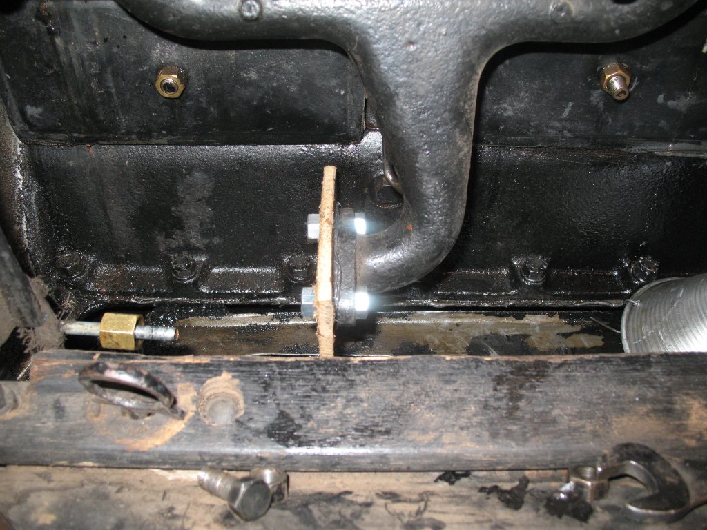

Today I made a permanent carburetor gasket on my intake manifold so I won't have to bother with lining up the holes on a loose one whenever I bolt in a carb. Ultra Black on the manifold, then a thick paper gasket, then another layer of Ultra Black, and finally a greased piece of Masonite to flatten the sandwich. I'll let it set overnight, then reinstall the carburetor tomorrow.

Steve, I used your sandwich method on my Bendix cover, it works great! I removed the cover, attached the gasket/RTV sandwich to it, and set it on a piece of wax paper on a flat countertop. Then I stacked a couple of books on top of the cover to press it down and let it set up overnight. :)

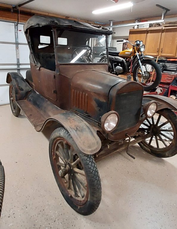

I used the cold February weather to get my 1924 runabout going after being asleep for 60 years.
Pulled the head to clean out the water jacket and carbon buildup, replaced the original two-piece valves with one-piece valves, new radiator hoses, pulled the oil pan inspection cover and flushed the engine, cleaned the carb, new transmission bands, new battery, new battery cable, new switch harness, dissembled and cleaned the starter and generator, adjusted the coils and gapped the plugs, new front axle shackle bushings. lubed everything that moves. And now it starts right up and runs smooth and strong and everything works but the speedometer. Rear axle thrust bearings will be the next project.
Awaiting the snow to melt so I can take it for a test drive.

Mr. Humble, I hope you enjoy your runabout when you get it out. Positively gorgeous machine!

Is that small amount of paint original? I used to see 2 cars in about that condition running on the street in front of my house. One had a good top and paint the other had a "rag" top that flapped along as it went down the road. This would have been sometime during the 1940s. Gas and tires were rationed in those days and people only drove short distances. They likely worked close by or were going for groceries. We saw many old cars then because of the depression, people could not afford new cars and then the war when no civilian vehicles were being manufactured. Even for a couple years after the war, there were waiting lists for new cars. My dad had about a 2 year wait and had name in for several cars. First one he could get was a Nash which was quite a lemon.

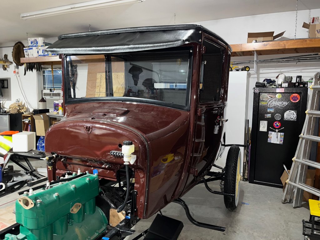

Finished up the engine and wiring on the Camping Car.

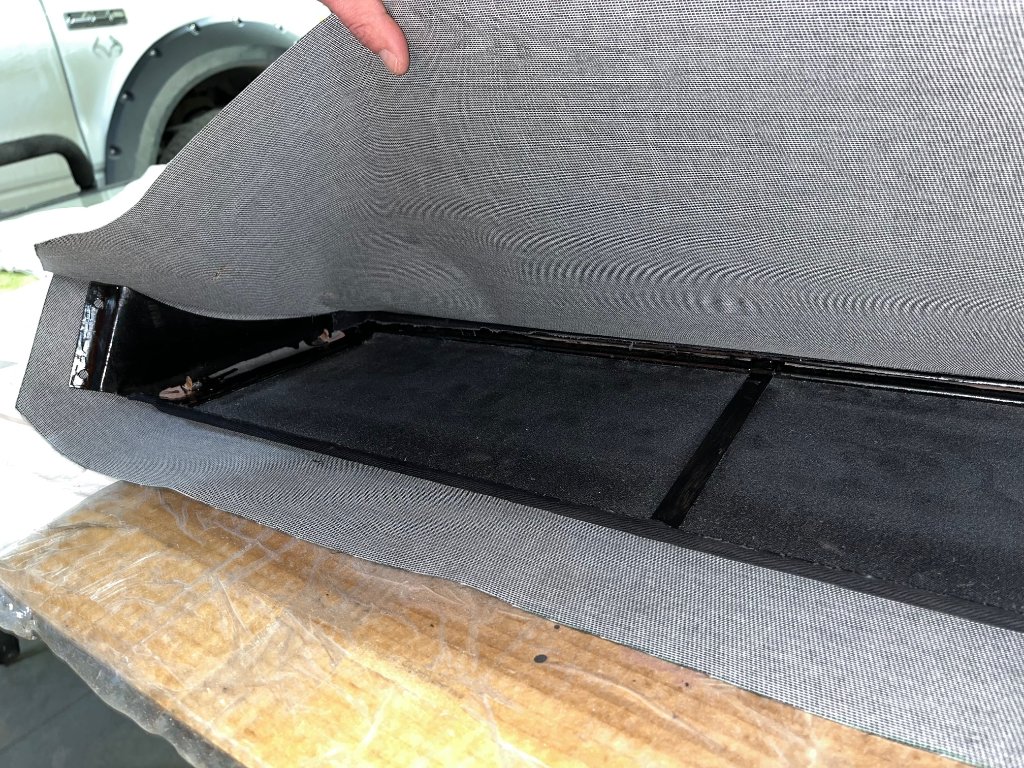

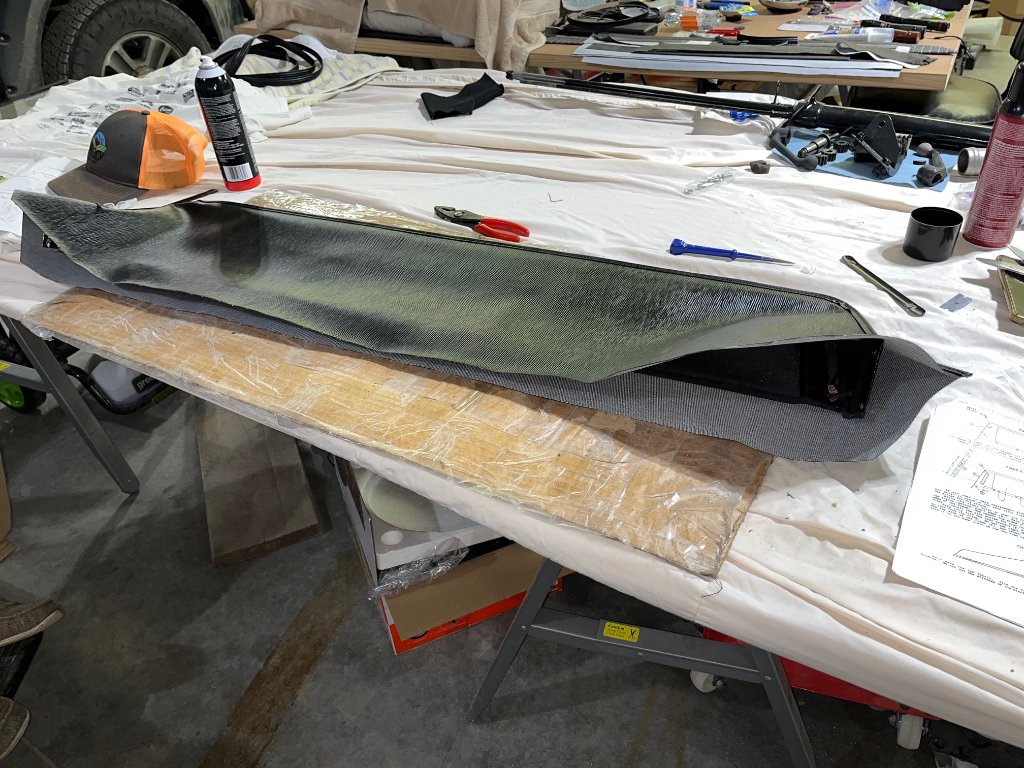

Installed the sun visor on my 1927 coupe.
