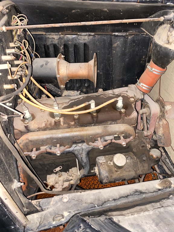

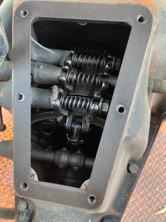

Here’s 2 pictures, one of the engine and one of the transmission from the inspection port.
- Posts: 4692
Re: Model T engine or transmission locked up.
Your brake band looks a bit odd. There is loose band material in the fork where the shaft goes through next to the spring. Can't tell from the picture, but looks like something might also be stuck under that edge of the band. It is possible some of that could be locking the brake band and causing the brake to bind. Also depending on what kind of oil you are using, the cold weather could be causing thick oil to bind the clutch disks, however if the Warford is in neutral, the clutch disks should not cause it to stop turning. In order to determine whether you have anything stuck on the magnets or starter ring gear, you would need to remove the hogs head to inspect.

Hi Jacob,
Welcome to the ever puzzling Model T hobby. I have seen crank ratchets modified to turn the engine both directions may be a possible option.
You definitely would want to try turning it backwards before forcing it forwards. You said it turned over just before it locked up? So a stuck
valve or piston is not very likely. Something falling into the triple gears or getting wedged in the ring gear or magnets sounds possible. Have
you tried going in through the starter hole and gently prying the starter ring gear backwards. You can also put a 9/16 wrench on the clutch
cover bolts through the trans inspection cover. Good Luck.
Craig.

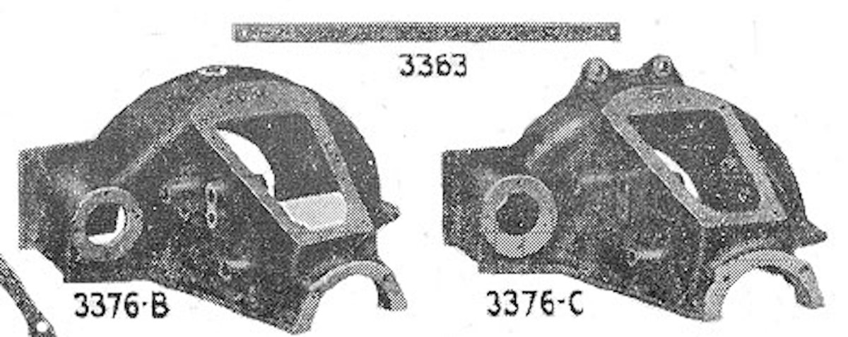

Norm isn't that a large drum hogs head on a small drum trans?
Craig.

Yup, that's what he's got there.Craig Leach wrote: ↑Sun Feb 26, 2023 5:02 pmNorm isn't that a large drum hogs head on a small drum trans?

Thank you for the suggestion Norm. That picture was from a while ago so I pulled the material of the brake band and it looked like it was a felt washer. I am not sure of the history of this truck because it belonged to my Great grandfather who has passed on. I do know that it was overhauled in the late 80’s or early 90’s but that is about it. The only modifications that I know of are the Warford transmission and the water pump. What does it mean if I had a large hogs head on a small drum transmission? I also have a 26 TT C cab that also belonged to him that is in storage. Could it have been swapped for that one? Anyways, I will try reversing the crank the next time I work on it which will most likely be next weekend. I’ll keep you guys posted.

It means that the brake band will not be centered on the brake drum. See how the band hangs over the back of the brake drum? It's not supposed to do that. The brake band should be located nearer to its neighbor, with maybe just an 1/8" gap between the two.Jacob Mangold wrote: ↑Sun Feb 26, 2023 5:41 pmWhat does it mean if I had a large hogs head on a small drum transmission?

Will it still work with this hogs head Jerry? Will it cause me more problems down the road? Also, I don’t think a rod or the crankshaft would be busted because I was just cranking it by hand but I will look anyways.

you really must put the correct hog's head on the transmission. As it is, with the later one installed, your brake band is riding off of the brake drum due to it being positioned offset to the drum and expecting a much wider drum to be under it than there is...so now that you know that it MUST come off for replacement, you can take the opportunity to study what's going on inside.

Scott, how do I tell the difference between a large drum and small drum hogs head?

The large drum HH has a larger bulge on the right side, should have two ears on the top to bolt it to the engine, the spacing between the
peddle shafts are not the same, the low & brake peddles should be the wide style & the mag post is a pipe threaded hole instead of a hole
with 3 screws.

the large drum hog's head (meaning "wide" brake drum) has the pedal shafts spaced differently than the narrow drum hog's head.
your hog's head is meant for a wider brake drum...because your brake drum is "narrow" or smaller, your hog's head has the brake shaft much further "back" and the brake band is running off of the narrow drum...if your drum was the later, wide style, the brake band would fully cover the drum and would not be running off of the drum.
"Wide" brake drum transmissions were from late 1925 through to the end of production in 1927. Being that your truck is a '24, it correctly has the "narrow" brake drum in the transmission, but someone has fit the latter hog's head over it.

OP turned the motor over "a few revolutions" then it locked up.
Smells like a dropped piece of hardware finally jammed.

One blatantly obvious clue makes it easy to ID a 26-27 hogshead. It has those two "ears" on top with holes in them for bolting it to the back of the engine. All previous hogsheads lack the ears.

WELL waiting to see but no one said pushing a TT is easy
The Worm drive rearend
Try turning it over with the crank
With aux trans in neutral
Also had mine lock up once in the high speed clutch
With the hand brake pulled back check the clutch figure see if they are loose and set right
Nv bob
BTW brake & Rev. Band appear to have soft material between the band ears and the hogs head?
Nv bob

The idea that you can't push a TT truck because of the worm drive is a myth. My '22 TT has the lower-geared rear axle (7 1/4:1) and a Muncie auxillary transmission. With the Muncie in neutral and the truck on level ground I can push it with one hand.
Worm drive gear boxes are known to be hard to turn from the output shaft. This is because they usually have a much lower ratio (10, 12, 20:1 or even lower) than what these trucks have.
Put your Warford in high or overdrive and the Ford transmission in high and you should be able push the truck backward a little to back the engine up.
Good luck and welcome to the affliction.
Bob

Here's the bottom line. Barring anything simple, like a stuck Bendix, something is wrong either within the engine, or the transmission. Pushing, prodding, oiling and guessing may break it free, but it won't fix anything. Until you get "into" the engine & trans, you'll have the same problem you began with and the next time it shows up, the engine may be running and something might actually break. Count yourself lucky that it jammed up only while cranking. Further guessing and theorizing is fun, but it's time wasted, (mostly), that you can be using to get to the absolute root cause.

What makes me wonder is the fact that I could not push it even though the Warford was in neutral. That should have disconnected the read end completely and I should have been able to push it forward with the engine locked up. I will keep you guys posted on if I get the engine freed.

Parking brakes could be stuck.

It might not be this but it has happened, cranking it slow then it locked up, one thin to look at is the u joint pin might have fallen just enough to lock up everything, Bob
- Posts: 5021
That is another possibility. Its easy enough to check. Remove the upper & lower pin access cover bolts & have a look.
The pin would normally fall straight down.

If is a 26_27 Horseheads it will have 2 ears with 5/8 holes that bolt to the back of a 26 or 27 block. They used the wide brake band.

I fear that like others have stated it may be a magnet keeper, nut or bolt that has fallen off and into the triple gears but hopefully not. You might consider buying an inexpensive scope on eBay that will attach to your smart phone so you can have a good look in that area. It may give you an opportunity to remove what ever if any thing that may be causing the problem. Jacob good luck, it’s always inspiring to see young folks get involved. Let us know if we can help.
Best John

Ok guys, I got to work on my T for a little bit today and I ruled out the crankshaft pulley from being the issue. I am going to check the driveshaft and pull the hogs head on Sunday. Hopefully I get to the bottom of this.
Thank you guys for the responses,
Jacob Mangold
Jacob Mangold
- Posts: 4305
Have a look in the crankcase by removing the bottom inspection cover. Easy to do, and who knowsJacob Mangold wrote: ↑Thu Mar 02, 2023 9:39 pmOk guys, I got to work on my T for a little bit today and I ruled out the crankshaft pulley from being the issue. I am going to check the driveshaft and pull the hogs head on Sunday. Hopefully I get to the bottom of this.

Hello guys. I am working on my model t and I have all of the bolts out of the hogs head and I can’t remove it. It’s stuck and I can pull it up and out. Suggestions?
Thank you for the responses,
Jacob Mangold
Jacob Mangold
- Posts: 4578
Make sure you’ve removed ALL the bolts around the engine pan and the ones where it connects to the drive shaft area. You probably have already. Carefully use a butter knife or thin dry wall knife and very carefully tap on it and carefully in different places around the edges. Eventually it will start to move upwards. Take your time and don’t forget to free up the drive shaft side too.
Sometimes they move fairly easy and sometimes they it takes more effort. Good luck.

Thank you guys for all of the help. I got the engine unsiezed but it was not the transmission. After I got the hogs head off and I could see nothing binding it up I decided to pull the head just to take a look. Well, in cylinder #2, the was corrosion at the top of the cylinder and the piston was stuck because the head gasket was leaky and old. Anyways, I took a 2x4 and a mallet and tapped the piston down and it came free. I wiped out each cylinder and none of the cylinder walls were scored. I installed a new head gasket and torqued it and it turns freely. I also used the thumb method of checking compression and there was enough to blow my thumb out on each cylinder. The only thing left I need to do is replace the gaskets at the back of the transmission which seems like a pain in the rear. Does anyone know how to do that when you have a aux transmission?

- Posts: 5021
If you didnt remove the bottom bolts @ the 4th main, cut a 1/2 4th main gasket. Ultra silicone in, especially the corners.
No need to pull the aux transmission. If you unbolted it & ruined the gasket, clean the area & split the new gasket diagonally @ the top. Fit it in with the 4th main pulled back a bit.
