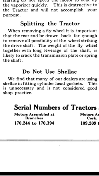

From the FORD T service bulletins; Was in the tractor section but applies to cars as well:
By “shellac”, I’m sure they are referring to any type of coating. FIFTEEN MILLION T’s were assembled with no coating on the head gasket…

Indian Head Gasket Shellac was widely used. Many old type gaskets came with a coating of shellac or some other semi-clear coating. Some people put grease on head gaskets. I don't think that was a good idea. Ford used "Graflox" steel composite gaskets in the 1940s and early 1950s with a light coating of what looked like black paint. The asbestos core material was impregnated with graphite.

It's possible that Fordson head gaskets were coated with some type of shellac at the factory.
