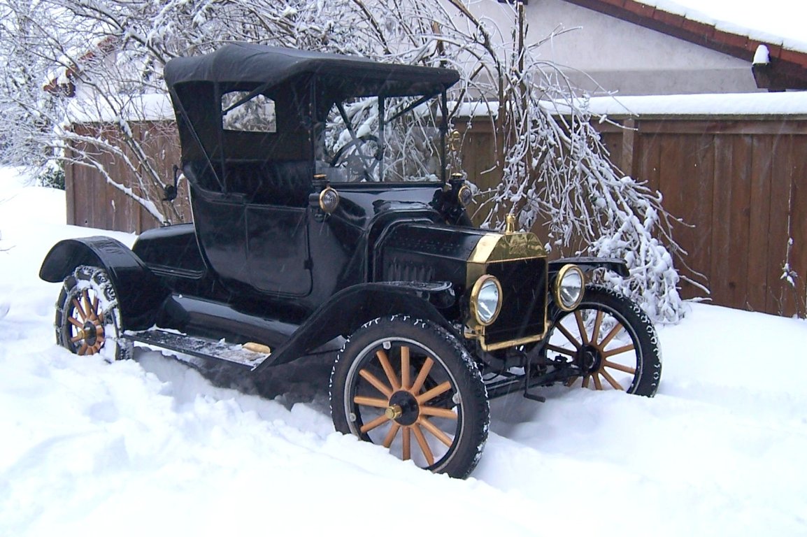

Stan Howe and I having fun in the December snow.
https://www.mtfca.com/discus/messages/1 ... 1323431973

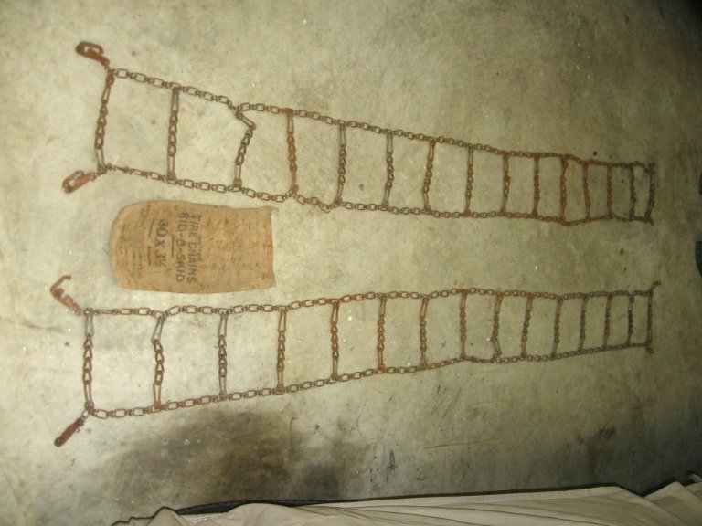

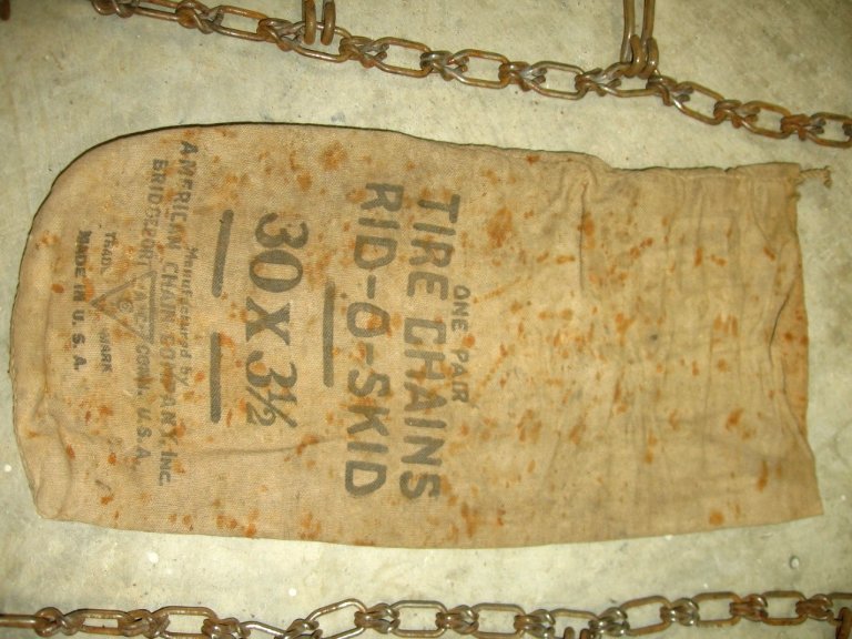

I used to have an original set of "Rid-O-Skid" 30x3.5 tire chains in the original burlap bag, but I sent them to Strong's Garage in Canada (check out their Youtube channel).
If you do manage to find an original set of chains for 30x3.5 tires, be aware that they may be too small to fit on the currently available "oversize" tires, which are nominally 31x4.0 size.
There is some slight variation in tire diameter by brand.
