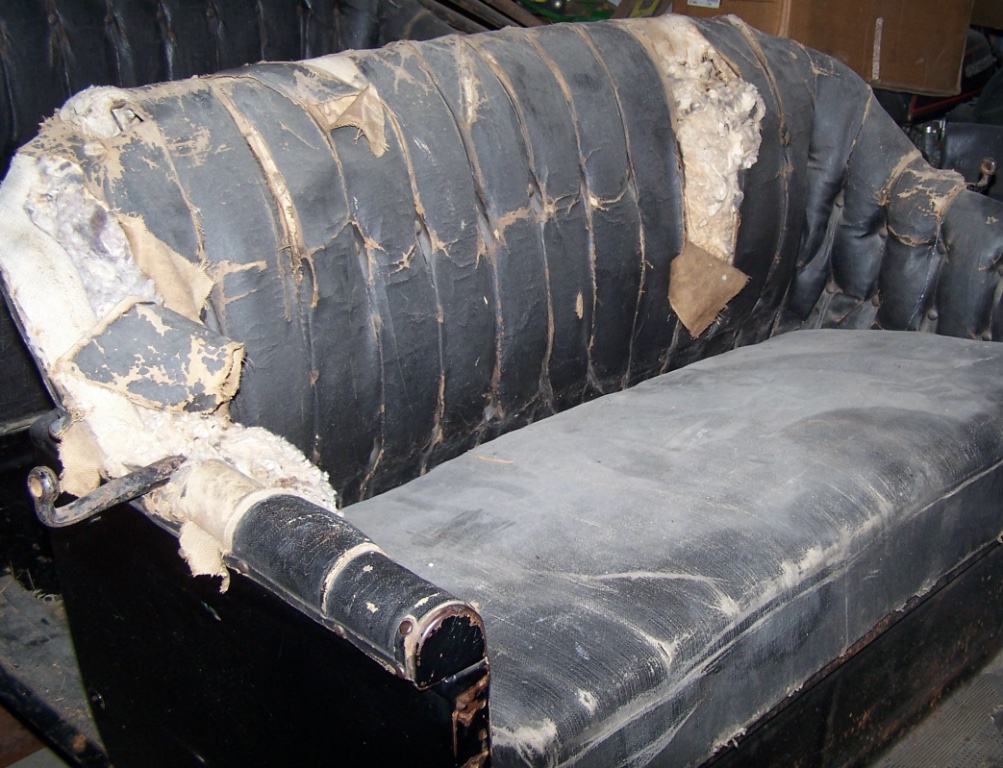

The early T's did feature cushion styles of the day, mostly leather, diamond pleat, stuffed with curled hair.
19909 1910 runabout .jpg (70.46 KiB) Viewed 1409 times
And tastes changed, and Ford's volume made change also in material, and trim style. The animal hair went away, replaced with cotton flax padding, and no leather but artificial 'Ford Cloth' in pleats with buttons. Of course the last T's in '27 deleted the buttons for plain vertical pleats, each stuffed with a smaller amount of cotton flax, comfort came from the metal springs instead of the curled animal hair. If you could call the T seats comfortable :D [/b]
