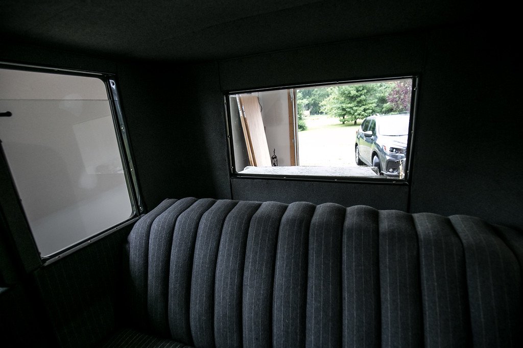

So hear is what I started with. As you can see the package shelf takes up a lot of room and for a tall guy like me it's worth the effort to go after that valuable Real Estate. This will involve removing the package shelf, removing the gas tank, removing the seat riser and then reconstruction.

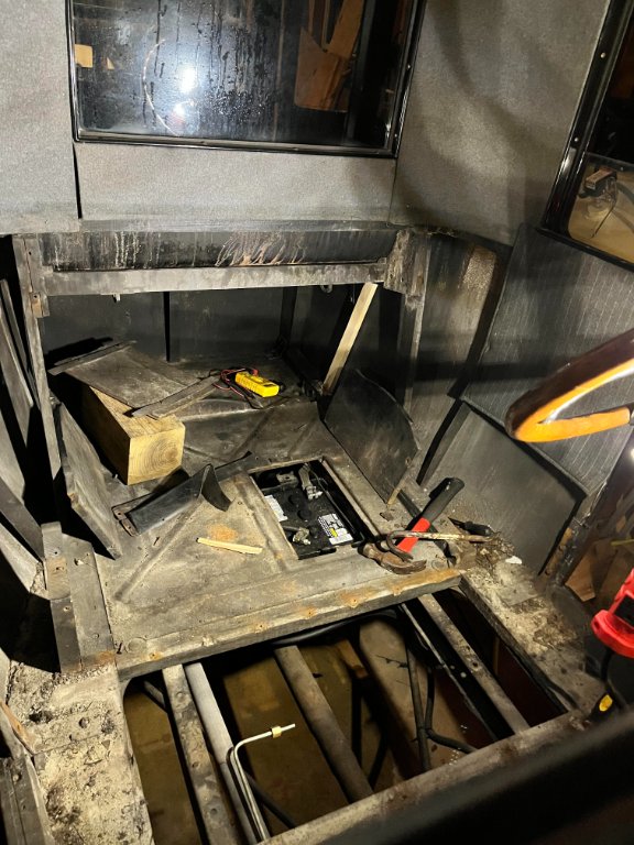

Post by Model T Ron » Thu Mar 02, 2023 8:38 pm
After some effort the interior slowly began to come out.

Hear is the 24 Coupe with the gas tank removed along with everything that needs to come out.

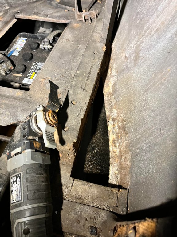

With the help of my good old Buzz Tool I was able to cut the rotted wood out of the floor on my 24 coupe. I cut back to solid wood and boy do you need to be a contortionists ......I sat on the driver side running board with my right hand holding a board under the bad body wood so the tool would cut through the rot and scratch the splash aprion. Then my head twisted around the door opening to see my work and I buzzed the rot out with my left hand (I am right handed). Long story short I think it cleaned up good and I plan on making a patch out of a 2x6 in the morning. My plan it to drill through the original wood and attach the wood patch with screws and glue.

Posts: 4658
Re: 1924 Coupe Gives Back Hidden Legroom
Post by Norman Kling » Sun Mar 05, 2023 11:25 am
Will you need to move the battery and will the gas tank fit ahead of the muffler? It might be dangerous to put the tank right over the muffler especially if near the sediment bulb.

Post by Model T Ron » Tue Mar 07, 2023 10:23 pm
Do you guys think it looks better with the backrest raised to the rear window height? I think it does.

Post by JTT3 » Tue Mar 07, 2023 10:28 pm
I guess the real question is- does your back say it feels right?
Ron really good customization. Best John

Post by Duey_C » Wed Mar 08, 2023 9:33 pm
It sure looks better to me! And the added leg room. Ahhh. I'm tall also. Makes me rethink my love for cramped Runabouts.
John asks it correctly: How's your back like it?
That's not crazy Suzanne. Not at all.
And you could use the driver's door! :)

Post by Model T Ron » Thu Mar 09, 2023 10:13 pm
I knew the pre 24 Coupe's had a bit more legroom and was able to test fit a 1921a few years back to confirm. To be honest I think I found more room in the 24 with a little re-engineering. This modification makes the 24 or 25 Coupe amazingly roomy and trust me it's worth the effort if your tall. At 6'3'' and having long legs I have more room than I need and can actually stretch out.
The seatback feels much better being raised to the back window level so that's it's new home as far as I am concerned..... It also looks better proportioned in my opinion. I hope this trend someday helps someone else find the legroom in a 24 or 25 Coupe that they are looking for. Its not hard to do just take your time and if you find hidden rot fix it.....

Post by Model T Ron » Sat Mar 18, 2023 8:52 pm
Mr. Harper at 5'4'' you are in luck that any T will fit you just fine. On my 15 Touring I had to remove the backrest springs and use foam and after all that I just about fit. Now on my 24 I finished everything up today including mounting the gas tank a few inches back and screwing the seat components back in position. At 6'3'' I have never experienced the joy of legroom that Mr. Harper has but with a little re-engineering I too can enjoy my 1924 Coupe. After everything was assembled I picked up all my tools and added a new rubber mat. Very satisfied with how it turned out.
