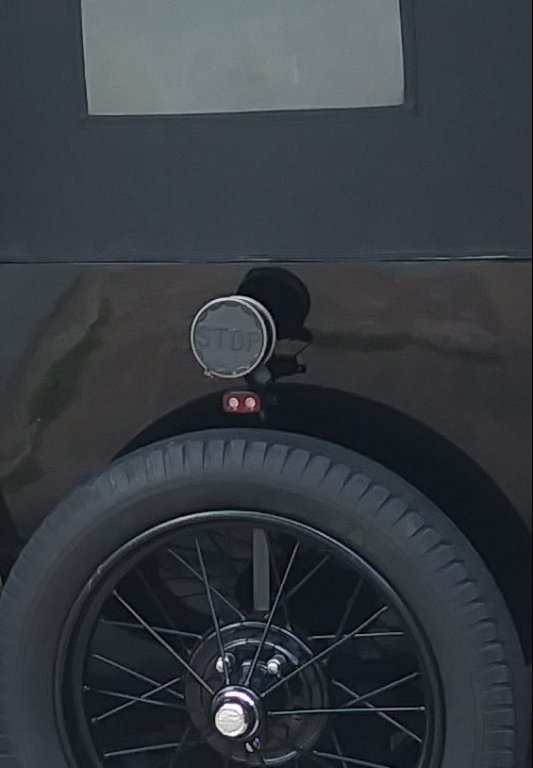

Re: Stoplight Switch
I have a period correct stop light that is wired separately from the tail light. Below that is a new bicycle led flashing taillight that works very well at getting people's attention. They don't race up as close as they did without it.

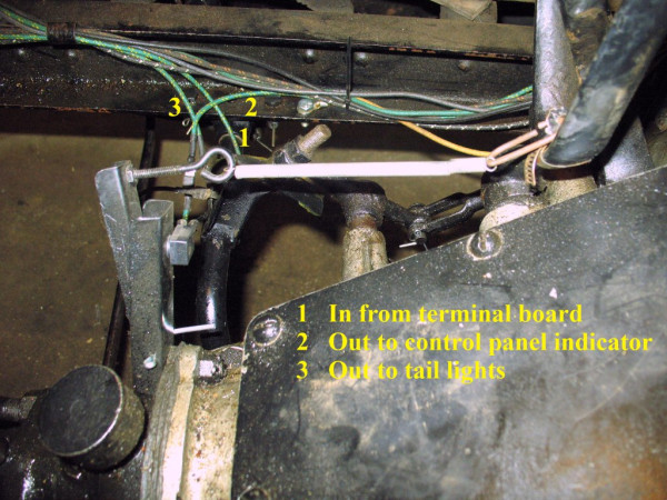

- Posts: 7330
Home made brake light switch. The pushbutton switch and the eye bolt are store bought. The sheet metal scraps, spring, and cotter pin were stuff I had on hand.

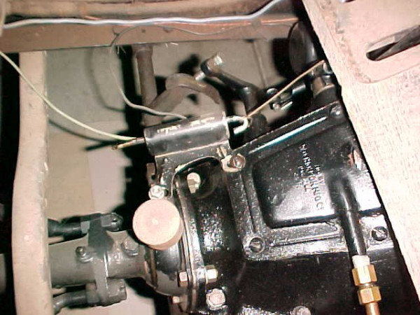

- Posts: 5400
I use the Model A 1928/29 brake light switch. Mounts to lower bolt on the transmission inspection door, use the same thing on my 1920 Dodge mounted to transmission top cover. Saw the setup on someone else car. So far so good.
- Posts: 6340
I am planning to do the same. Saw this picture. so simpleMark Gregush wrote: ↑Wed Mar 08, 2023 9:38 pmI use the Model A 1928/29 brake light switch. Mounts to lower bolt on the transmission inspection door, use the same thing on my 1920 Dodge mounted to transmission top cover. Saw the setup on someone else car. So far so good.
- Posts: 5400
I didn't even use the lower mounting hole on the switch, nor did the one I copied from, just the top hole. If at some point if I do need to add a brace at the bottom, wouldn't be too hard.
