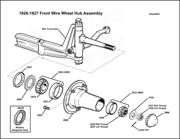

Re: Trouble fitting new lugs in a new hub
I don’t know, but I found a diagram that may help. Jim Patrick
