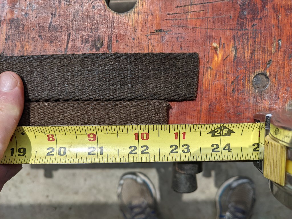

Has anyone tried to use the Scandinavia transmission bands that are to short? I believe the correct length should be 24”. Like others I have a set or two I picked up at Swap meets that are 23 1/4 “ or 23 1/2.
I got these in a lot of other parts and they are the later Scandinavia but not the “tarry” ones.

Originals were 24 and I’m not sure they were cut short. I’m thinking they were cut short to begin with but I’m not sure about that either but what I’ve heard. The originals I have aren’t short and neither are the Wards or Allstate.

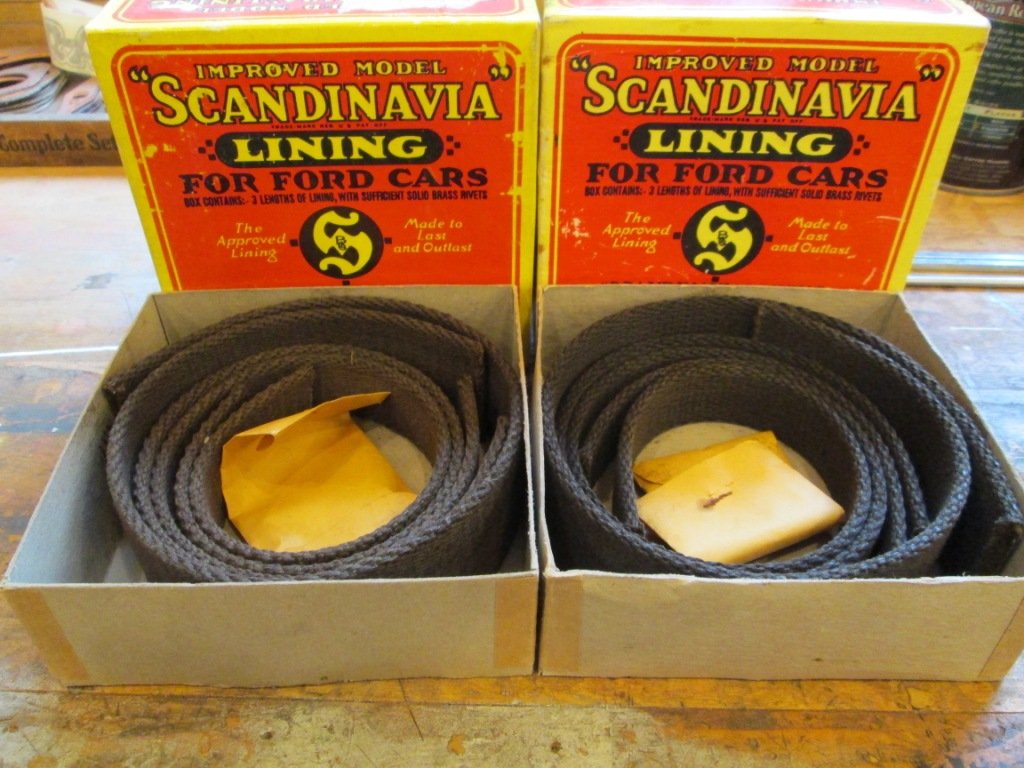

Original Scandinavia linings are 23 & 1/2" in length. Herman K. (RIP) advocated segmented pieces of lining as the CANTEX Corp. shortened their product to 22 & 1/2" later in production prior to the "Tar Babies" being introduced. The bottom photo are CANTEX linings with the same, original weave pattern AND 23 & 1/2" in length.

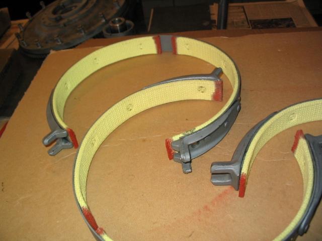

Herm Kohnke was a proponent of cutting a segment out at the bottom of the band material for better contact, cooling & conformity. I’ve tried it with short bands and it works well in fact to me better than full coverage on the band but you will need to coat / soak the cut ends in a spray insulator or glyptal so you don’t get any threads unraveling from those cut ends. Attached is a fantastic thread on transmission rebuilding by Herm and about midway through you’ll see his technique & rational. Others may have a better way to seal the ends, when that discussion was posted some of the bands were not sealed at the ends when bought new. Best John

I have used this method with no known issues on other motors out in the wild.
The shorter scandia band require a pretty wide gap @ the bottom to get good cover under the top ends.
More gap than I would prefer. More gap than pictured here with the kevlar bands.
I think a little stretch rolling coupled with a smaller gap, say 3/8", would be ideal.
