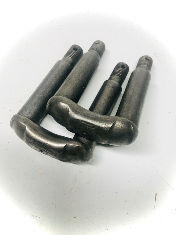

I love getting new to me parTs in the mail
I received these NOS rear spring shackles today. Found on T-bay 70$ to my door. Not bad!

Post by Adam » Fri Jan 13, 2023 11:54 pm
I’ve had a few sets of nos shackles over the years that required an oversize reamer thru the bushings to install. About .010” oversize if I remember correctly.

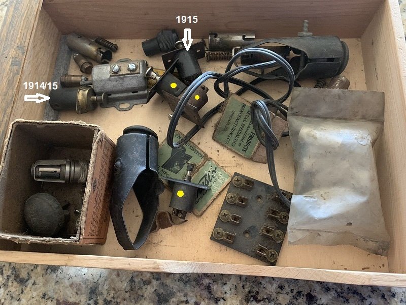

Post by TRDxB2 » Sat Jan 14, 2023 12:45 am
Push/pull switches +
one is 1914/15, a 1915 (longer cylinder than the others, rest, yellow dot, are original not repros. One horn button complete All work!

Post by Bryant » Sat Jan 14, 2023 9:17 am
Thanks for the tip! I will be measuring. Iam wondering if vendors sell bushings for NOS shackles?

Re: Purchased ParTs
Post by Adam » Sat Jan 14, 2023 10:52 am
The vendors won’t have oversize bushings. Measure yours first or try them in a new bushing. The ones I have had that were oversize were definitely “non standard”. I suspect that is how some of them have lasted all these years in unused condition. If yours are oversize, you can get a reamer to ream the new bushings after you install them. If you shop around, a reamer should be around $20 or less online.

Re: Purchased ParTs
Post by Original Smith » Sat Jan 14, 2023 12:07 pm
I like ebay because good NOS parts show up all the time. I would never think of using anything other than a good used or NOS shackle for any of my cars. I also use brass bushings. In the past mild steel bushings were used, but there is no need to do that anymore.

Re: Purchased ParTs
Post by Adam » Sat Jan 14, 2023 2:01 pm
Brass and bronze aren’t the same thing.
I bet you mean bronze.

Re: Purchased ParTs
Post by Bryant » Sat Jan 14, 2023 3:34 pm
I do have some bronze bar stock. Might have to fire up the atlas.

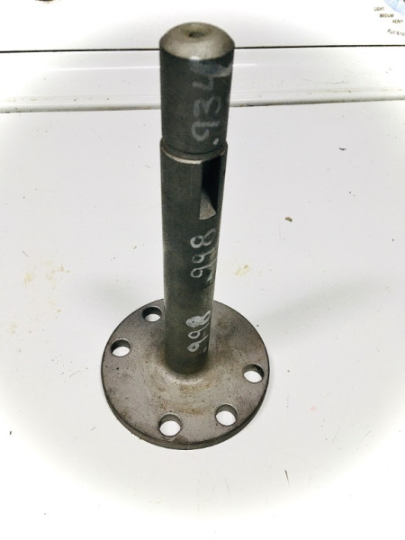

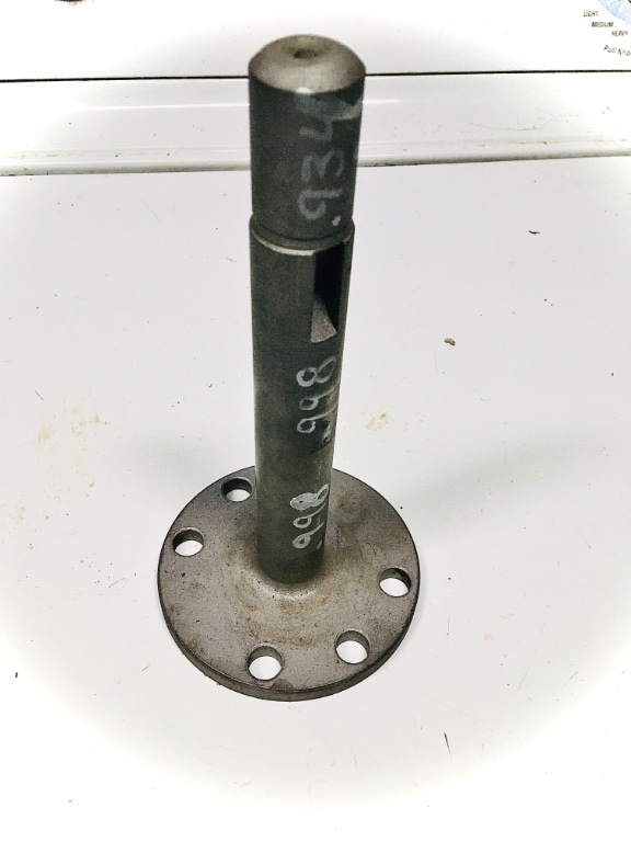

Post by Bryant » Sat Jan 21, 2023 5:38 pm
Mail man brought me a good spec transmission shaft! I like Christmas multiple times each month :lol:

Re: Purchased ParTs
Post by Allan » Sat Jan 21, 2023 7:13 pm
Bronze bushings to suit can be bought off the shelf form suppliers. They are excellent candidates for custom reaming to size.

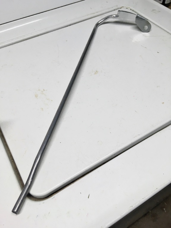

Post by Bryant » Sat Mar 18, 2023 4:15 pm
this fell off the mail truck recently. Large oil funnel tube. Note to self: don’t forget to install before the flywheel
Bryant
Posts: 7299
Re: Purchased ParTs
Post by Allan » Sat Mar 18, 2023 5:36 pm
Bryant add an extra note to self. Check funnel attachment to tube. Bronze joint if it appears compromised/poorly attached.
