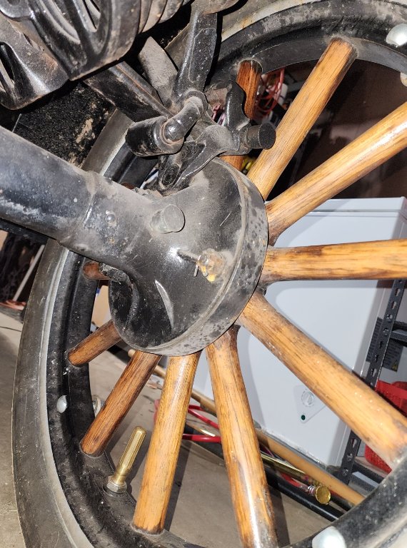

Is this a small rear drum on my 26? If so I jave ordered the wrong size Rocky's

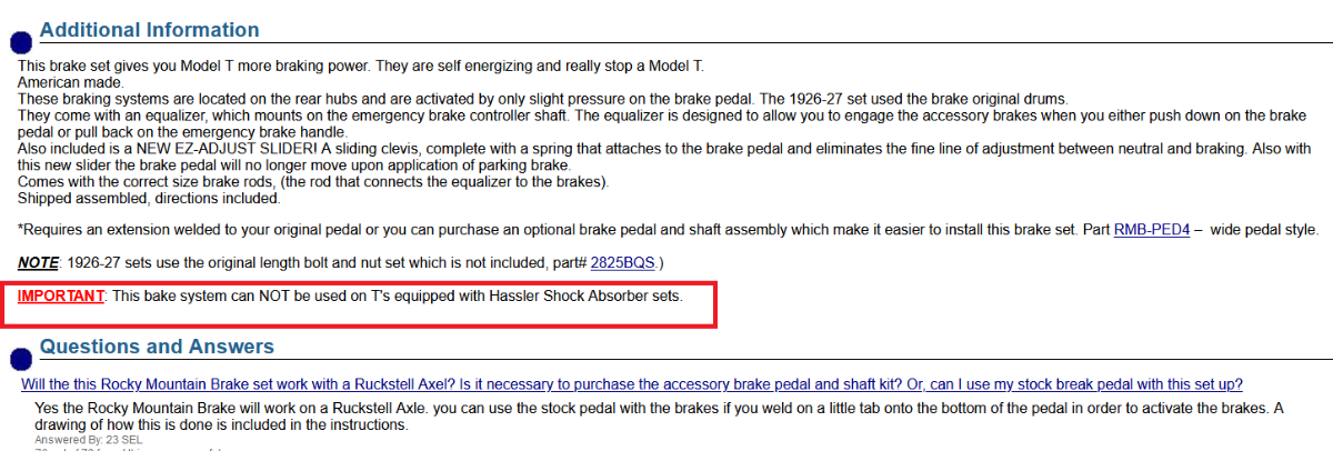

Yes, That's a small drum. Also, I'm not sure if the "Rockys" will fit with the Hassler shocks.

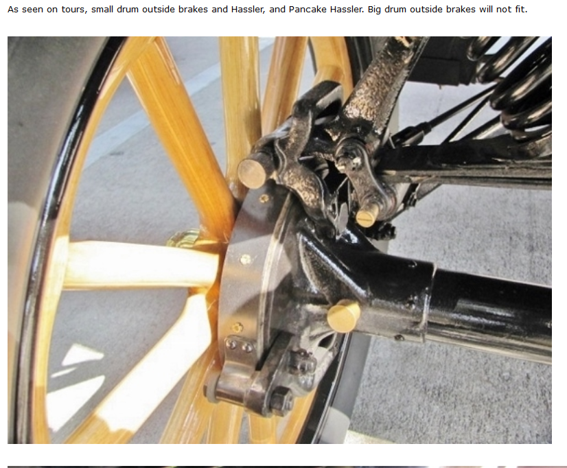

The issue is that the most of the after-market shocks have a perch the extends just over the drum. So no shocks with Sure Stop as well
The product description and instructions both include the this note --
And it looks like the work with original AC brakes https://www.mtfca.com/discus/messages/5 ... 1462493500

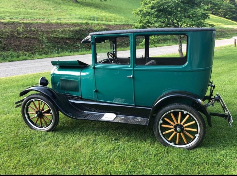

Is the car really a 1926? Mistaken model years are almost as common as Model T's.

That's a small drum rear end. More than likely the car is a 25. Pictures of the fenders, cowl, and windshield post will tell the year.

Yes, it's a '26, but it has the earlier rear axle.

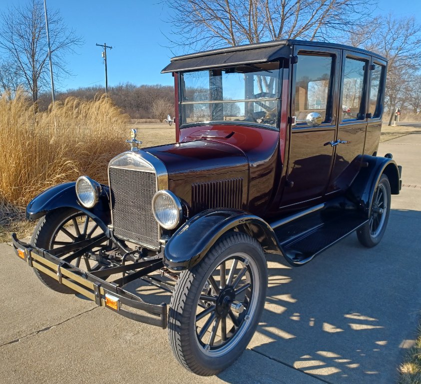

Look @ the cover 26 in the recent "vintage ford" Body is 26 on an earlier chassis & fenders.Jerry VanOoteghem wrote: ↑Fri Apr 07, 2023 8:31 amYes, it's a '26, but it has the earlier rear axle.
- Posts: 4320
Re: Drum size
How is that a '26 body? If it were, the earlier hood would not fit up with the cowl. It would also have a 1 pc. windshield and a different visor. The top of the cowl would have arch to it, instead of straight. The "A" pillar does not continue down to the bottom of the body, ending in a flared bottom, as the 26's do. I see that the photo credit also calls it a '26. Can't see why.speedytinc wrote: ↑Fri Apr 07, 2023 8:52 amLook @ the cover 26 in the recent "vintage ford" Body is 26 on an earlier chassis & fenders.Jerry VanOoteghem wrote: ↑Fri Apr 07, 2023 8:31 amYes, it's a '26, but it has the earlier rear axle.
