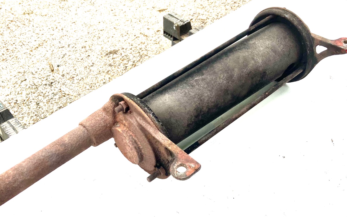

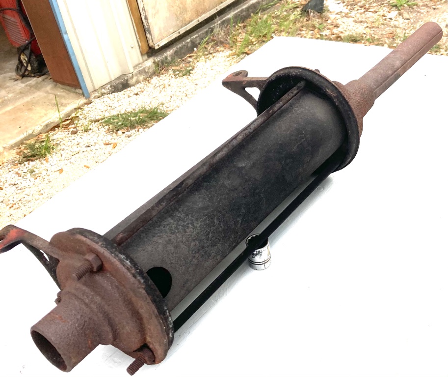

...I’ve recently had the good fortune to acquire most of the correct ‘3 bolt’ muffler for my 1914 runabout. Thankfully, the center and middle ORIGINAL baffles are still in good shape as is the tail pipe. However I had to order the external muffler shell from one of our suppliers. Therein lies my problem: The cast iron muffler diameters are precisely 5 1/8” diameter but the repop muffler shell is only 5” in diameter. Consequently, IT DOESN’t friggin’
FIT !! I’ve very laboriously tried to flare the ends but feel there’s a better way.... Ideas ?

Good advice - all. Thanks ! I was given the correct muffler shell kit for an earlier ‘3 bolt’ muffler and truthfully didn’t know there was a difference in it and the later ‘1 bolt’ kit. So I called the “delivery boy”, Steve Lang, who delivered my parts to Chickasha. He said both of these kits are made by Snyders and there is, indeed, a difference in OD of outer shells. Said the ‘1 bolt’ version is a slightly larger OD. So he committed to send me another outer shell 😁
Lang’s comes through again !!😇
