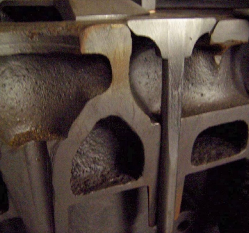

Here is pic of a two-piece valve ground away to show with a cut-a-way engine display. Shows the steel shaft and the cast iron valve head. Likely heat formed together in perhaps an electrical method. Ford did a lot of electrical welding in many processes.

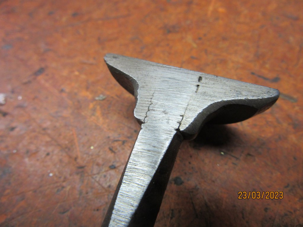

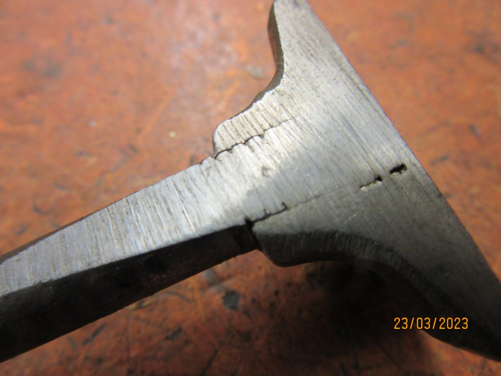

I've cut a valve in half, linished and acid etched it and it looks like the head is poured onto the stem, which has either a thread or series of grooves which deform under the heat of the pour.

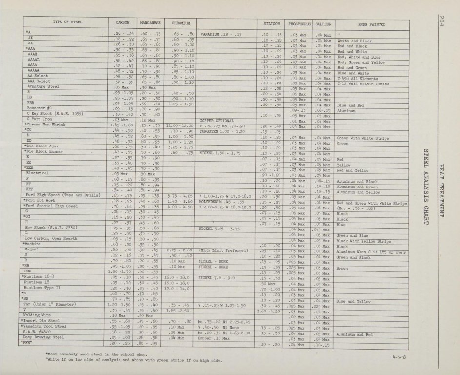

The chart is from Shop Theory - Henry Ford Trade School 1943 edition. This book is on archive.org.
