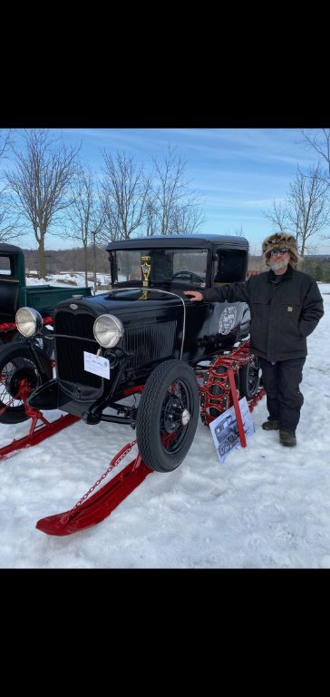

I built this Model A Ford Super Snowbird. My friend Joe Reid is finishing a nice pickup sled too. We agree there are too many chassis modifications to make it practical to take the kit on and off with the change in seasons. T's commonly use a TT rear end to have enough power to twist tracks and pull itself through the snow. These A's are geared down to 8.22 to 1 with 40hp. I have tracks, skis, springs, TT Ruckstell and misc. I plan to build one myself someday. It lengthens the car hobby season taking these Model A's to vintage snowmobile shows and lots of fun too. Our kits are 1930's Arps made in New Holestein, Wisconsin. Good luck!

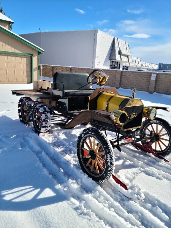

Well this setup was recently found stashed in a Barn in Virginia city Nv and I mated with a TT added the missing pieces I had kicking around
blast to biuld and real kick to drive
So far I get it swapped in a good day and just run the extra wheel

I uses a TT chassis this way to conversion less
Remove tracks and swap spindles
Yes I have front wheels pre mounted on the spindles so make life easier
Rear wheels are stock T fellows with TT hubs and brake drums custom spokes
