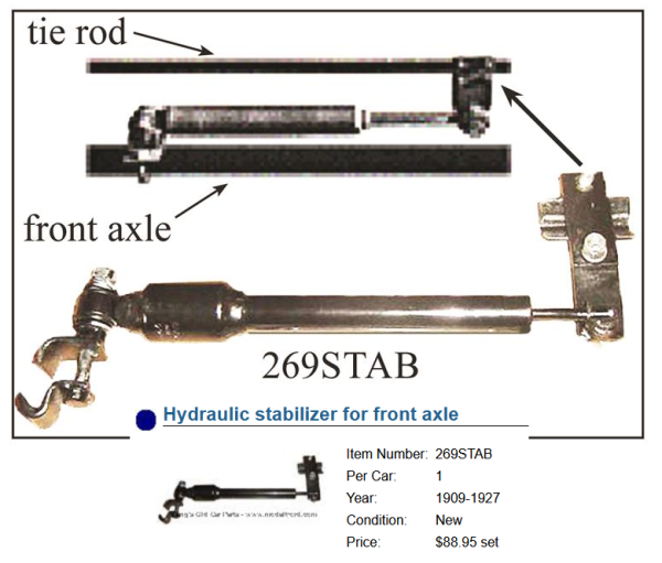

Just wanted to know everyone's thoughts on the Hydraulic stabilizer for front axle. I have one on my 15 Touring (came with it) and the car never seems to get caught in the ruts and I never had an issue with the front wheels tracking. I drove my 24 Coupe with a very tight front end for the first time last weekend and she tracked with the road. The steering is tight so I have a feeling it's because the 24 has no Hydraulic stabilizer.

I am not familiar with the hydraulic stabilizer. Can you post a picture of it?

The tie rod is carefully designed to carry just end loads - tension and compression. And it's a tube.
I would not want that device adding bending loads, with an added risk of fretting or compression at its attachment.
Put it away with any water pumps you may own.

Steering stablizers & anti rattle springs have been around for almost as long as Model T's. The roads of the time maybe more responsable
than worn out parts. The steering stableizer pictured is the style that VW used on thier front ends from 1960 - 1977. The engineers @ VW
seemed to think they were needed. Stableizers are used on many cars & trucks even today to impove drivability. The danger issue seems
to stem from the way they are installed. I have found them miss installed or possibly moved from the original installation so that it limited
travel in one direction. They may have been installed to aid in backing up a T? Many designs were available. Some times we loose sight of
that biulding a automobile to be as cheap as possible leaves room for many shortfalls. And gave birth to the vast aftermarket & accessory
industry we enjoy today. As much as we would love to think so our beloved Model T's are not perfect.

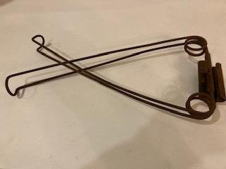

This is an example of a early steering stablizer/dampener that is very simple using friction to control steering, it also increases friction
as the steering increases.

I always wondered why folks added one of those stabilizer shocks. An in spec steering system doesnt need one, even @ speeds over 60.
I had no idea it could put @ risk all the people in the car until this thread.
An accessory added to aid in the comfort & stability is a good thing if it works.
An accessory that has Even a small chance of killing you should be avoided.

Adding period-type stabilizer spring gadgets or a hydraulic stabilizer won't do anything to correct worn or bent parts, misalignment, bad tires/wheels, etc., and it won't add to the car's driveability, and may detract from it.

I had my 15 Touring on my rack so I took a look at the stabilizer. I unbolted in and inspected the thing. It has the force of a screen door return so If someone broke a tie rod it was not because of the force from a stabilizer. The tensile strength of low carbon steel is 131,984 pounds per square inch so I highly doubt the stabilizer is capable of braking a tie rod that is not already rusted out.

It's the added weight of the stabilizer creating vibration and metal fatigue at the clamping point. The broken tie rod I saw was not rusted. The fracture was square and appeared brittle, just immediately adjacent to the stabilizer clamp. However, do as you wish...Model T Ron wrote: ↑Sat Apr 01, 2023 5:12 pmI had my 15 Touring on my rack so I took a look at the stabilizer. I unbolted in and inspected the thing. It has the force of a screen door return so If someone broke a tie rod it was not because of the force from a stabilizer. The tensile strength of low carbon steel is 131,984 pounds per square inch so I highly doubt the stabilizer is capable of braking a tie rod that is not already rusted out.

The way hydraulic dampers (shocks, steering stabilizers, etc) work is by forcing oil through a small orifice. If you move the piston rod slowly, there is little resistance. If you try to move it faster, there is more resistance. If you try to move it very fast, there is a very high resistance. If you hit a bump hard in a Model T with a hydraulic stabilizer on the tie rod, the damping force developed is quite capable of bending or breaking the tie rod, or breaking or dislodging the attachment hardware.

I would suggest that perhaps your stabilizer is not displaying the same force as others and I think that to assume yours is equivalent to all others based on a sample of 1 might not be the best choice. In any event, no matter the strength analysis, empirical data shows that a small portion of these things have failed, slipped, bound up, or have broken tie rods. In my opinion, it is a solution in search of a problem (that doesn't exist) and if you feel that in your opinion and analysis the risk is worth the reward, then that's pretty much it.
Enough of us have (some personally) seen hobbyists killed when some sort of critical path failure occurred with an accessory, so we are perhaps a little more leery/skeptical of something that has the potential to kill you.
In all seriousness and concern for you and passengers, I am not in any way trying to demean you or your thought-processes...simply trying in good faith to sufficiently warn you of the potential of a serious event. Beyond that it is none of my business how you or anyone else equips or maintains their car...just that there have been some horrendous accidents in the hobby and many of them were preventable had the information regarding the risk had been known ahead of time.
I am one who has personally seen a damper which had broken a tie rod and had been welded up once. It was on a car which broke down on a cross-country trip and I replaced a rod for the fellow to put him back on his way. I warned him about his repaired tie rod and suggested it's replacement, along with removal of the damper...at the very least, remove that damper and stop the flexing of the tie-rod. He turned me down on both counts. Three days later it broke the tie-rod (again) with exciting results. It is documented in his book written about his adventure. For me, it is not a theoretical issue.
wishing you safety and health in the hobby

Re: Hydraulic stabilizer on front axle
I am not discounting what has been said but the one on my 15 may be warn out. For my sample size of 1 I can make the argument that is does little good or bad to the car
- Posts: 6731
FWIW - your tensile numbers looked way off and in fact after checking, are at least 2X too high for low carbon steel (your material call out, not FORD's)
I don't know the specific alloy of the tie rod, but it is a hollow tube, not solid, and can be bent/damaged pretty easily if acted upon in any direction other than linear stress or compression. Given the very tiny number that is the actual sq/in area cross section of the tube, it is not hard to see why it is easily damaged by a twisting or bending moment.
This would have been a much shorter thread if you had simply said "I have a stabilizer that I plan to leave on my car", rather than ask what folks think and then tell them all that you disagree. It's your prerogative, but I fail to see the point of the original question since that's the case.
Wisdom gained through experience on a given subject will never prevail over a strong predisposed opinion based on hope or faulty data, so to remain cordial in the face of my and everyone else advice being summarily dismissed, this is pretty much the extent of my input. And again, wish you safe travels and plenty of fun.
[/quote]
Thanks Jerry. The stabilizer came on my 15 when I got it and I did not realize how they worked as the pressure when moving it by hand was about the same as a screen door return. From what people are saying on hear with first hand experience with failures like the one you seen I am going to remove it.
[/quote]
- Posts: 4408
Thanks Jerry. The stabilizer came on my 15 when I got it and I did not realize how they worked as the pressure when moving it by hand was about the same as a screen door return. From what people are saying on hear with first hand experience with failures like the one you seen I am going to remove it.Model T Ron wrote: ↑Sat Apr 01, 2023 9:55 pmIt's the added weight of the stabilizer creating vibration and metal fatigue at the clamping point. The broken tie rod I saw was not rusted. The fracture was square and appeared brittle, just immediately adjacent to the stabilizer clamp. However, do as you wish...
[/quote]
Happy to read this Ron. Enjoy your T!
