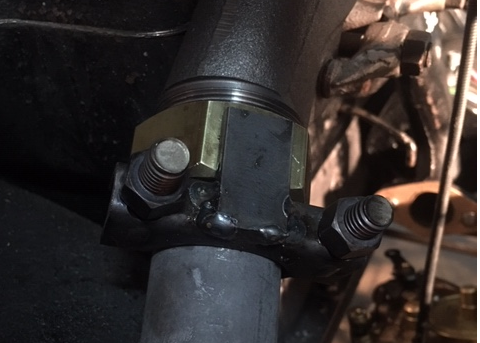

It is 3061L Exhaust pack nut locking clamp, not 306IL Exhaust pack nut locking clamp. oops
Paboot
- Posts: 9
- Joined: Fri Jan 11, 2019 12:52 pm
- First Name: Paul
- Last Name: Bourgeois
- Location: Aldergrove B.C. Canada
- Board Member Since: 2006
Re: Muffler pack nut loose
Bob,I found this.
PaulB
PaulB
- Attachments
- D60F3356-D185-43A0-BE52-94384D056E7B.png (90.71 KiB) Viewed 9981 times
You will get nowhere unless you have a pack nut wrench. All these hose clamps and other stuff is pure junk! Even with a pack nut wrench you have to wiggle the exhaust pipe while you are tightening the pack nut to get it to seat to the manifold.

I think he was referring to the picture I posted.
Sorry, didn’t know I was causing such angst in the
model T restoration world.
And NO I don’t have a lot experience with T’s, but have worked on cars for over 50 years.
Just trying to help.
PaulB
