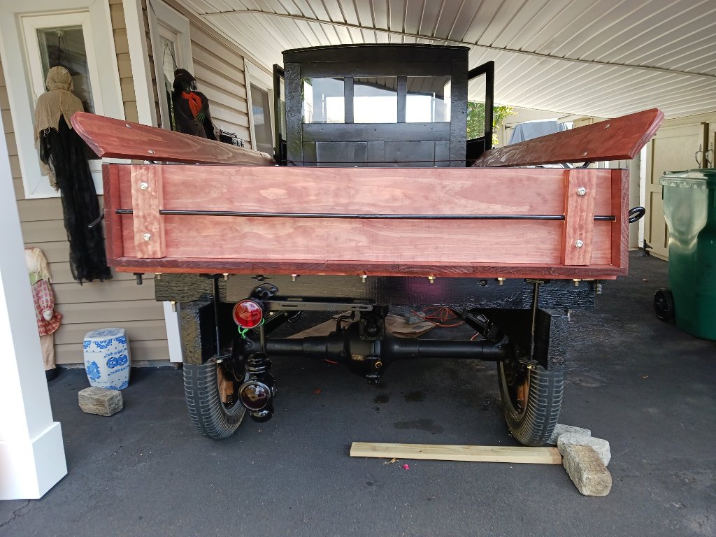

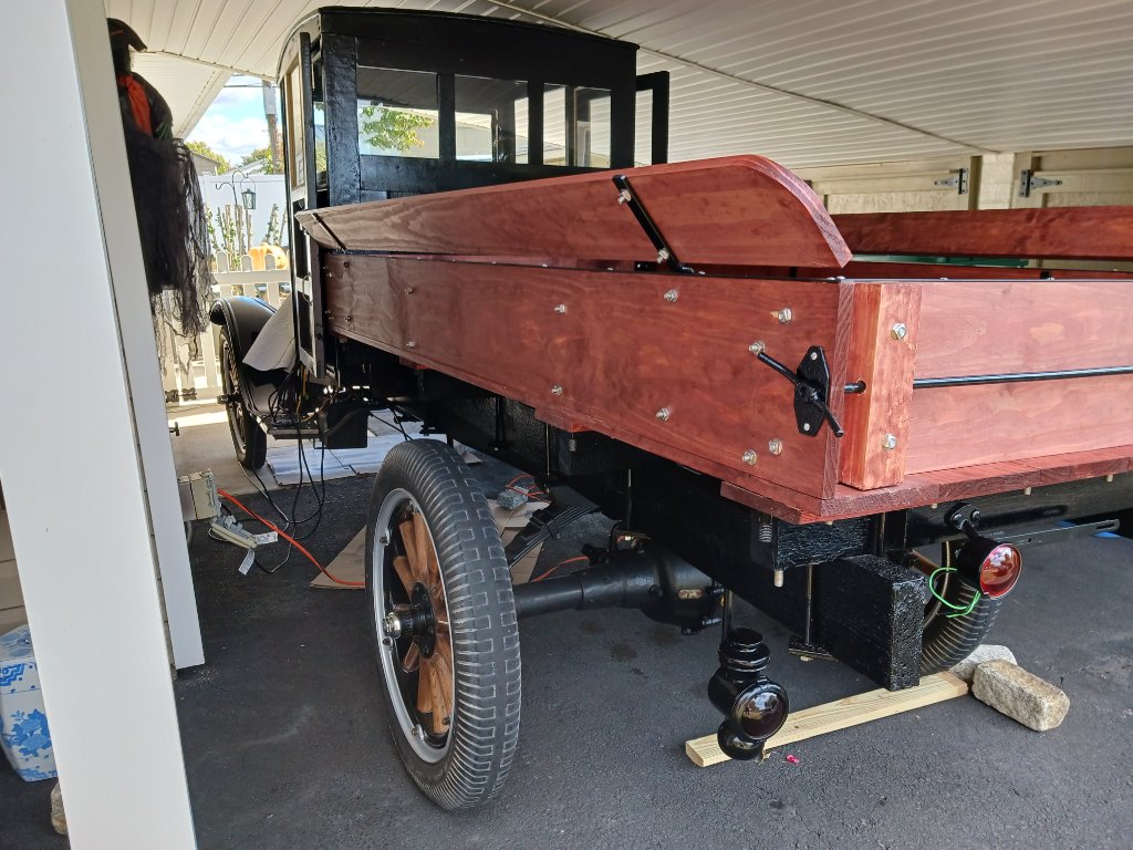

Just able to squeeze this guy under my carport.

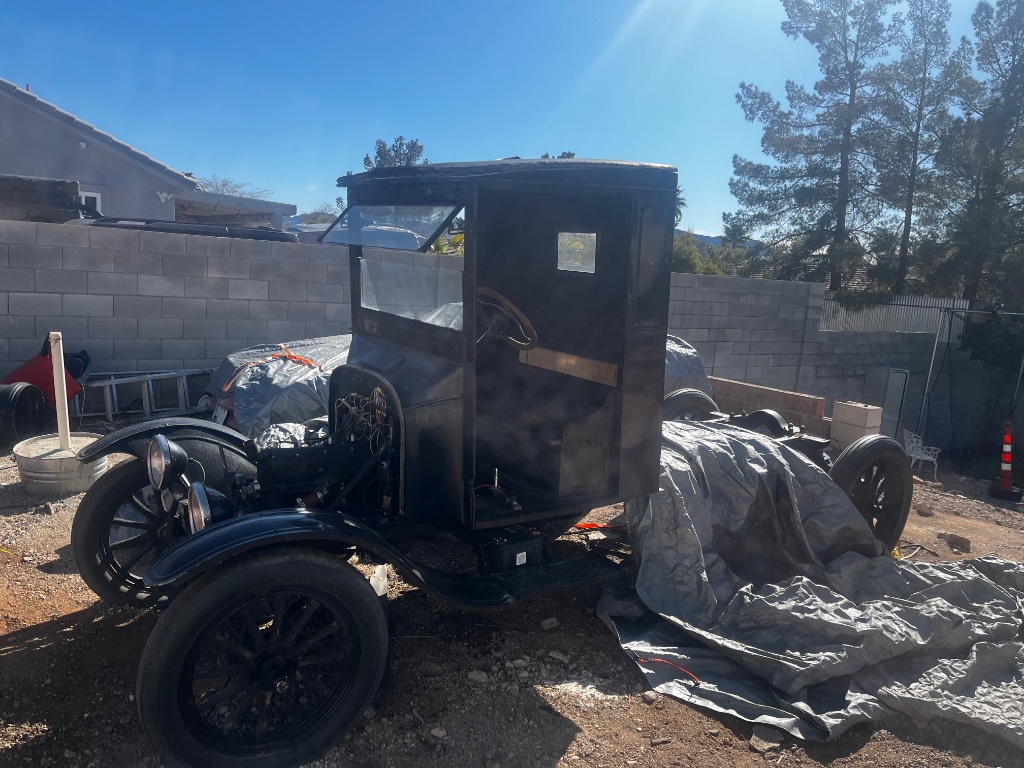

My ‘24 TT is just above 7 feet tall. Probably 7 foot 1 inch. Mine is a standard cab, not a c cab. They are pretty darn tall. :lol:
