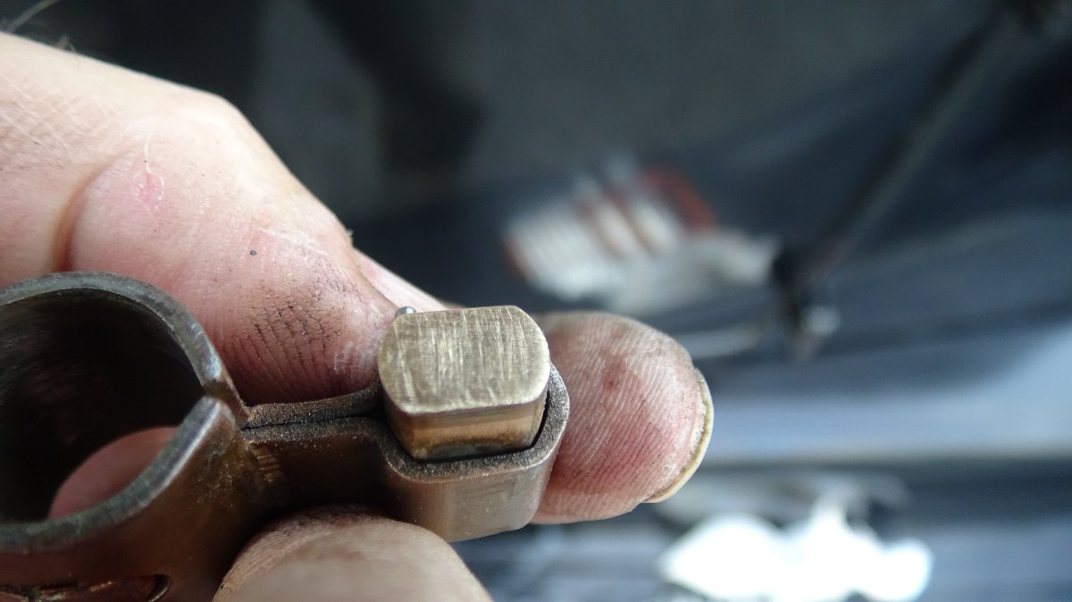

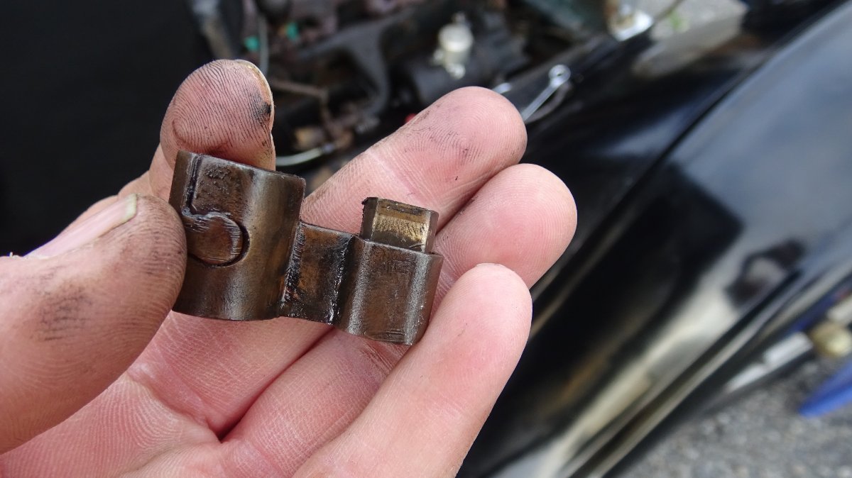

I pulled the cap off the timer today, and I'll be ordering a loom. One of the connectors was holding on by about 2 strands, and of course it's not holding by any now. I am completely new to timers, I have no idea if this one is grooved to the point of needing replaced, or if this is typical for the New Day. What are your thoughts from anyone with experience with this make?
Thanks, Keith

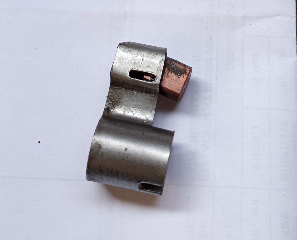

Keith Daniels wrote:
Sun Apr 09, 2023 7:50 pm
Thanks aDave, that was a good thread. I'm sure I have plenty of room to face the inside of the cap!
If your brush looks like this one plan on resurfacing it OFTEN. This was on my Fordor for a mere 500 miles til I got so fed up resurfacing the timer I found a TW timer that someone had that didn't want or need. That solved all my problems. The guys that swear by the New Day timer most likely have the good type of brush. I swore AT mine til I got rid of it!

Post by Keith Daniels » Sun Apr 09, 2023 10:04 pm
TWrenn wrote:
Sun Apr 09, 2023 9:40 pm
By looking like that do you mean the silver body? That was mentioned in the linked thread as being a similar to New Day but not made by them. Or do you just mean the brush itself doesn't stay in place, like the one pictured?
Basically both Keith, no doubt this is a repop of the N.D. brush holder and the brush itself. I'm only assuming it's made by the same people that have been "repopping" the timer itself. As we all know, a while back there was the infamous "S" version, which ironically most of us dubbed it standing for "S--t"!! :lol: I was at a friends house last week looking at a big stash of old, mostly original timers, both roller and a N.D., and his brush holder (rotor) and brush were clearly original and as "solid" as could be. These repop brushes and holers are just plain junk.

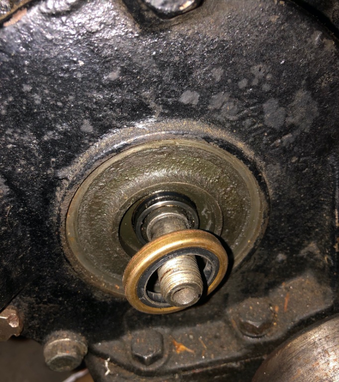

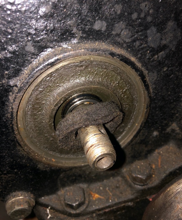

Post by DanTreace » Tue Apr 11, 2023 8:03 am
Mon Apr 10, 2023 9:07 pm
I assume the dished aluminum plate is meant to deflect oil that leaks from the seal on the cam shaft? The center hole is a little chewed up.
Yes, the plate is std. Ford to help seal the felt washer, for the Ford roller timer , but be sure to use it with your New Day ‘forward facing’ brush. Without the plate that brush can dig into the felt seal and create a lot of fuzz and cause mis fires.
I will check it again when I put the new loom on. There was an oil coating inside the timer, as you can tell by the picture of the rotor. It's hard to see the seal but I think it was a modern seal instead of felt. Apparently the plate was in upside down then, the recessed center was out, to help seal the felt I would think it would need to be in toward the block, correct? Thanks.
Posts: 4057
Re: Timer
Post by DanTreace » Tue Apr 11, 2023 8:52 am
[/quote]
[/quote]
Check close if a new metal face modern seal is there.
If so, you can discard the metal shield, it is only for use if a felt seal is in the front plate cam recess.
Shield in place for a felt seal under it.
Felt seal
Modern seal, no shield is needed!
Modern seal tapped in place with silicone sealer, and smear over the seal to help prevent any oil seepage, the modern seal metal collar fits sometimes a bit loose, so use a good oil proof sealer to assist in 'oil free zone' for your New Day timer!

I replace the copper or brass brushes with a soft carbon brush from a generator & remove the sloppy nature.
I have 4+ years running on my most recent brush & it isnt 1/2 worn yet. The body contact interior has ZERO wear. Still smooth as when freshly refurbished. I wipe any dust out once a year.
Can you actually find a brush with a good fit, or just get one a little bigger and cut it down?
Posts: 5170
First Name: john
Last Name: karvaly
Location: orange, ca
Re: Timer
Post by speedytinc » Wed Apr 12, 2023 8:26 am
Cut down a larger brush. T gen brush is a good base size.
Shape with a sanding disk. Cuts like butter. Can use a file. Drill for the spring recess.
Fit just small enough to slide easily in the holder.
