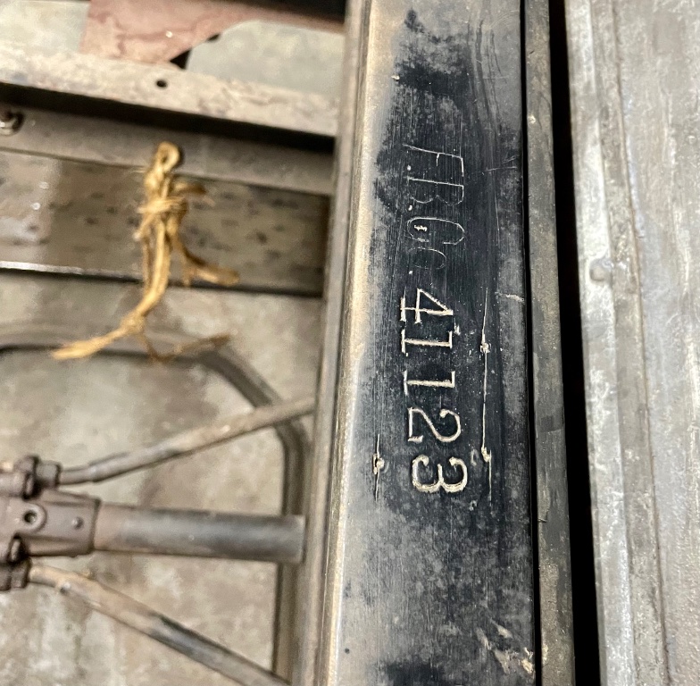

What information can you derive from the body number on a 1912 touring? There is no motor with the car, no data tag and I am not sure if there is a frame number. The body number is plainly visible. It is a Fore-Door slab side Model.
It is stamped:
F.B. Co. 41123
Does that mean Fisher Body Company ?
Thanks!
It is stamped:
F.B. Co. 41123
Thanks!

Here is the sill-
- Posts: 3743
- Last Name: Wrenn
Re: Calling Brass Era experts! Need information on 1912 Touring
I'm pretty sure it is Fisher Body. Looks like a nice car you got going. I see it also has the two-piece driveshaft, often not seen as so many of these earlier cars were retro-fitted with later drivelines/axles. Great find! As for the actual dating of the car, sans any other stampings, it's all gonna depend on the engine number.

I guess there is no correlation between the body number and date of production based on other cars?
- Posts: 3743
- Last Name: Wrenn
I would hazard a guess that is correct. The body makers couldn't probably care less of keeping THEIR numbers "in sync" with Ford's "serial numbers" which as we all know are also the number on the engine block, and were used to "date" the car. Ford quit using body numbers about mid 1915. In Dec. of 1925 motor numbers did start to appear on frames.
