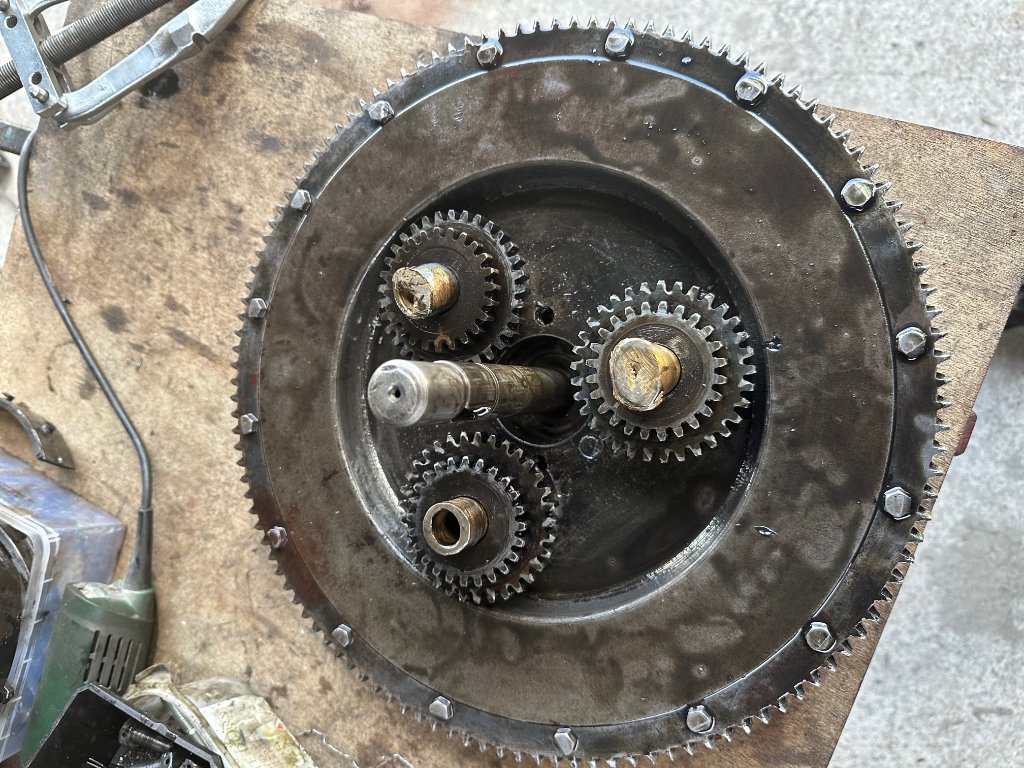

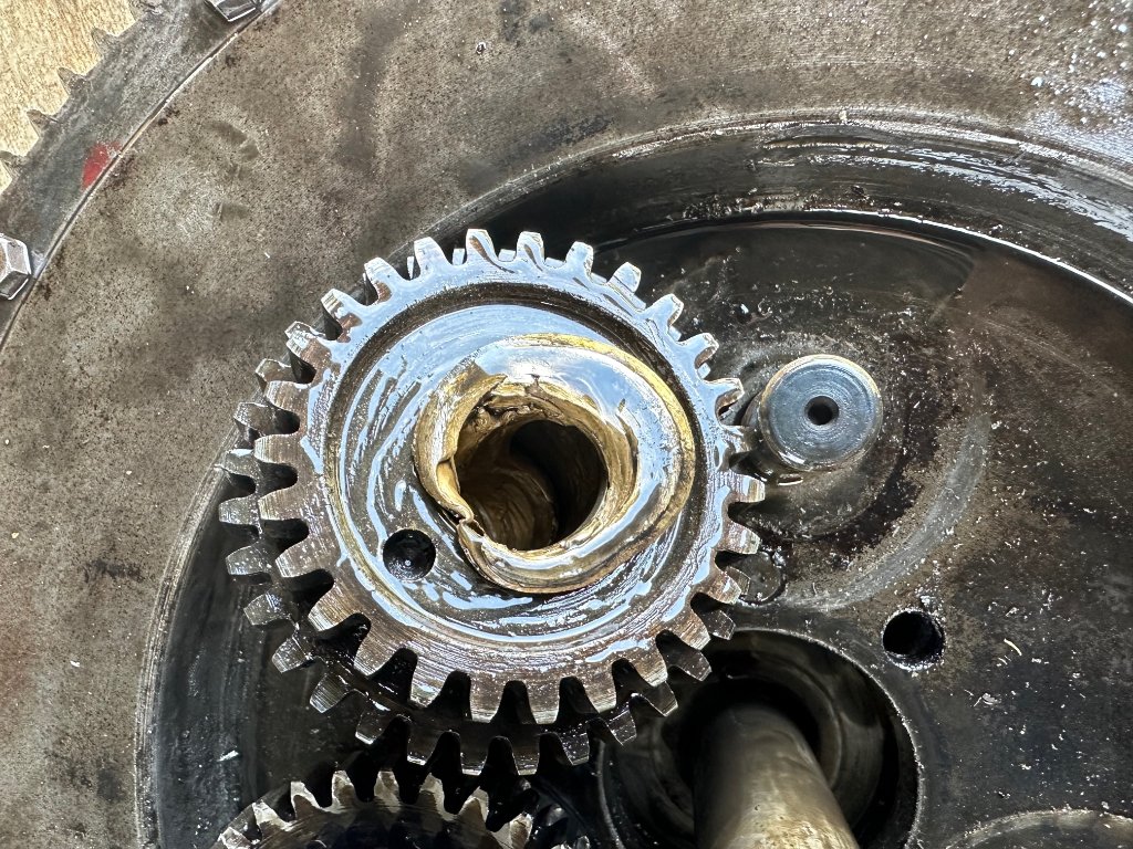

Last week, I overhauled my transmission.
Engine back in place, I started it few times, drove maximum 20 miles but rapidly had difficulties to maneuver in reverse.
Bad sounds, and eventually engine stalling.
I had to dismount again the transmission.
And then, horror show !!! After reading the forum, the adjustment must have been too tight (.002).
But how do you explain the bushing coming out ?
The bushings melted and flowed ?

The bushings were turning in the triple gears is my guess. Maybe the bushings were too tight? Never seen one like that before. There is a tendency to get all the tolerances good and “snug” when we rebuild a T.

Never seen bushings melt. Thats one nasty fail.
Lots of contributing factors. .002 way to tight. I like a .0045 clearance (thats honed or precision bored) Oil cant get in if tight.
No oil slingers. The subject is debatable, But I add slingers if no magnets. Not enough oil in the area to feed the bushings.
Other factors.
Did you chamfer the bushing bores & clear the oil groves after machining the base for proper clearance? Can limit lubrication.
Did you assemble with grease? That can prevent oiling until the grease washes out.
Other factors.

I did add oil slingers (on the other side).speedytinc wrote: ↑Fri Apr 21, 2023 4:48 pmNever seen bushings melt. Thats one nasty fail.
Other factors.
No chamfer
I assemble with oil ....BUT I had another problem with the differential. It was assembled with grease, and one gear seized on the spider. Certainly what you said.

Re: Triple gear bushings melted ???
Sorry, slingers arent visible in the pictures.
Bushing clearance would appear to be the primary issue.
Do chamfer & clean the oil groves well on the next set also.

I’d suggest that you revisit where you got the bushings? My hunch is that what you show is someone’s homemade mix? You see…the tin apparently melted…yet what stayed behind was bright yellow??? ( which also might suggest ‘other’ brass as the remaining copper should have a pink cast to it.) Smelting bronze is not for the feint of heart and not like baking a cake. It is not just piling up on shavings of the individual components and tossing all in a super hot furnace. There is a trick as when and how to add the ingredients…and also a finite time in seconds to kill the smelt.
Tin alone will melt at about 230C. Copper will melt at about 1100C. The alloy ‘might not’ melt out until close to the highest temp component. I suspect you had clumps of tin and veins of tin in your bushes??? (Not supposed to be)
As to the 002…sorry you never got the notice! That is way too tight and the life of the rebuild is measured in minutes and hours when set that close. As others point out, 0035 has been deemed to be about the minimum that works even for someone skilled with the tools.
IF what melted out was tin…that happens about 230C (450F) so is plausible if there was no place for oil to go. But it would have to be free tin and not tin atomically locked to copper as alloy.

When I look at that, I do not see bronze; I see something else but don't know what it is, that's for sure. It didn't melt so much as it flowed under heat and pressure. You're looking at 1900F to melt bronze, and you cannot convince me that those parts got that hot - in fact, I'd say it was impossible.
Try to imagine a scenario where metal is 1900F and the oil remains liquid and does not flash into combustion leaving black sooty char everywhere...things sure got hot, but not 1900F hot...what a mess!

I'm going to say it is likely two issues. Bushing clearance was set to tight AND tripple gears were not properly aligned with the drum gears when reinstalled. The slight binding of the gears put a substantial strain on the bushings which caused the gross deformation under low speed engagement.

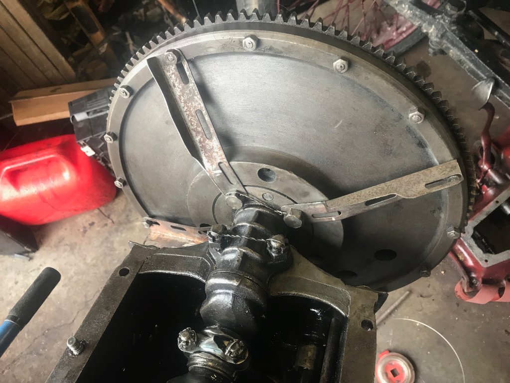

Another area of concern are the bolts used to hold the starter ring gear. I'm sure the bendix gear collar took a beating by those bolt heads protruding from the rear surface of the flywheel. Not the case when the stock brass screws are utilized.

Fully agree. But how the bushings became what they are ? The answer must be "flow under pressure". There was no smell of hot oil, or hot material.Scott_Conger wrote: ↑Fri Apr 21, 2023 8:48 pmWhen I look at that, I do not see bronze; I see something else but don't know what it is, that's for sure. It didn't melt so much as it flowed under heat and pressure. You're looking at 1900F to melt bronze, and you cannot convince me that those parts got that hot - in fact, I'd say it was impossible.

The shoulders have not been twisted off (you see it on the first picture). And the bushing did not walk up off the pins and out of the triple gears.
It just flowed !!

I have never seen a starter gear bolted on like that, what else do I not know?? I'm thinking that was a dumb question you can fill a 55 Gal.
drum with what I don't know about model T's.

From an examination of the photos posted, I’m concluding this is a likely scenario:
The pins were pressed too far thru the flywheel.
The flanges grabbed and galled at the area of the pin that was too wide.
The bushings then spun in the gears and the flanges broke off.
What looks like “melted ends” sticking out of the gears is where the ends of the bushings bent & smeared when they worked far enough out to contact the reverse drum.
It is quite likely that the first three things happened and there was nothing noticeably wrong until the spun bushings worked far enough back to hit the reverse drum.
Another thing I noticed is that it looks like your flywheel may be an earlier non-starter flywheel that was machined to accept a ring gear. If there is a combination of early and late parts in this trans, perhaps there are also potential issues with incorrect combinations of disc-drum, brake drum, and clutch plate spacers you are contending with as well.

The drums were spining freely when installed. As I said, I put them very easily, so I assume they were correctly timed.John kuehn wrote: ↑Sat Apr 22, 2023 4:06 pmHow can you put on the triple gears out of time unless you force them on. And if you did I don’t think you could spin the drums easily. They should spin freely without the drum and plates installed. That’s always the test for me.

I have added some sort of slingers when rebuilding the transmission. What is a good idea ?

Okay... It doesn’t mean the last guy that replaced triple gear pins did it right. Look at the picture…
Unless the picture is showing a really exaggerated view of what is actually there, that pin is pressed too far thru the flywheel and there is a definite shoulder exposed to the bushing…
Also, by the surface finish on the end of that triple gear pin, it isn’t a FORD pin. There was a small run of Substandard TG pins that were an issue a couple years ago, as well as a larger issue about 30 years ago.
AND, it’s a non-standard, aftermarket, specialty flywheel with no counterbore on the back side to help the average mechanic properly set pin depths…

I would not trust those oil slingers not to fatigue and break in service.
- Posts: 4454
Pat is correct, those slingers are way too light.

No counterbore on the backside, you mean a way to press the pin flush ?Adam wrote: ↑Sat Apr 22, 2023 10:30 pmUnless the picture is showing a really exaggerated view of what is actually there, that pin is pressed too far thru the flywheel and there is a definite shoulder exposed to the bushing…
You idea is that the diameter of 0.681" which is pressed in the flywheels is exposed to the bushing. I don't think so, but I will check the diameter/length of the pin when I will take them off. They have certainly not been replaced a couple years ago. But 30 years ago, who knows ???
They look quite robust as they are still in place after this mess. I would really think if something was poor quality, it was the bushing.
The flanges of the bushings did not brake. That's why I said the bushings flew. I cannot take them off.
What you see of the picture is the rest of the flange at the back of the TG.

OK, I will change them.....or put a standard flywheel with slingers from the vendors.Jerry VanOoteghem wrote: ↑Sun Apr 23, 2023 7:34 amPat is correct, those slingers are way too light.
- Posts: 5245
The sheet metal slingers offered in the past were prone to failure. Cracks & breaking.
I dont know if the current offering has improved.
Personally, I make my own from 1" X 1/8" 90 degree extruded aluminum T6.

I second the slingers - replace them and get it re-balanced before you go forward. I would probably replace the pins too after that much trauma.

The oil slingers shown are too thin and will break. I have seen a setup like what you show last for about 20 minutes before breaking. Also they are not needed, The teeth on the flywheel ring sear will move lots of oil. I have a Scat crankshaft in my car with no slingers and have run it hard for many miles without any problems.
What is important is getting the proper oil grooves and dippers added to the rod bearings.
