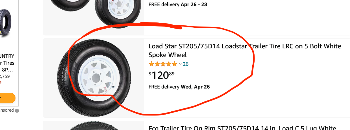

I'm in need of a spare tire and rim for my trailer. Will eventually be replacing all four tires since they're old but in good shape. I'm fairly new to trailering, have attached a screenshot of an offering from Amazon. Price seems reasonable. Any opinion on quality and/or price? Other sources I should be looking at?
Thanks in advance[/size]

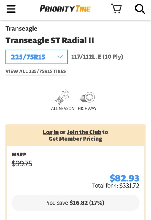

For the best value - I recommend
Discount Tire Company AKA America’s Tire.
They offer road hazard certificates with
tire mounting & balancing purchase.
Free replacement for the life of the tire
with no pro rating for tread wear depth.
For the cheapest tire price - I recommend
@ https://www.prioritytire.com/transeagle ... ailer-tire
FJ
FJ

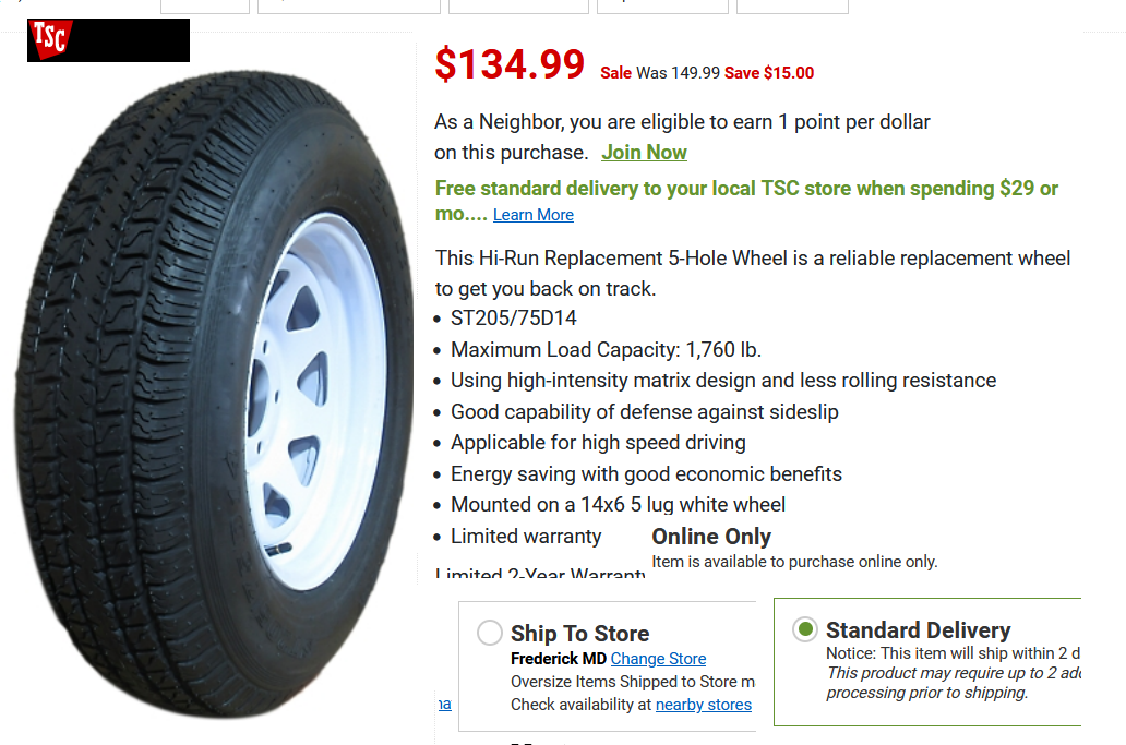

I'm always in favor of buying locally when in reason. Could be same as what your looking at - worth a look anyway
If there is an issue they are there to help. Your Local Tractor supple lists them but need to order on-line and have ship to store https://www.google.com/maps/search/?api ... MD%2021701
Tire wheel link
https://www.tractorsupply.com/tsc/produ ... _vc=-10005
Tire wheel link

Thanks for the replies. I do have a TSC store nearby and they get a lot of my business. From what I remember, when I checked their wheels and tires they didn't have my size in stock. I'll look into ordering online and having it sent there. My trailer is a dovetail style, sixteen-foot, very happy with it. I've hauled my modern car as well as my Model T Touring on it and it does well. Just been putting off buying a spare tire and wheel--preferably two--but I have an upcoming trip that's a little over 100 miles each way and I don't want to end up on the side of the road. Thanks again, Gerrit
FreighTer Jim
- Posts: 1722
- Last Name: Jarzabek
- Location: Dayton, OH
- Board Member Since: 2008
Good source for trailer tires?
I would not advise having an 8 ply or D load range
trailer tire as either a primary trailer
tire or as a spare.
FJ

FreighTer Jim
- Posts: 1722
An 8 ply tire has a lower load capacity.
It is more susceptible to flats.
It does not last as long.
Did you look at my post above with
the link to a 10 ply E load range tire
that you can buy online with free
shipping to your door ?
I have bought 15 and 16 inch trailer
tires from that company with good results.
FJ
