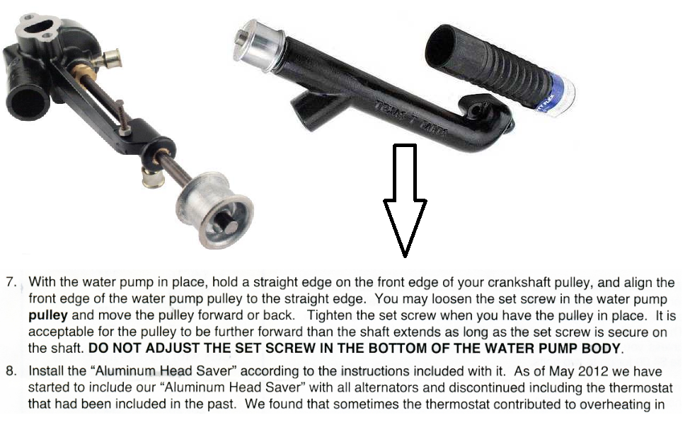

Not sure what water pump you have original or a repro. Out of curiosity do you have the engine pans (splash pans) installed? The thermosiphon circulation occurs when there is a differential in temperature of the coolest water at the bottom of the radiator & the hottest water at the top. When stopped the fan is the only means by which air can be drawn through the radiator. The water pump argument has always been at what pointbdtutton wrote: ↑Mon Apr 24, 2023 10:52 amI can drive my 1914 Touring in 90 degree weather all day long without any issues, but if I stop moving and sit idling in a long line at Burger King the temperature rises so I decided to add a water pump to the car. I have the pump, thermostat, belt and the new gaskets, but there were no instruction included. Yes, I know it is a fairly simple procedure, but had some questions about the alignment and the tension of the belt. It looks like the pulleys are not quite aligned and I was wondering if that is correct or will it throw the belt? Also, how tight does it need to be?
does increasing the flow of the coolant reach the same temperature differential as before without it. Let us know how it works for you in Michigan
This link contains instructions for the Leakless pump but some of these two points seem to apply to any
https://www.snydersantiqueauto.com/cont ... 902-WP.pdf

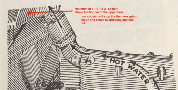

Both the thermosyphon system and a system modified with a pump depend upon a flow of air throught the radiator core to cool the engine.
If the airflow is insufficient to carry off the heat rapidly enough, the engine temperature will rise, with or without a pump.

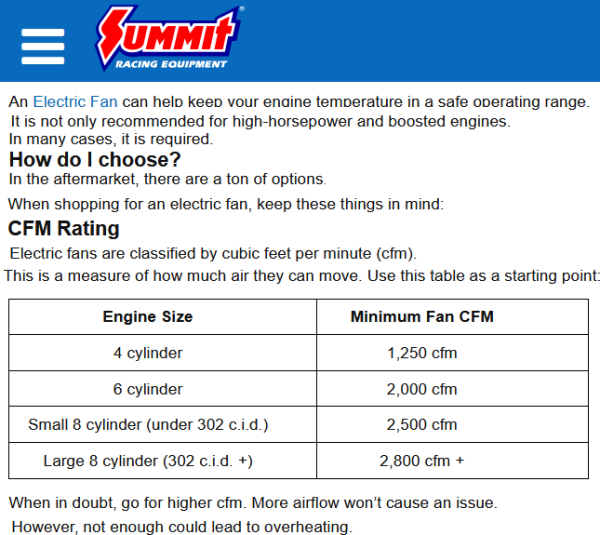

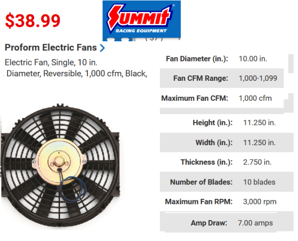

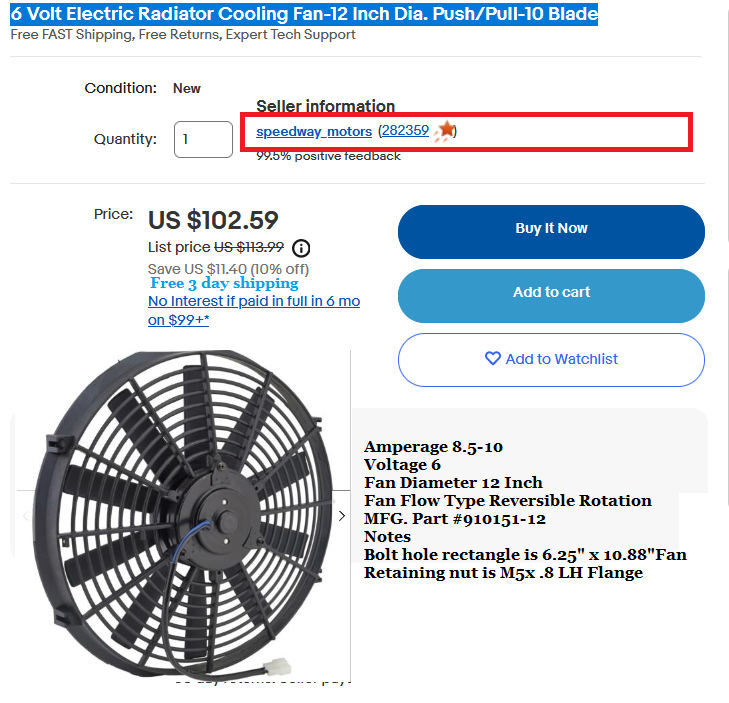

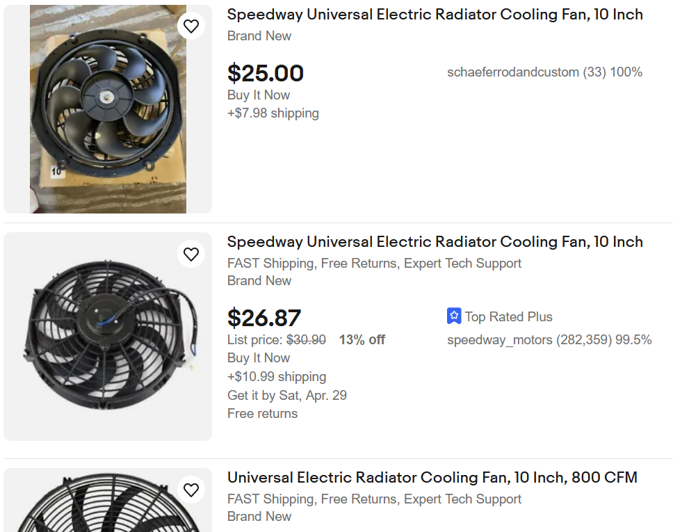

Causing additional airflow through the radiator (small fans?) will be more good than any thing else. DO IT!

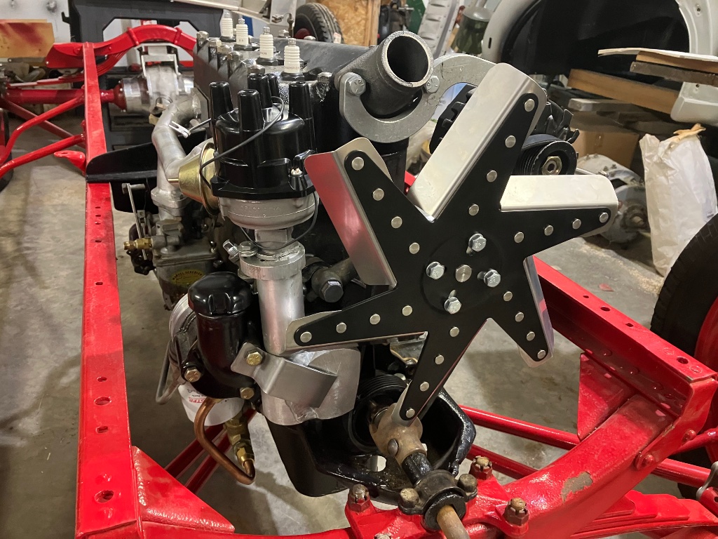

Here is a fan option for parade driving. It is 13” diameter and fits OK behind a brass radiator

Speedway motors has
6 Volt Electric Radiator Cooling Fan-16 Inch Dia. Push/Pull-10 Blade

Just checked one of the 6v fans. 6/7.5 amps. so a fully charged 100 Ah battery with light on totally 13 amps hour run for about 7hrsTXGOAT2 wrote: ↑Tue Apr 25, 2023 8:22 pmThat's a good idea. Whether the fan is 6 or 12 volt, I'd run it off a full-size auxillary battery. Those things pull some serious current, and I wouldn't want one running off my starting battery. I'd want a "puller" fan that would pull air through the radiator and blast it over the engine.

Oops did it from my phone. Speedway has 16, 14 & 12 inch 6 volt radiator fans. They sell some on eBay for less than the store & free shipping but charge for shipping on-line store about $35. Amperage is higher 8.5-10 --Les Schubert wrote: ↑Tue Apr 25, 2023 9:25 pmA 16” fan won’t fit behind a brass radiator in my experience
Speedway also has small 10inch 12volt fans eBay vs Speedway on-line pricing for the same product ?
https://www.ebay.com/sch/i.html?_from=R ... _PrefLoc=1
https://www.speedwaymotors.com/shop/spe ... r%3a235579

There are 2 problems to solve. The power source and enough airflow
Computer fans (6v or 12v) max out at 200CFM. doesn't mater how many you use its still only pulling 200CFM
Not sure iwhy you are set on 6volts you didn't indicate that. If you were to rely on the Model T generator then that's unregulated voltage , unless you have a VR, and could damage a 6V but might work a 12v computer fan. But only 200CFM don't think that's enough
The 12V Speedway Universal Electric Radiator Cooling Fan, 10 Inch is 620CFM . I couldn't see see how many amps it takes
Found this fan at Summit 1,000 CFM ought to do it & at 12V & 7amps.

A matrix of of 100CFM computer fans is no more than each individual one, 100CFM. That's not enough but might be more than a Model T fan at and engine speed of 4 to 5MPH
https://help.summitracing.com/app/answe ... d-i-get%3F
