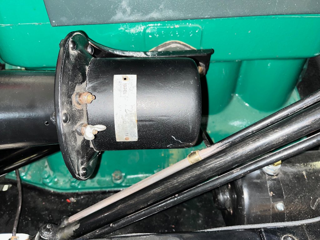

I have installed the horn on my coupe. I know one wire from the horn button goes to the terminal and the other goes to the horn. The horn has two connections. Which connection does the wire go to?

The picture of t he contacts looks like there is some stamping next to them. Is there?

Frank, There is no stamping near the terminals on the horn that would tell which terminal is positive or negative.
After I made this post, I remembered that I had taken a photo of the horn and its wire connections while it was on the coupe prior to restoration. You can see that the terminal with the wing nut was connected to the starter switch and the other terminal was grounded to the frame. Therefore, apparently the wing nut terminal is positive and the other is the negative ground. Sorry about photo orientation!!
During the last year or so as I have been doing the restoration, I have hooked up the horn to a 6v battery several times to show others what the horn sounded like. I don't remember specifically paying any attention to which horn terminal I connected to the battery positive post. In some of these "sound" demos, I may have connected the battery positive post to the the horn terminal without the wing nut. I would think that should have damaged the horn. Why not?? Is it because what Jim said, "The two terminals were likely used to make the horn work on both negative or positive systems"?

Allan, There are two wires on my horn.
Jim, I said the one wire was hooked to the starter switch, I have looked at the photo again, and I think I was wrong. Now I am not sure where the wire from the wing nut terminal was connected!

Bruce, your horn is not a T horn. A T horn has just one wire. Your horn will have an electric motor. A T horn has electro magnetic make and break.

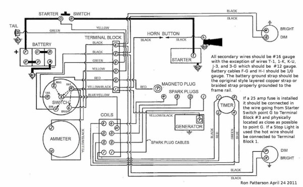

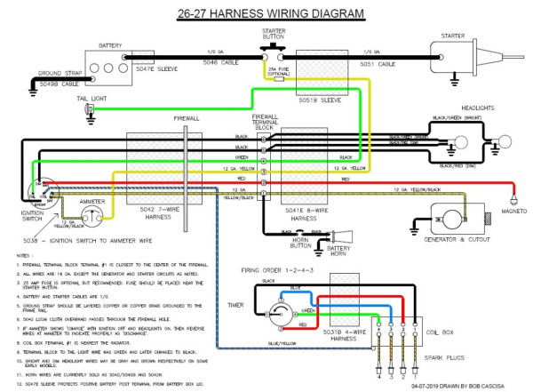

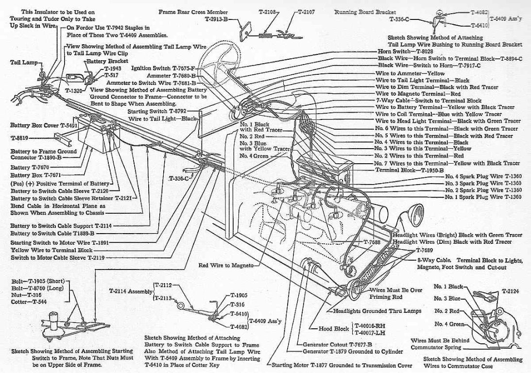

Here is some wiring diagrams

It isn't a rare thing for these cars to have the "wrong" horn. That shouldn't matter as long as it's a six volt battery horn. With a test light, confirm that the horn button works. Attach the button wire to one of the horn terminals. Attach a ground wire to the other terminal. Push the button. Does the horn work? If not, reverse the wires and try it again. Still not working? Then something in the horn needs fixing. That could be something as simple as a motor that needs a little oil.

I will connect one horn button wire to #1 on the terminal block and the other horn button wire to the horn (terminal with the wing nut). I will connect the other terminal on the horn to a ground wire.
Right or wrong?
After studying the information, I have decided to do the following:
Right or wrong?
- Posts: 6553
Re: Horn Wiring
Correct and as noted with 16ga wire.(I corrected my mistake. It was late at night and mistook lower case h for upper case Hin the Ron Paterson's diagram above)
