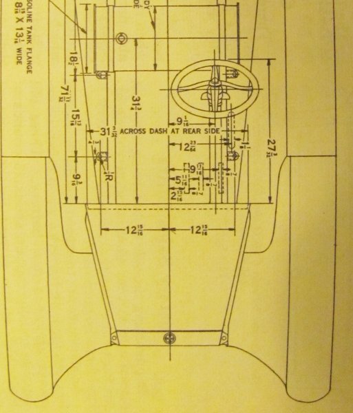

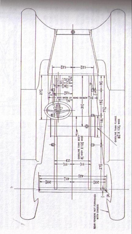

Is there a website with a drawing of a model t floor. I need the location and diameter of the starter switch hole.

What model year ? What body style ?

1927 touring.

https://www.mtfca.com/discus/messages/8 ... 1529376441

Post by Been Here Before » Sun Apr 30, 2023 3:10 pm
OR

George.. that drawing may be reference to a 26-27 four-door sedan or a TT truck since it shows the gas tank under the front seat. He has a 27 touring car.

Thanks for the drawings, but I don’t believe they show the hole for the starter switch.
I’m actually looking for the starter switch hole diameter and location

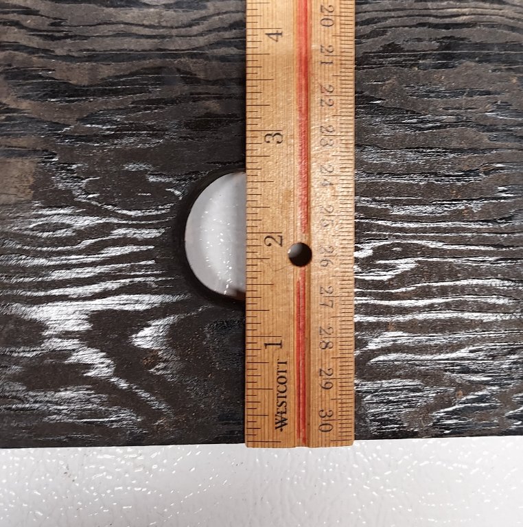

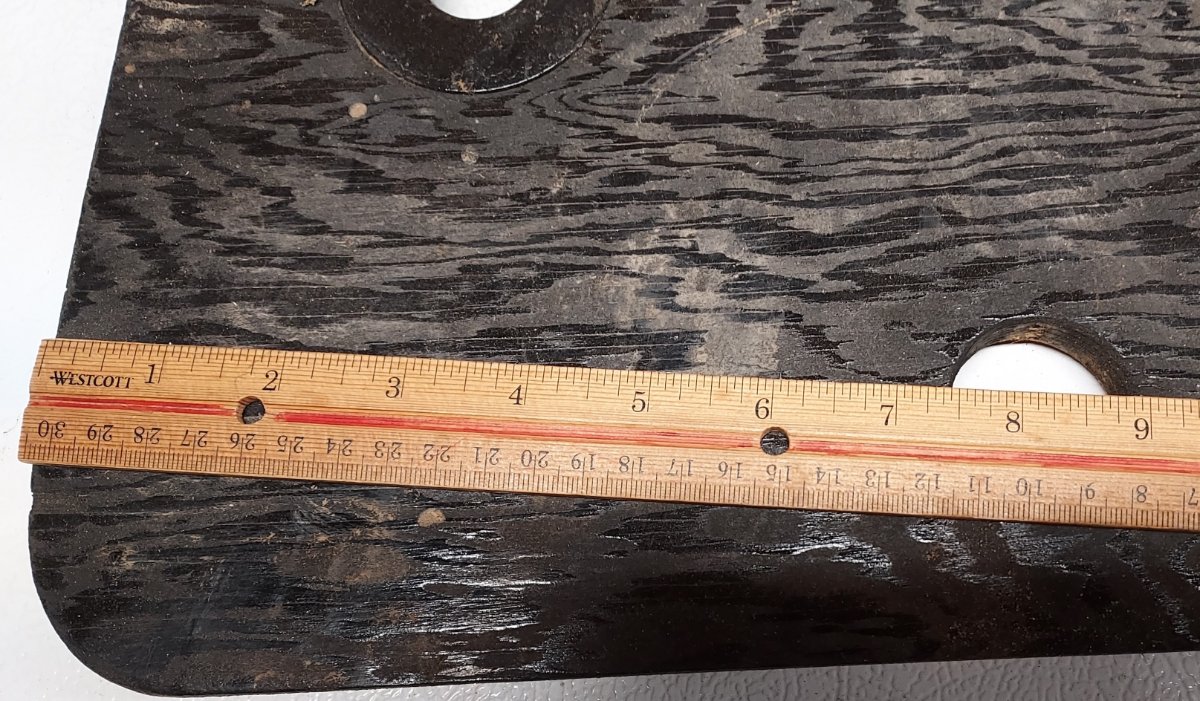

Dont have the drawing. You can get one from the Benson Ford Research Center, its complicated and costs money. If this helps, decades ago my father made new a floorboard using the original as a template, I cannot vouch for its accuracy. The hole is 1 3/8" dia, and all measurements are perpendicular to the edge of the floorboard.

Post by FULLBORE » Mon May 01, 2023 8:08 am
That is exactly what I need.
