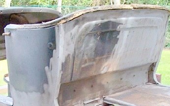

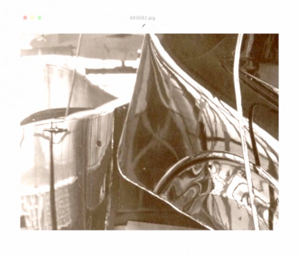

Here are pics, and one close up of a Nov.1925 mfg. runabout pickup. Was told this T was always a pickup, and it does indeed have the missing holes and captive nuts in the rear panels. Therefore this body could not have had a turtleneck installed, and all the decks have mounting holes for this spot.
Note no holes in pillar.
Another body, with holes in pillar, this one is unknown date, but has the early bed with front stake pocket at the body.

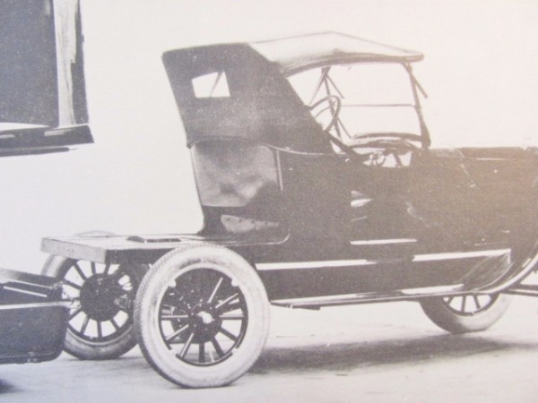

Ford factory photo, maybe prototype of the Improved Car runabout, showing how the pickup bed and deck can be interchanged. This is famous photo of the plain panel.

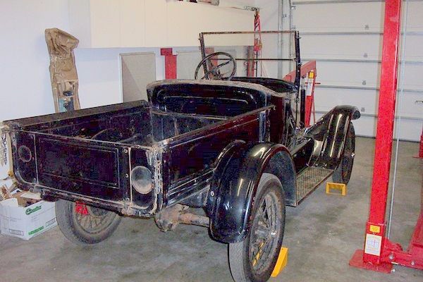

this restored one does have a plain panel....but may be fabricated? Don't know. (photo from the forum)

As far as my knowledge, that 'filler' panel in the US was an added feature when the pickup bed was re-designed to have the front stake pockets moved back 7". The filler plate made the Delivery Unit look complete.
. All the early beds with stake pockets at front edge have no signs of rivet heads that would have retained that filler plate.

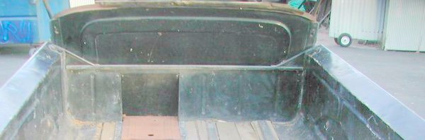

Later bed, front take pocket back, filler plate.
Note the below early bed style '26 with stake pocket up front, and no filler plate. You can see the gap between the body and bed.

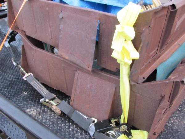

As for the metal deck pan, Richard, I recall on my Nov. 3, 1925 mfg. date (engine 12,635,xxx) the bed wood little carriage bolts were very short length, and since the metal pickup bed rides on channel below the curved lower sides that the bed boards fit to, there wasn't any contact of the square toothed washers or the small square nuts holding those bolts that go through the metal bed strips.
Don't have any photos of the underside, but this is the upper as removing the old wood boards.
As for the mounting holes in the rear of the runabout body, you may be correct. This is the photo of painting a turtle deck of the Improved Car, on the line at the Indianapolis assembly plant. Enlarged the detail at the body and there sure seems to me no mounting holes. This factory photo below is dated Nov 24, 1925. So that should be true, early runabouts were missing the holes, and that was later added as design change, just like many other changes during the Improved Car production. Lots of minor differences in construction. Same with the pickup bed, the early bed, front state pocket up at the body, later beds, front stake moved back.

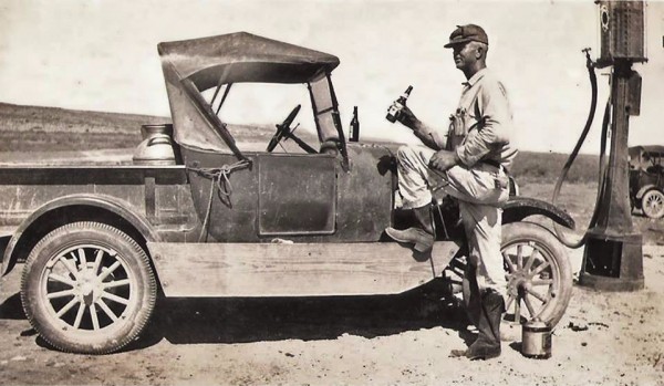

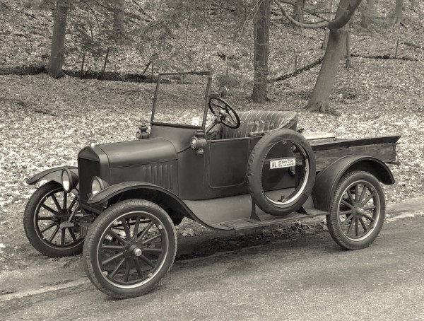

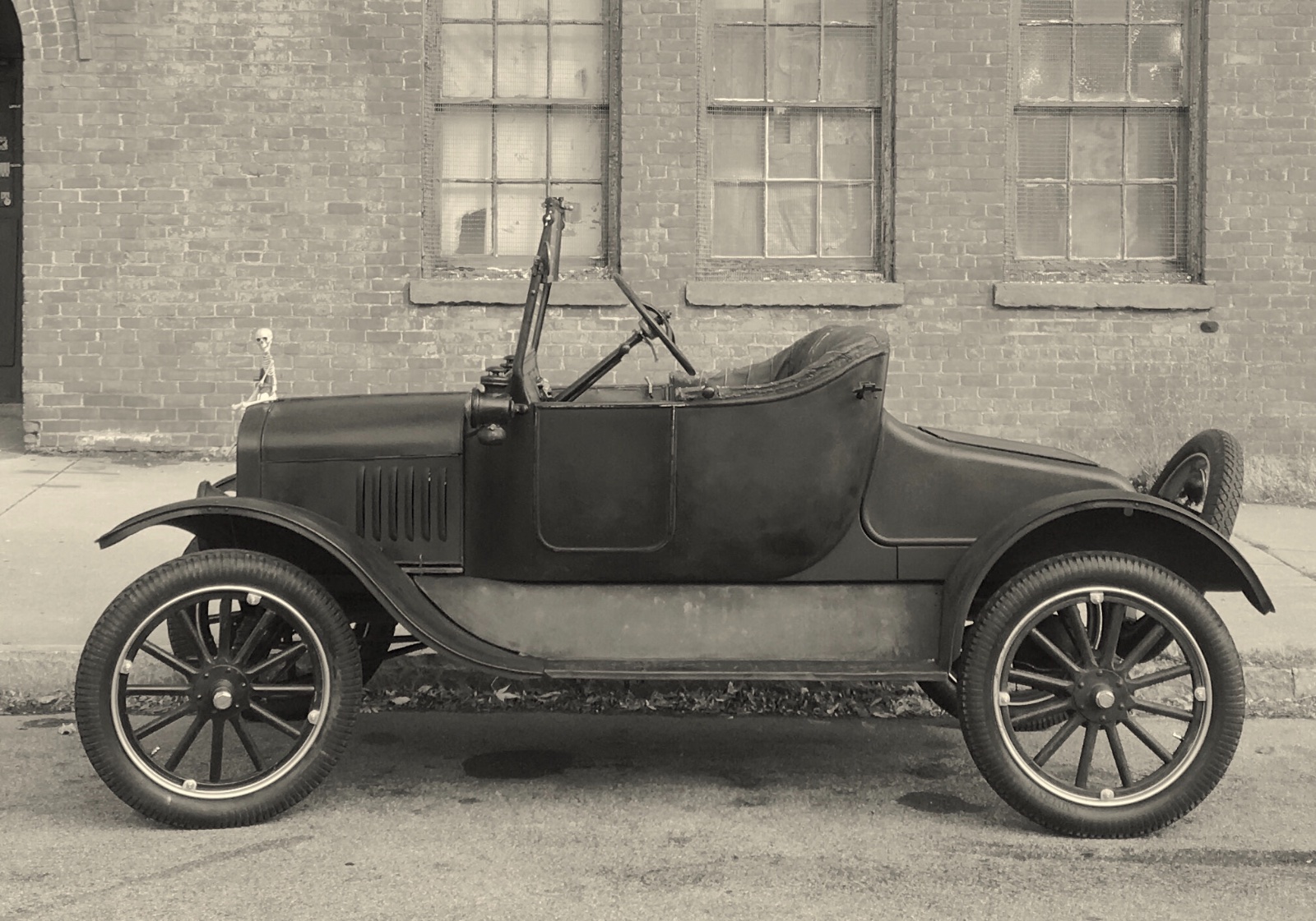

Here is my ‘23 runabout with an original “slide-on” pickup box and side mount spare. Also the same car with the turtle deck and rear spare mount. The holes were pretty close but not exactly.

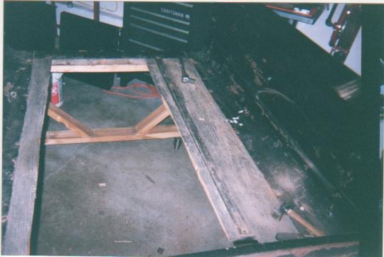

I rolled under my '25 this afternoon. The four slats in the factory roadster deck support most of the trap door. There are two front to back slats that keep all the left to right slats in place, and they support the trap door on the left and right. Keep in mind this is for a 1925. I hope this is the same for a 1926. But don't know. The trap door is the only part that is the same other than the tailgate.

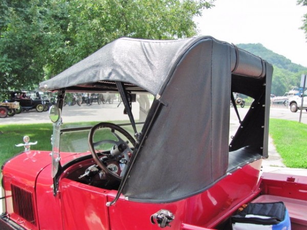

Photo showing later '26 beds with filler plates. The top bed is molested on the kick out for the battery lid (trap door), likely was used as a trailer. Both show most of the filler panels, these panels are riveted to the bed, so they are usually there, on these later '26 beds, or the remains of metal under the rivet heads if the plates are missing. Note both beds have the front stake pocket back about 7"David Mcbride wrote: ↑Sun May 12, 2019 3:59 pmMy filler on the gathering of parts is totally different i assume it to be a repop.Enough now I will get on trying to learn how to post pics with an I Phone. If any body has pics of thr filler I would love to see. thanks. IN closing Clair carleson and I will be driving our rdpu from Jackson Hole to Billings on the July Tour.
