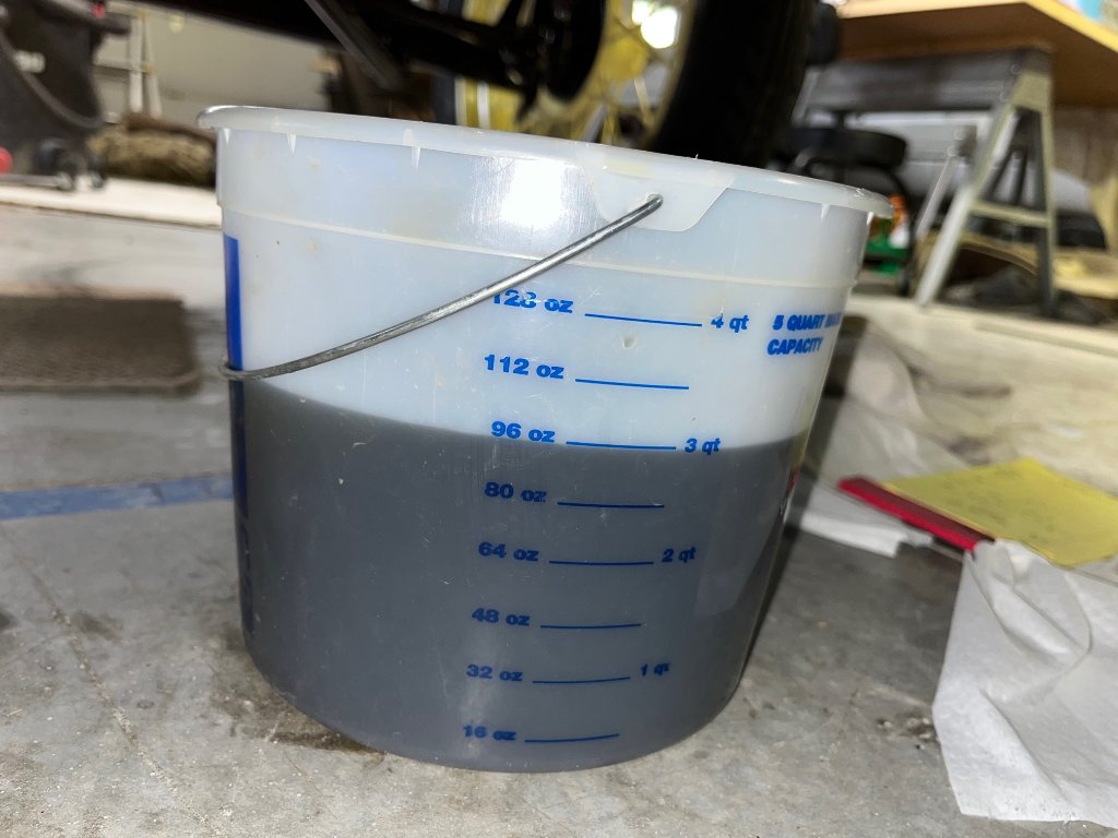

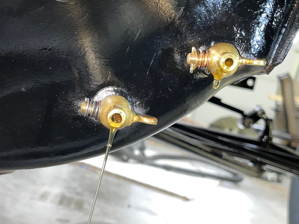

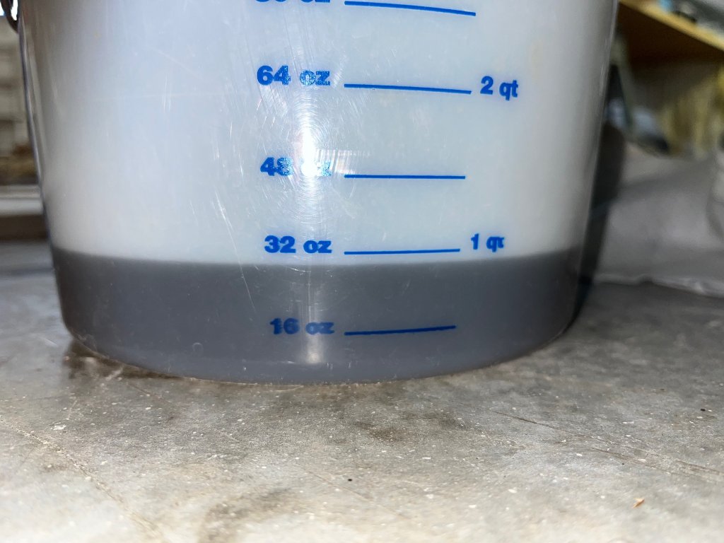

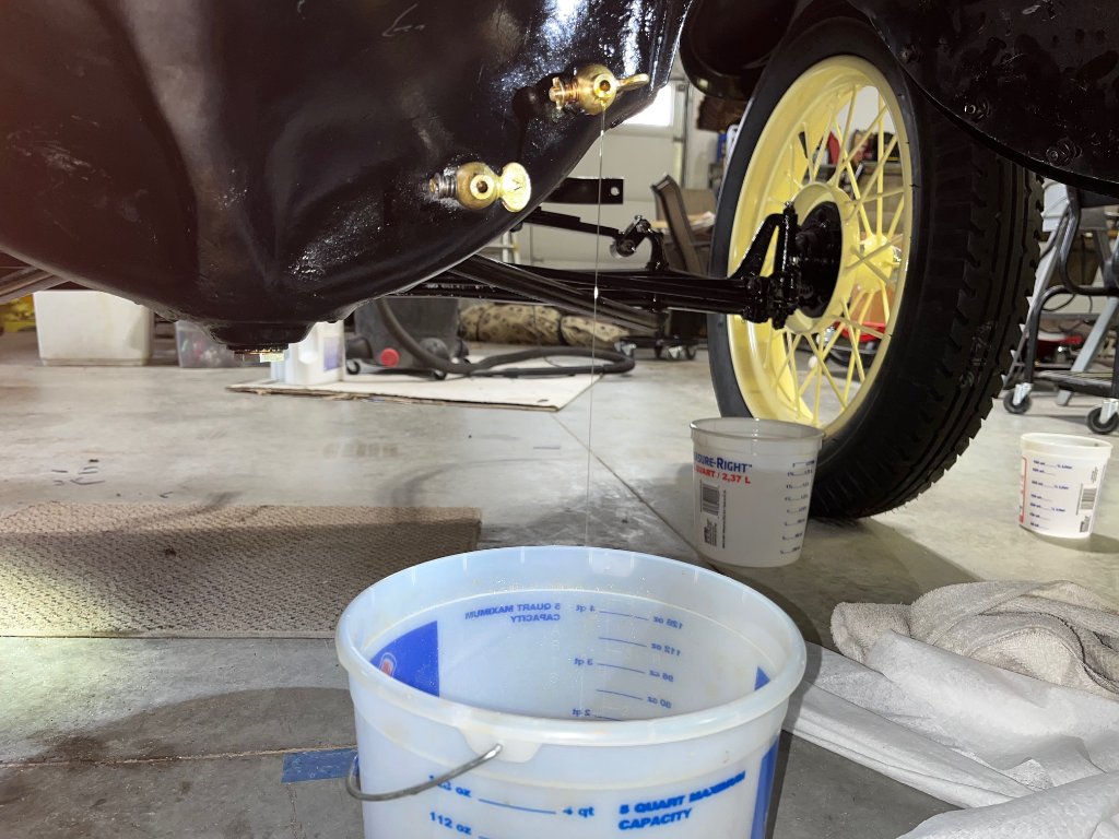

Jerry V in his May 13 (6:41am) reply raised the possibility that water maybe leaked into the oil. The block was inspected during the engine restoration so I doubted that there had been leakage. I checked the coolant level in the radiator, but I couldn't remember the level to which I filled it. Therefore, I decided to investigate by draining out the oil to determine if more came out than the 4 quarts, 23 ounces I put in.
I drained the oil in three stages. First: The oil above the top petcock (30 ounces) (See photos 1 and 2). Second: The oil between the two petcocks (2 quarts, 2 ounces) (See photos 3 and 4). Third: The oil below the bottom petcock (1 quart, 13 ounces) (See photo 5).
Total drained = 4 quarts, 13 ounces vs 4 quarts, 23 ounces put in.
I drained the oil in stages because I was curious how much oil was at the various levels mentioned above. I thought others might also be interested in that information.
Jerry, As I said in my original post, I was curious why there was so much oil above the top petcock. Thanks for pointing out the possibility of coolant leakage because now I know it was not due to leakage.
