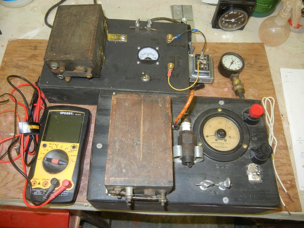

I am a buzz box user, but with lots of electronic equipment connected to it. I plan to compare the performance of coils set with my method(s) to coils set with an ECCT. Also I want to see how far off my method gives compared to ECCT specifications.
This exercise is entertainment to me.

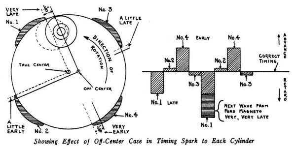

since you brought it up Mike K.
How much cylinder firing error is exceptable/not noticeable? one degree? 3,4,6?
How much error till performance is noticeable?
Timing error, I believe, comes from 4 potential areas.
1) Timer cover position. Mathematically, I figure 2 degrees +/- max @ the crank.
[Timer effect. 3" X 3.1415/360 = .026"/degree @ cam.
I Dont think you could get the cover off center more than about 1 degree worth]
Not a big deal unless you are running a roller timer & getting roller bounce in addition.
2) Timer construction error. I find 2 degrees +/- in some/a few (old) new day timers
3) Of coarse, coil firing time Up to +/-4 degrees X 2. =8 degrees. more commonly find +/- 2 degrees X 2 in HCCT tuned coils.
4) To a lesser degree of possibility, loose timing gear mesh. Maybe 2 degrees.

Not sure who created this visual but its useful to visualize the importance of timing cover alignment that imposes differing impacts to individual cylinder timing. Again, not at all supportive of linear thought.1) Timer cover position. Mathematically, I figure 2 degrees +/- max @ the crank.
And then there is the metrics for determining engine "performance". A dyno would be the preferred tool but not always readily available. I've tried real world road trials, even designed and mechanized my car with electronics for timed trials precisely timed with the opening of the throttle. Here is the article link: https://img1.wsimg.com/blobby/go/f76807 ... 3345197823
Weather/wind/humidity are environmental variables that can skew and add uncertainty to the results so multiple runs using the same configuration are needed to differentiate between a particular configuration that differs more than the repeatability of the same configuration.
For example, need to plan a baseline (control) with properly adjusted coils with an Ideal Timer that does does not contribute any significant ignition timing variation. Then start introducing ignition timing variation between coils; coil 1 at 0deg, all others at +1, +2, +3, +4 deg. Then coils 1 and 2 at 0 deg and coils 3 and 4 at +1, +2, +3, +4 deg. Then a mix: coils 1 and 3 at 0 deg and coil 2 at -1, -2, -3, -4 deg and coil 4 at +1, +2, +3, +4 deg. I'd love run this experiment but very time consuming and just don't have the time right now. By all means experiment and report your results!
- Posts: 5174
Re: DIY Coil Rebuilding
Your off center timer diagram shows the timer off center by 1/8 ". That much is not possible, unless the inner timer contacts are way off center to the body also by a lot. (This could be possible with a very badly set anderson timer).
The timing cover only has enough bolt hole slop for a max of 1/32" possible off center, or less.
Hence my supposition/conclusion (with mathematical proof/justification) that the maximum effect on timing error, in reality could only be +/- 2 degrees max in crank travel. Thusly concluding, centering the timer isnt as big a deal as is made out to be.
Dont get me wrong, Getting firing time accuracy (0 deviation)is the goal & the cover centering still has a small role.
Or am I missing something?

That diagram is possibly from a Fahnenstock article, indicating what a misaligned engine timing cover has on commutator centering.
- Posts: 5174
That could be, but is overly exaggerated.
Maybe to make the reader understand the "principle" easier.
