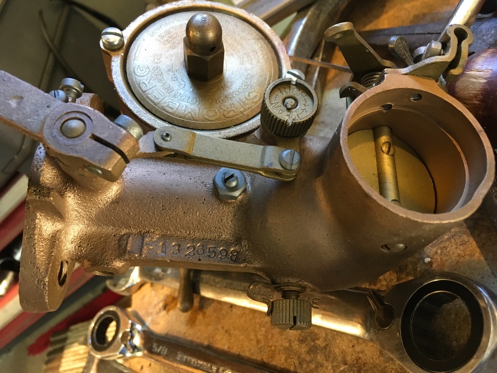

Bought this LF off of eBay. Cleaned it up inside and out. Very little wear on any of the parts. Went to install it today and realized that the flange bolts threads are small then manifold holes and course thread. Spacing is correct. Is this the correct LF for a T, or did I not do my homework before I bought?

Yes it’s for a T. Flange holes are coarse and 3/8”.
If flange holes line up with intake holes, you’re good to go
