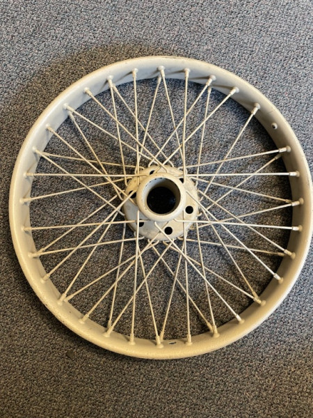

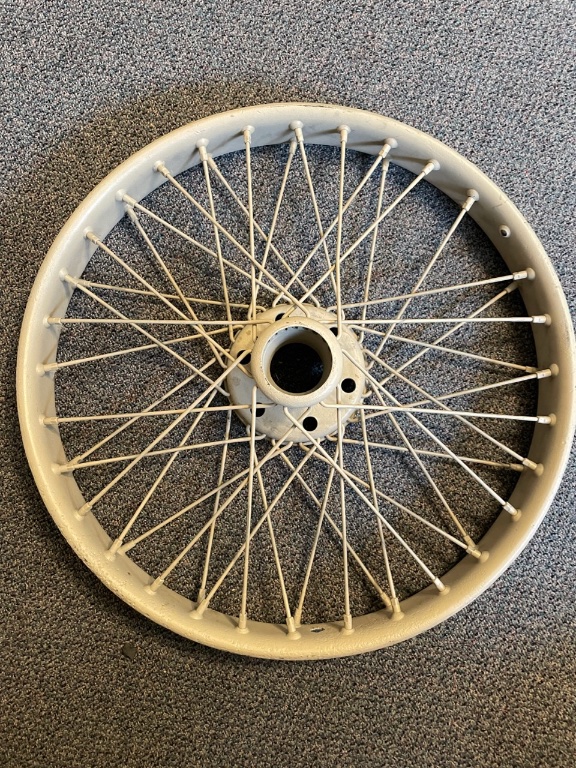

Thanks. They are 48 spoke pin drives. I think they take regular 30 3 1/2 tires, like a regular T. Some of the rims are ok. A couple have some sharp spots. All of the nuts are seized and I am looking for a properly fitted nipple wrench. I have 5 wheels and a full set of hubs. Here are some shots of one of the wheels. If you have a sharp eye, you will see some spokes missing. They were sent to Dayton to make matching spokes.

If your other rims are as sound as the one photographed, I would use them. They will need a little more preparation before painting though, if that is what you are trying to avoid.
Laced wheels should be painted rather than powder coated. The spoke nipple tool should be freely available, perhaps from a motorcycle restoration service.

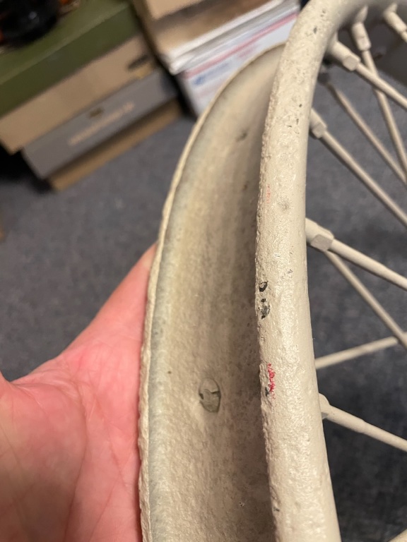

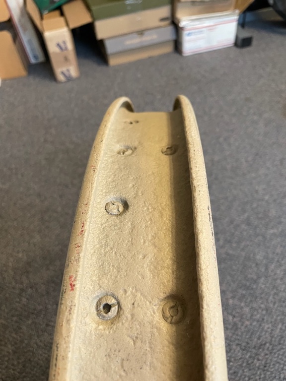

Most of the rims are not bad, but a couple have areas where rust on the edge has made them sharp right where they contact the tire. I could weld these areas up and reshape them, but I think that could cause issues. I am not sure what the steel is and heat could warp the rim.

Here is a shot of one of the sharp parts on one of the rims.
