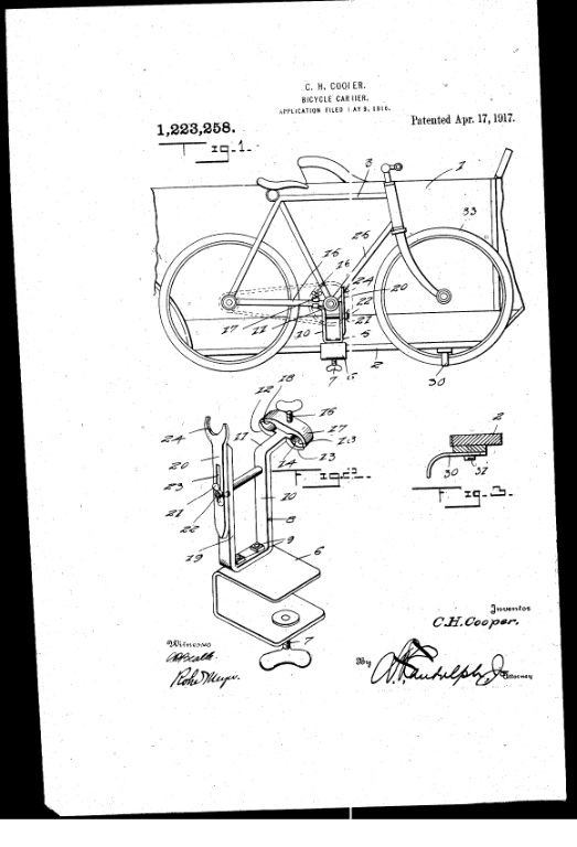

Anybody out there using their T to transport a bicycle or bicycles ? Thinking of adapting a rack for two bikes to the rear of our 26 Tudor.
Not sure if utilizing the spare tire rack is the way to go, or would it be best to come off the frame.
We plan on doing some touring but thought it would be nice to take the bikes along, would give us an excuse to stretch our legs.

Found on the web

Years ago at Hershey, I saw a bike mounted on the driver's side running board of a teens or twenties automobile.
