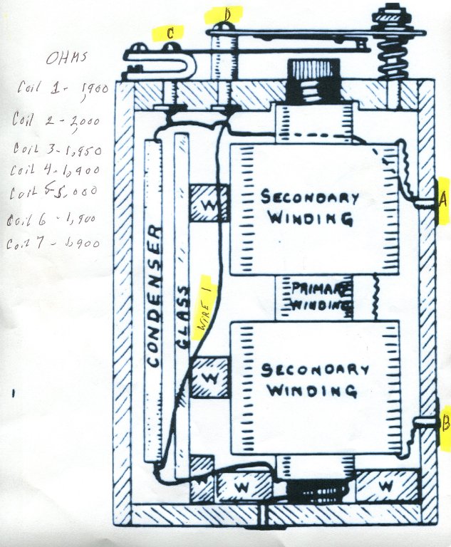

I am working on installing new condensers I purchased from Langs. I am working on 4 screw brass top coils, 6 screw brass top coils and 4 screw copper top coils. Look at the attached diagram and you will see that I have recorded the ohms taken from point A to point B along with my readings recorded on the left. These were taken with my 40 year old multimeter. Are these readings within the normal range for these coils?
Look also at “Line 1” and where it terminates. According to the old coils I have, the line should terminate at C, not D. If I rewire the coil to the schematic will the coil work or will I ruin it?
I guess the last question I have is, are the metal top coils wired differently then the black top coils? I have to do 20+ metal top coils.

The Condenser and Primary Winding both have to be parallel to the points for the coil to function.
Those wires do not always connect to the same screws on top.

No need to rewire the coil if you're just replacing condensers / capacitors.... Just remove old capacitor / condenser and connect wires of the new replacement unit that attached the former condenser/capacitor...... Many other steps are needed to properly calibrate physically and electrically.. the analog meter with the moveable needle gives more accurate readings.

I read recently in an older VF the wires to C and D were reversed on Ford coils from KW coils..
Look at VF volume 21 #2 , March Apri 1986 if you can.
A very good article there on coil rebuilding and on page 24 and at the bottom it mentions the wire reversal between the KW and Ford coils.

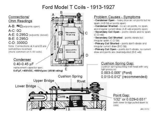

Re- take readings with a analog meter, with a piece of paper slid in between the points on top , the reading between points A and B should be around 3300 ohms, to check condition of the secondary windings....... Just take your coils to a wire wheel to clean up the contacts on the box also to ensure accurate readings

Information previously on forum
- Attachments
- IMG_20230530_082146.jpg (62.51 KiB) Viewed 3402 times

Craig,
Robert and others have posted useful information and advice.
I have a couple of suggestions resulting from the data you presented:
(1) Coil 5 appears to give quite a different resistance than the others. Either you had a poor connection when measuring, or there may be something awry with that coil.
(2) You could 'calibrate' your meter with a 3k3 resistor (or 2k7 say). To some extent the more useful thing is that all but one of the coils are within a few % of each other, and so IMV are likely to be ok despite the apparently low reading, however measuring a known resistance should tell you if your meter is working properly, or not, and from that allow you to determine the accuracy of your readings.
FWIW I have just measured four coils here, they range between 2.62k to 3.38k across where you have measured yours and, if recall correctly, all work(ed) satisfactorily in the vehicle. Three are 'standard' coils, and one is plastic, I don't have any metal-tops so cannot comment on them. Measurements taken with a digital meter.
I believe it's been discussed before but as most of these coils will be 100 yrs old, give or take, it's useful to consider that the manufacturing of the era did not allow for precision. I would expect that unless you had coils from the same batch, wound by the same (careful) person on the same day with the same gauge of wire, you'd get quite a variation, particularly in the secondary winding.
For the sake of establishing a record for anyone that comes along, I may be able to measure a few more secondary windings later today. If so I'll report back with the results.

Thank you everyone, I am going to borrow a digital meter to check my coils and will get back to this later. I did find the magazine Dennis mentioned and am going to do some reading. Another thing, being that my coils are either brass or cooper top coils my coils are probably KW coils and not Ford coils. Thank you, Craig

Sorry I didn’t get back sooner but my computer was down. I borrowed my son-in-law’s digital ohm meter and got the following readings.
13.4
3.54
2.37
3.66
3.42
3.44
3.53 and 3.59 using the 20K scale. On all the other 12 coils I didn’t get any readings at all.
After reading what everyone said and studying written reports, I think I will install the new capacitors the same way they are installed in the coil now, clean up all the contacts and put in new points. Everything should work out that way.
Remember, these are all brass and copper top coils.
Thank you everyone that has replied to my post.
