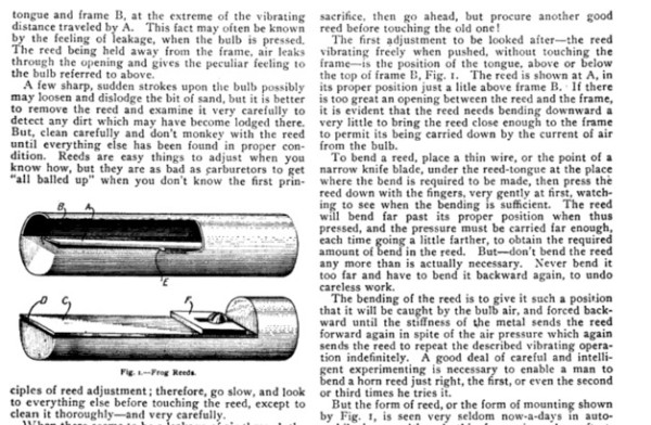

Adjusting horn reeds is an acquired skill, have seen a knowledgeable T'er adjust the tone using a pen knife, and a wooden match stick, he carved the match stick to a narrow narrow long flat, and inserted it into the reed and bent it some. The horn had a high tone, and he got the horn to make a nice low tone. But, that was experience.
Photo of expert friend, sadly Pete passed this year.
Have tired it myself using a flat steel artist oil paint paddle, very thin long one. Slipped it between the reed and body, just a tad. Tried the reed again, nope, no change. So did a tiny bit more lift. Well no sound at all! Pried the reed too high I guess. And once pried up, you can't bend it back. Good thing I had a spare reed, that would at least honk!

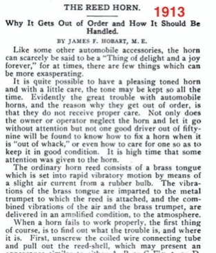

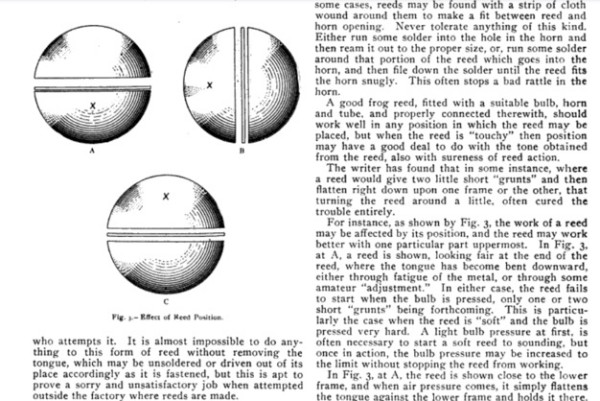

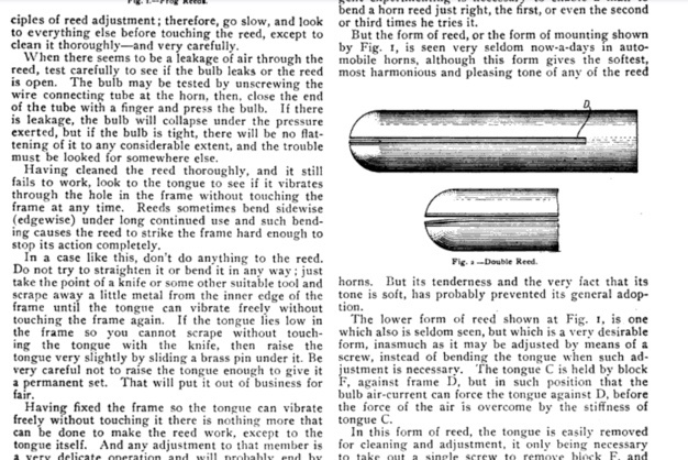

Here is some excerpts from a 1913 article in Automobile Repair journal. You can read enough to see only experience can lead you to a nice sounding bulb horn honk.
[/b]

Thanks for that article Dan. What's most obvious is the reed illustrated in the 1913 article is quite different from the reeds I've seen, which appear to be half of the reed in the article. It's all fascinating ! More study is indicated !!

Didn't load all the screenshots as some were fuzzy to read. Yes there were lots of styles of reeds, today the repros are about all the same frog reed type, with one thin edge soldered and the other free end off the reed case just slightly.
