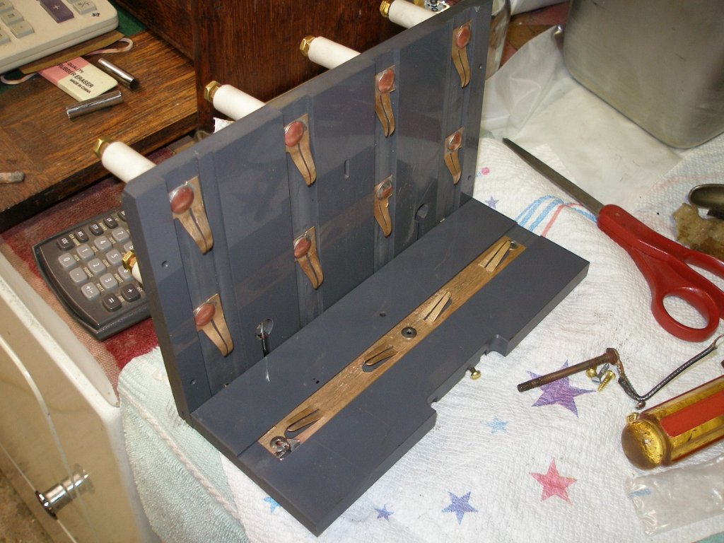

Thank you for all your help and photos in this little project. I have accomplished "squaring the holes" and will reattached them after a good cleaning this afternoon. I have another question regarding the soldering...I haven't done much of that, so please give me a little insight... I assume that I'll solder the heads etc, after installation of threaded rods onto the new composite back board & ive tightened them, right? Then I use the soldering iron to heat up the head & when it's hot enough , ill apply the solder around the head & it'll suck it in? then let cool? Thanks for your useful comments and help! Chris

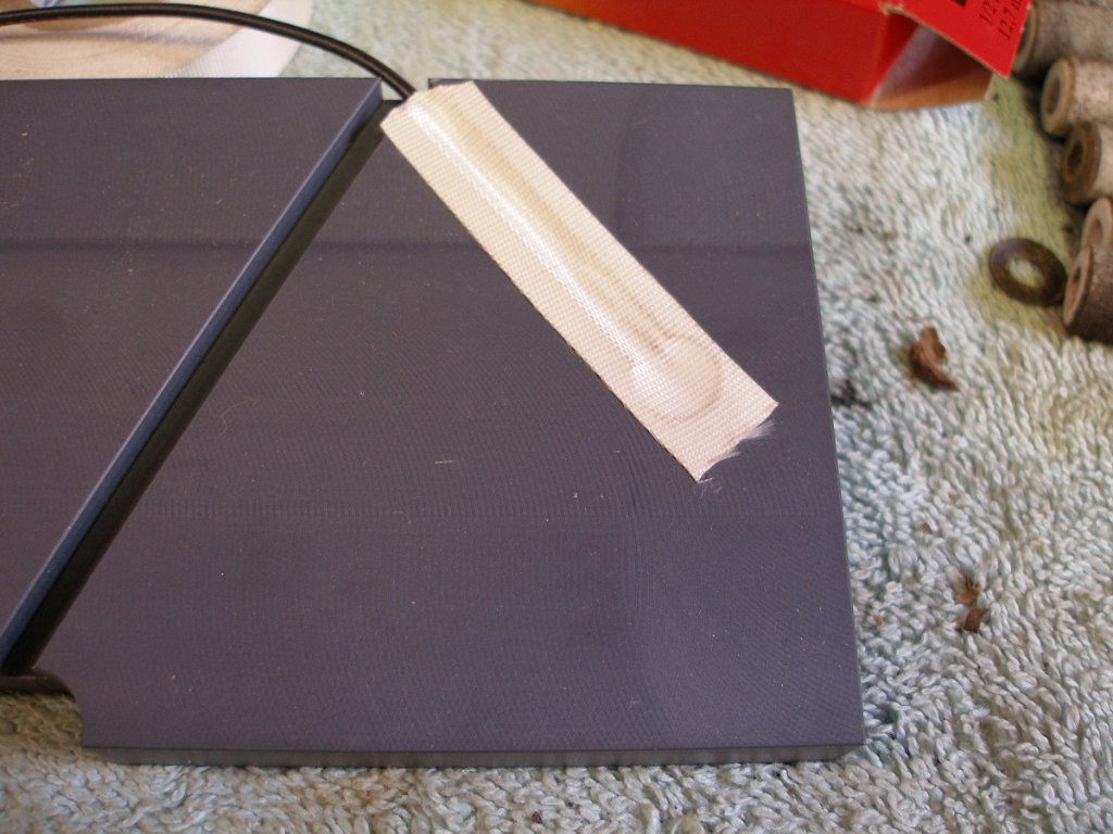

Fiberglass tape to insulate wire from bottom of box (your wire will likely lay in a different slot, but for your sake, be sure to use the tape to avoid a future short): P1290170.JPG

For easy soldering , used the old wood board and arranged the cleaned contacts and new bolts in order. With a small electric solder iron, easy to solder the contact edge to the bolt head.
As for insertion, transferred each one, in order to the new board, and used a punch on each bolt head and drove that carriage head bolt soldered to the contact into the new plastic insulator board.

Thank you all, friends, for helping me with this project, Scott Conger- your thoroughness is appreciated. I opted to special order the correct flux and 67/33 solder....project went pretty well, I installed the unit and reattached all wiring & surprise! It all worked! Thanks 1,000,000! C
