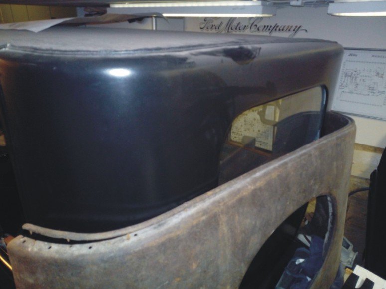

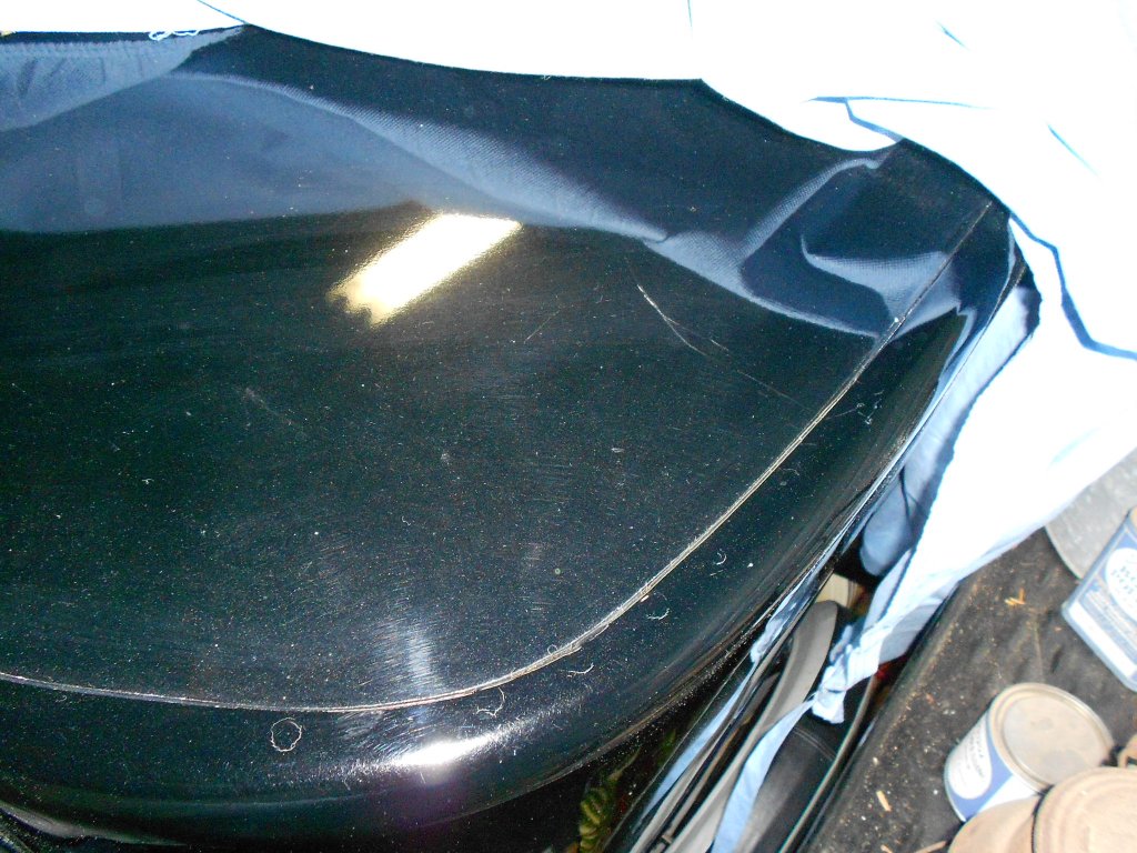

B above…..The curved rear panel covers the vinyl roof material then is nailed to the wood frame. Here are pictures of my ‘19 centerdoor. As I’m a Doctor of Breast Augmentation, I brought home a tube of silicone to apply under the curved panel before nailing….

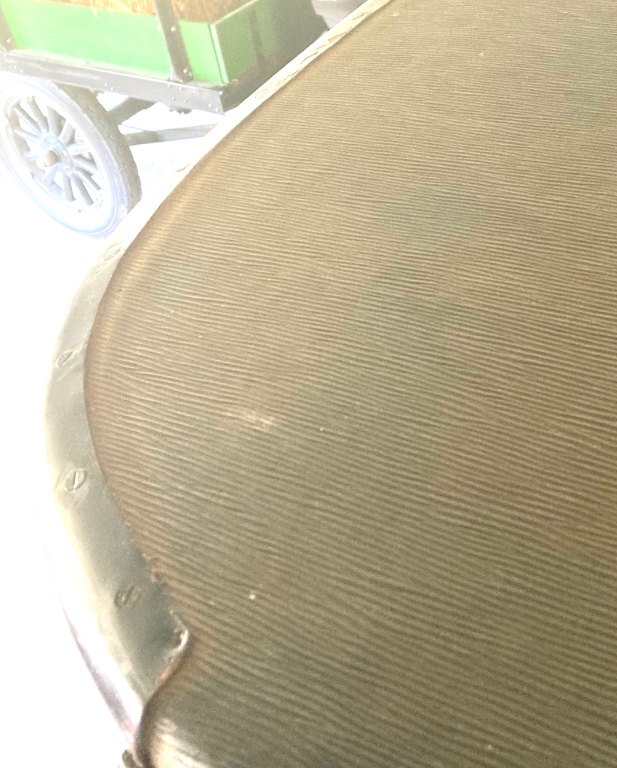

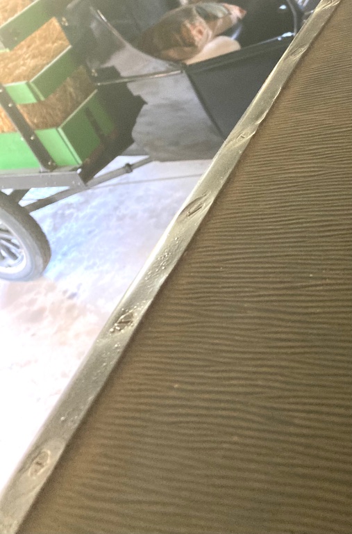

Les ?… really ?…im positive I’m the second owner of my centerdoor. And I’m positive I restored it and I’m positive I removed remains of ‘long grain vinyl’ in the enclosed picture and replaced it with new as in previous pics this thread. However, I didn’t use the ‘sealer’ you mentioned. I used silicone under the curved sheet metal instead.
