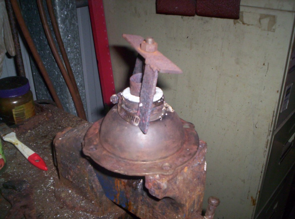

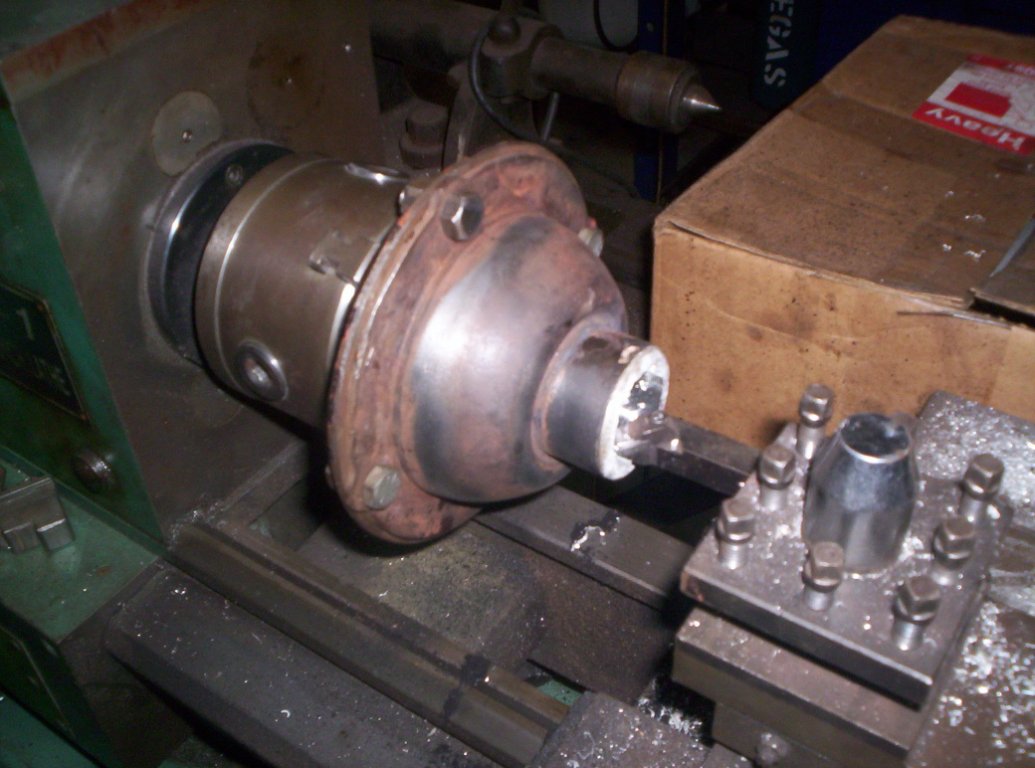

After melting the old babbitt out, when pouring the 4th main, does it need to be tinned before pouring? Seems to work fine without, but don't know if it needs it.

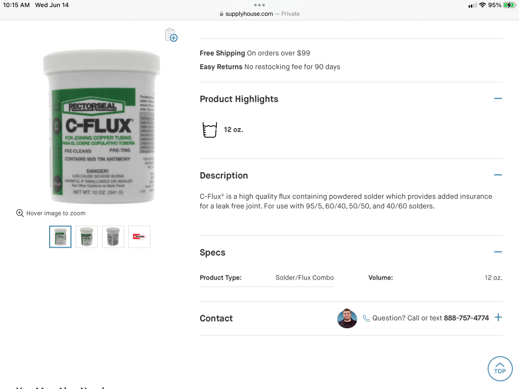

. I like this stuff for tinning. All the plumbing supply have it around here. Don’t forget the flux brushes
