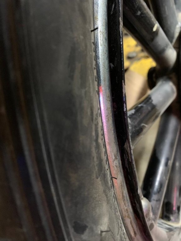

I just mounted my new Firestone tires, with new tubes and flaps onto my new rims from Australia too. The stem holes are off center a bit. The original ones are in the center. I think they will be fine. This is the first time for me working with clincher rims. The problem that I am having is that the rims are not going all the way onto the felloes. Have you put yours on the wheels yet?

Scott, what are the indications that the rims are not going right onto the felloe? If you are reading that the lugs will not impinge on the outer face of the felloe, that is how they are supposed to be.

Allan, just the opposite. They will not seat against the felloe on the back side. That causes them to have runout. There is a bead rolled into the rim and it will not let the rim all the way on the felloe.

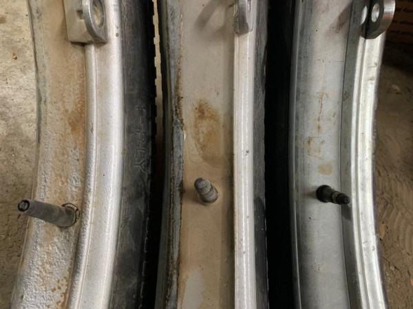

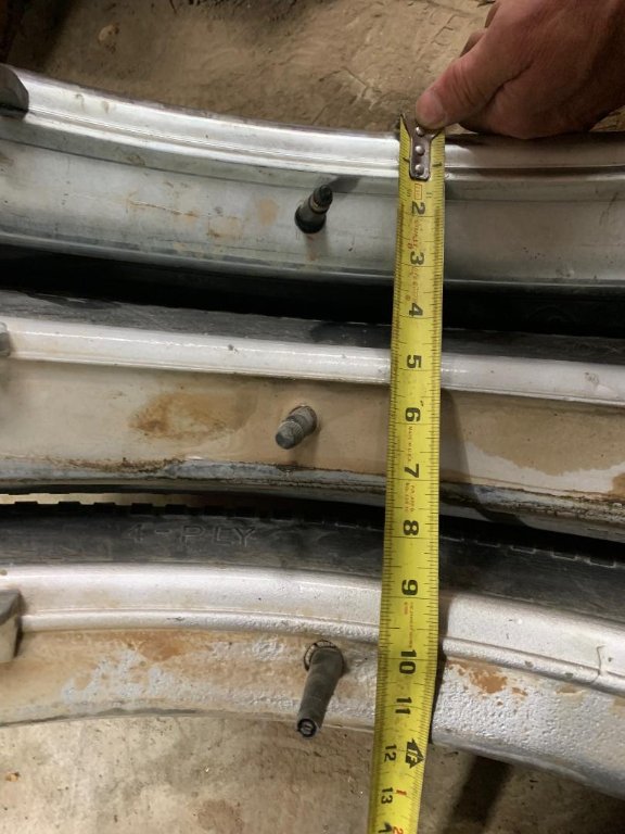

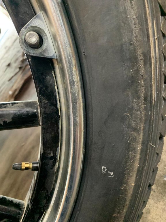

Here are some pictures. I tried another rim on that same wheel with the same results. Is it possible that I have a bent felloe?
- Posts: 5486
Re: tube question 30x3-1/2 demountables
If those are 3 of the rims off your car, they are all different manufacturers so that isn't helping out with the rim seating on the wheel issue. I see one Hayes with the "foot" that seats into a matching cut-out on the felloe - a copy of a later parts list shows the difference in rims.
Scott C.
- Posts: 856
- Last Name: Clements
- Location: Waynetown Indiana
The one on the top and on the right is the new one. The next one came off that wheel. The bottom and left one is from the other rear wheel.
- Posts: 7395
While rims eventually were standardized, for a few years wheels from the different makers required matching rims. The variety of wheels and rims coincided with the years of peak production, so there are a lot of the various types around. I believe Hayes is most plentiful.

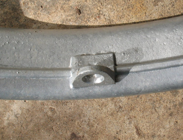

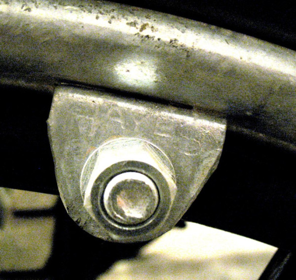

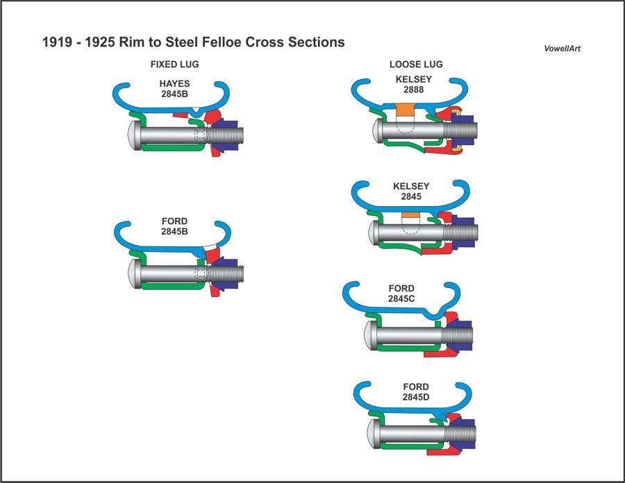

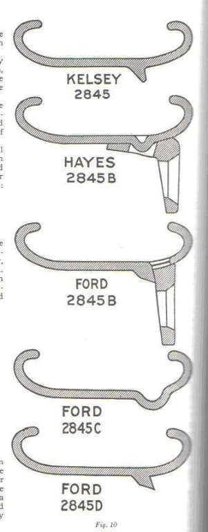

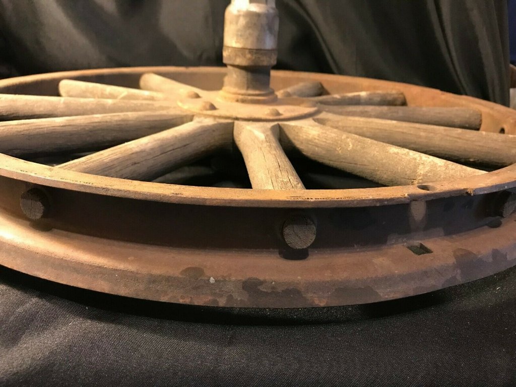

I found this picture. It appears that my new rims are the Ford type 2845B. I have read that the Ford and the Hayes should work interchangeably. So, my next question is How to identify the different felloes? I see the notch in that Hayes felloe in your picture. What else do I need to look at?
- Posts: 7145
Scott, your new rim is not a Ford 2845B. The 2845B rim has a solid steel bead around the circumference and a flat base on the rim. Your new one has a rolled in bead and a corresponding groove around the base of the rim. That type of rim with lugs fitted is a hybrid I have never seen. On the Kelsey wheels fitted to our Canadian sourced cars, the rims with the groove rolled in them are fitted with loose lugs, not fixed lugs. The loose lug felloes have a different cross section to the fixed lug type felloes. The rims do wedge on the outside edge of the felloe, whereas the fixed lug type wedge on a wider inside land on the felloe.
Either way, I believe the rim is the cause of some of your problems. The valve stem hole should be central on the rim. The combination of rolled in groove and fixed lug may be adding to your dificulties. Does it fit properly on any of your wheels? if not, I suggest you contact the maker/vendor who sold it to you to seek clarification/rectification. Detailed photos of the felloe might help.

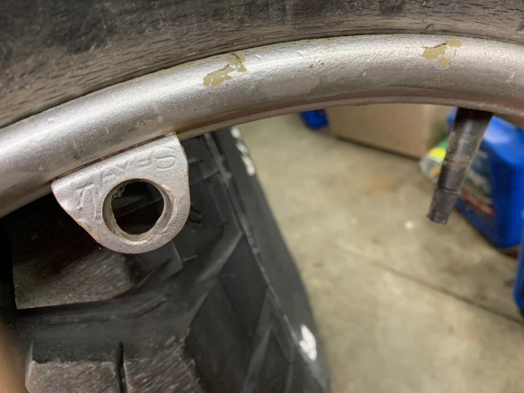

Typical Hayes rim, the lug bolt hole nearest the valve stem most times is slightly oval, so then the rim is placed with tube stem in the felloe, the bolt is entered last after the other 3, so the bolts can pass and the rim fits snug, prior to adding the bolt lug nuts.

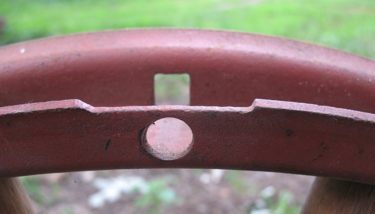

I believe the ovality in the lug hole nearest the valve stem is purely to aid in the fitment of the mounted rim/tyre/tube assembly. The square under the head of the rim bolts was originally upset a little so the bolts stayed in the felloe. With the car jacked up and the valve stem hole in the felloe at the top, the rim is fitted by angling the left side out away from the felloe and the right side a little over the felloe as the valve stem is inserted through the felloe. Then the skewed rim is rotated to align with the felloe. It is then that the ovality in the lug allows the rim to go on over the captive bolt. Close inspection of a good rim will show the countersink in the lug around the bolt hole is concentric with the bolt hole, the ovality created by machining off part of the countersink on the lower right side of the hole.
Today, with the bolts no longer held captive in the felloe, it is just as easy to tap the bolt nearest the valve stem back, fit the rim and then tap the bolt back into place.
Our Canadian sourced cars came with Kelsey wheels. Until 1925, they were all used loose lug rims. In 1925 we finally saw fixed lug rims. Being Kelsey, there was no foot on the lugs, so the rime bolted straight up and wedged on the wider inner land on the felloe, the lugs being proud of the outer face of the felloe. I have never seen a 23" wheel with the straight up outed edge of the felloe as shown in an earlier post. Those only came on the 21" wheels introduced on the improved 26-7 models. Any Hayes wheel I have seen has the same rolled in outer edge on the felloe as the Kelsey wheels, with a depression pressed into the rolled edge to accommodate the foot on the Hayes rims.

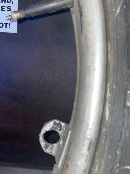

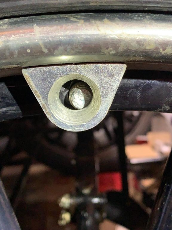

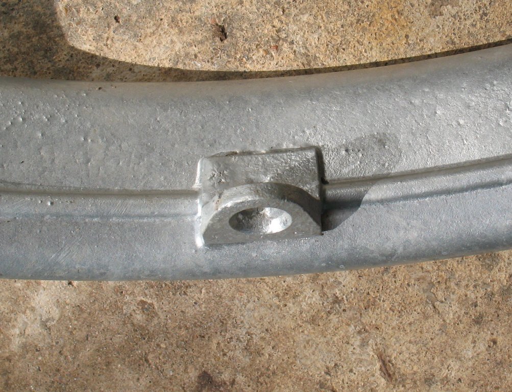

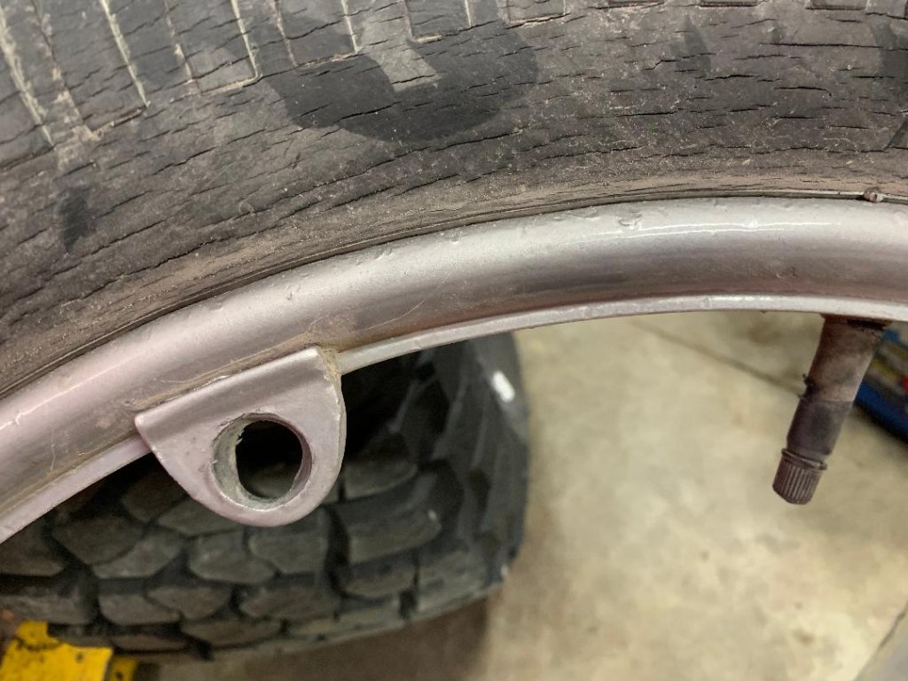

Here are the lugs next to the stems on the 2 original rims. They are both elongated in and away from the stem, just like the one in Dan's picture. Neither one appears to be original. They both look to have been done by hand. I removed the bolts and layed the wheel flat on the floor and the rim still does not set flush in the felloe all the way around. I am wondering if the felloe might just be bent on this one?
- Posts: 6717
whether or not done by hand, they were all but certainly done at the factory

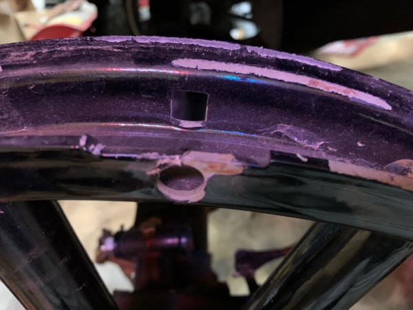

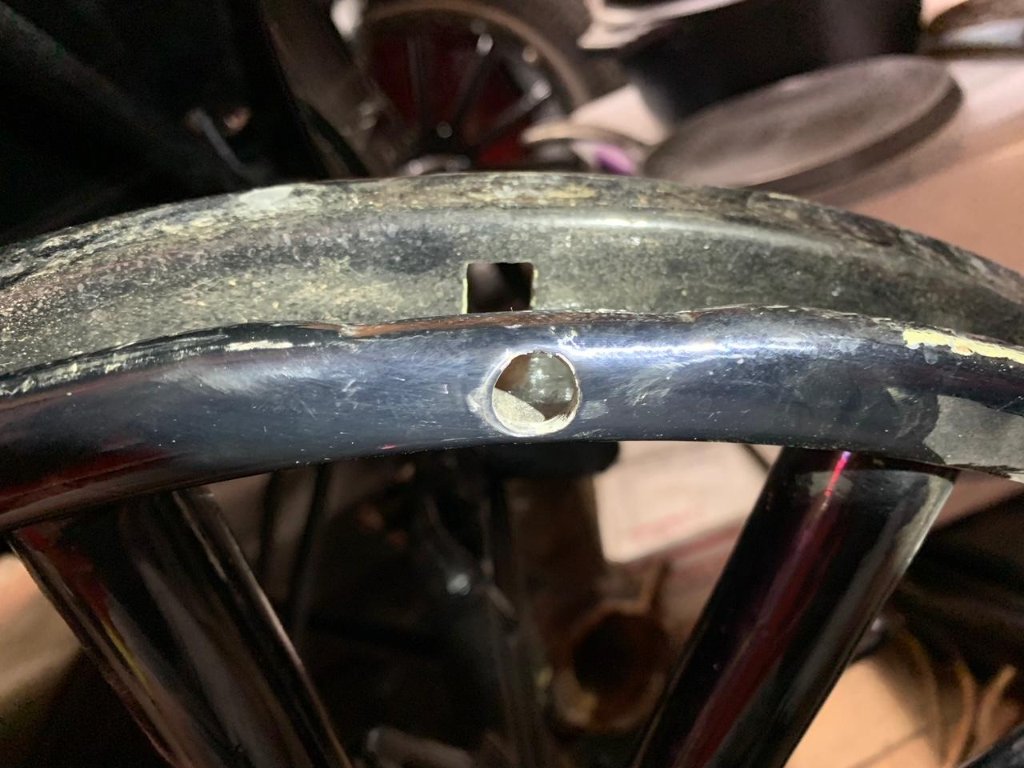

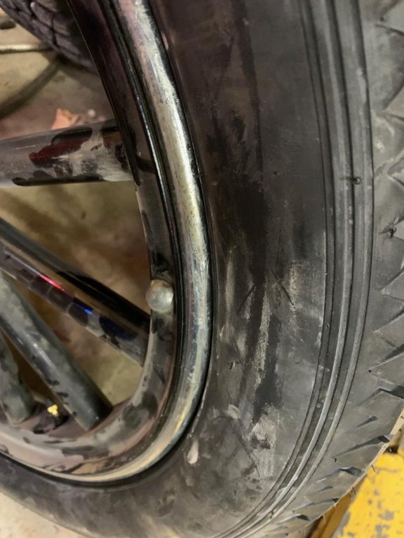

I am making some progress! I tried to put that rim on one of the front felloes and had the same issue. I tried another rim on the front felloe and it went on easily. So, I took it back off and put it on that rear felloe. It went on ok. I think that felloe is tweaked a bit. Not sure, if I did that with the 5lb leather mallot trying to get it to seat, or if it was already that way. I need to put it back the axle now and check the runout. It appears that the lug to the right of the stem is out of position. I removed the nuts from the bolts on both of the rear rims and the bolts are not binding up at all. So, I think I have a lug that is out of position. I need to continue and check all 5 rims to see how many are defective. Here is a picture of the misaligned lug. It is the one on the opposite side of the stem. So I might have two different issues going on. I did receive an email back from Steve and he will replace all of the defective rims.
- Posts: 7145
Scott, thanks for reaching out to Steve with your problem. It gives vendors valuable feedback about their products, and a good vendor will do what can be done to fix the problem.
Re the possibly damaged felloe, it can be checked for run-out and out of round by spinning it on the car. Put a block of wood on the shop floor adjacent to the felloe and rotate the wheel by hand, checking for run-out against the block. Few well used wheels will be absolutely true, but this check will give you an indication. Then jack the car a bit and put the block under the wheel to check for out-of-round. Out of round is a more difficult problem to deal with.
Hope this helps.
Hope this helps.
Scott,
FYI - Here is an except from my correspondence with Steve from Australia:
Steve,
I rec’d the last two wheels. They look nice but don’t fit very well. The lugs are not positioned very accurately, a variation as much as 5 mm between holes measuring between north and east, east to south, etc. (just using a tape measure). I may need to oval the holes in my wheels. I just wanted to let you know so you can check your process.
Martin
Hi Martin,
I took what you found on board and checked what rims we had on hand and the Felloe that I use as a jig.
The Felloe I have used for years is a new [ old stock ] Kelsey one. Made in Canada.
I took some measurements like you said and found the exact discrepancy you did. About 5 mm . probably only one hole in the felloe.
I'm assuming all felloes had the same pattern as I haven't had it bought to my attention until now.
I think Hayes may have supplied felloes to ford as well and drilled different. Just a thought.
Have you tried the rim in the 4 different positions, disregarding the valve hole position?
If you find that it fits one way, and the valve hole is in the wrong position, you can drill a new valve hole in the right spot.
I use a step drill for this .
We generally mark the valve spot when we weld on the lugs. If for some reason we took the rim off after welding, and put it back to mark the hole we may have placed it differently and only lining it up with the nearest hole.
Let me know what you find.
I don't particularly want you altering your felloes.
Do the first pair fit those wheels ?
Steve,
Thanks for your quick response. I have two slightly different fellows, but I’m not sure who manufactured them. The first pair of your rims seem to fit the fellows I tried them on well, the second pair are not as evenly spaced but I have not tried them in different positions as you suggest. I will have time this weekend to do more measuring and checking.
Martin
Steve,
I think my problem has more to do with my felloes than with your rims. They don’t go together easily but I did manage to get the rims onto the wheels this weekend. I did not drill new valve stem holes. The wheels are not on the car yet so I don’t know how round and straight they are.
Martin
Martin,
Ok, see how they run when you get them on the car.
Let me know if there’s anything I can do to help .
Regards,
Steve.

I mounted my tires first, without test fitting the rims. I now know that I should have done that. I have 2 rims hat will not go on. I tried them on 3 different felloes so far. The first one, that I drove on with a dead blow hammer runs very true. The second one, that I struggled with has more wobble than I like, but I think that felloe could be bent. The 3rd one wobbles also. Maybe I need to reinstall the old ones and check the run out too. I never did that before taking them off. I have not tried the fourth wheel yet, as I have it parked where I cannot get to it. My time is very limited, due to my working 7 days a week.
This is the third set of rims that I have bought from Steve. The other two were 21" split rims. The only issue with those is that they do not fit in the spare tire carrier. I had to bend the two ears out where the rim rests. The same goes with these clinchers, they are too wide also. I sent him another email describing all the steps that I have taken trying to install these rims. I have not heard back from him yet. It usually takes him a few days to reply.

I reinstalled an old rim on that rear wheel and it fits fine and has less run out than the new rims I am now sure that the felloe is not bent. I have an old picture that you can clearly see that the original rim seats up fine to that felloe. Whereas the new ones do not. I am to the point that I am thinking about going back to the original rims.
Martin

Here are pictures of 2 of my felloes. The top one is the rear one that I drove the rim onto. I was able take if and lay it on a block of wood and drive it off.
The bottom one is a front one. I can get 1 rim on with a little more wobble than I like.

Just a thought: The rear looks like it has a lot of paint on it. It may help to strip the old paint and give it a fresh thin coat.

The wheels had been blasted, primed and painted when it was restored in 2010. So, the paint should not be an issue. However, I am happy to report that I now have 4 of them mounted on the truck!! The worst runout is about 1/4" at the side wall of the tire. I started with one felloe and beat all 4 of the rims on and off and back on. Then checked the runout on them. Then moved to another felloe and did the same. The fifth rim will not mount on any of the felloes. That is because the lug is out of position. I emailed Steve the good news and informed him that we only need to replace 1 rim. Thank you to everyone for helping lead me in the right direction.

I have put a few miles on it and the rims are working fine. I received an email back Steve and he is making me a replacement rim for the one that does not fit.
I did notice that I have some loose spokes. So, I am thinking that I need to find a set of wheels to rebuild.

OK, let's try to clarify what type of felloes and rims that I currently have. I am getting conflicting information. The 2 pictures above are of the 2 different rims that I have. I have been told that the top one is a Hayes and the bottom one is either a Hayes, or something else. I received this drawing on my other post. It clearly disagrees with what I have been told by some, but not all. If I am seeing correctly, it shows the top one to be a Ford and the bottom one to be a Hayes. I have 3 of the top one and 1 of the bottom one.
On my original rims according to both of these drawings, I have 3 Hayes rims and 1 Ford rim.
- Posts: 6717
With FORD literature in front of you along with well researched modern cutaway drawings vs conflicting information from the Forum...for me, deciding which to believe would be a no-brainer
there were a number of manufacturers operating independent of "factory" suppliers and that can obfuscate things as well, but for me, having dealt with your exact problem (mismatching felloes) many times, there is no confusion for me as to what you're looking at
One thing you've learned for certain, that without a photograph, if you buy a "Hayes" rim from someone on the Forum, you will have no idea what is in the mail until it arrives. That in it's self is a valuable lesson.

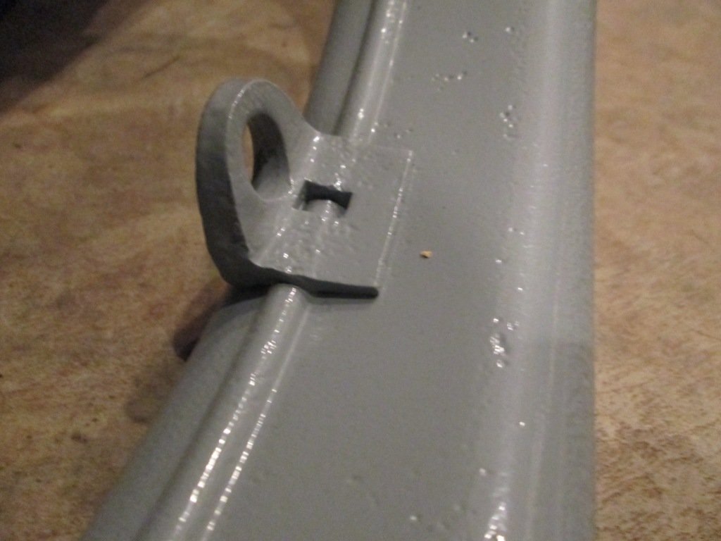

There are also 2 styles of Hayes rim lugs - one has a more pronounced straight edge - the other is as in Steve's photo - I'll attempt to get a comparison photo later.

Are they Ford, or Hayes? It doesn't matter whether the felloes are really Ford, Hayes, Kleenex, or Sal Hepatica, as long as the rims fit them.
- Posts: 7145
Scott, not all of us agree that the drawings are correct, I for one. [and possibly the only one] None show any difference in the width of the inner rolled lands. Our Kelsey loose lug rims are like the second Kelsey drawing. Both the rolled edges are the same width. Rims to fit these wedge on the outer rolled-in edge, and do not engage on the inner edge.
Fixed lug rims, which we did not get until 1925, are made to wedge on a wider inner rolled edge. They do not engage on the outer edge, especially that straight up edge on that type of felloe.
I agree with Steve, to a point. If they fit, they fit, no mater what the combination. However it is how they fit that is important. Whatever the combination is, the rim should wedge on one of the felloe lands. The wheel bolts/lugs are there to maintain that wedge effect If the fit you have relies on just the four bolts/lugs to keep the rim tight on the felloe, it is not a combination that fits well.
You have found that re-working sections of one of your inner edges has improved the fit of the rim on that wheel. With the rim wedged on the reworked land, you have achieved the correct fit.

Looking at that drawing, I cannot tell the difference between the Hayes 2845B and the Ford 2845D. The same goes with the Ford 2845B and the Ford 2845C. So, will a fixed lug rim fit a loose lug felloe? Plus the Kelsey's appear to be 2 piece felloes.
The one felloe that I am thinking is a Hayes, has the tube for the valve stem to pass through. The ones that I am thinking are Ford only have a hole for the valve stem.
- Posts: 6717
You do not see that one has a lug on it and the other has no lug?? If Martyn's drawings are confusing you, just look at the FORD drawing
In reality, putting a rim with lugs on a felloe which takes loose lugs creates a problem which is not obvious. The loose lug felloes frequently are not the same diameter as felloes for lugged rims. They were not made interchangeable and are not compatible. What happens when you mount a lugged rim on a loose-lug felloe is that you can often see a distinct visible gap between the OD of the felloe and the ID of the rim. You end up "hanging" by the bolts and since the rim is not supported fully by the felloe, the rim flexes giving a lumpy ride and the bolts work sufficiently against the felloes that somewhat significant cracks can develop.
As for the "tube" that can be found with a short search to be a firestone version which took a rim that had a corresponding protrusion that fit into the tube/cup. That general cross-section of felloes can be found as often with as without those cups. Firestone/with and FORD/without
This really isn't that difficult of a subject to get right. I'm constantly amazed when threads like these go over 3-4 answers. The question is asked- the question is answered; the ford documentation is plentiful, and the factory-listed compatibilities are defined. Regarding all of the other many wheel manufacturers and compatibility, that is another thing entirely.
BTW - those drawings by Martyn aren't "two-piece felloes" - you are looking at a cross section through the felloe where there is a stamped dimple raised to act as a "stop" for the lug
