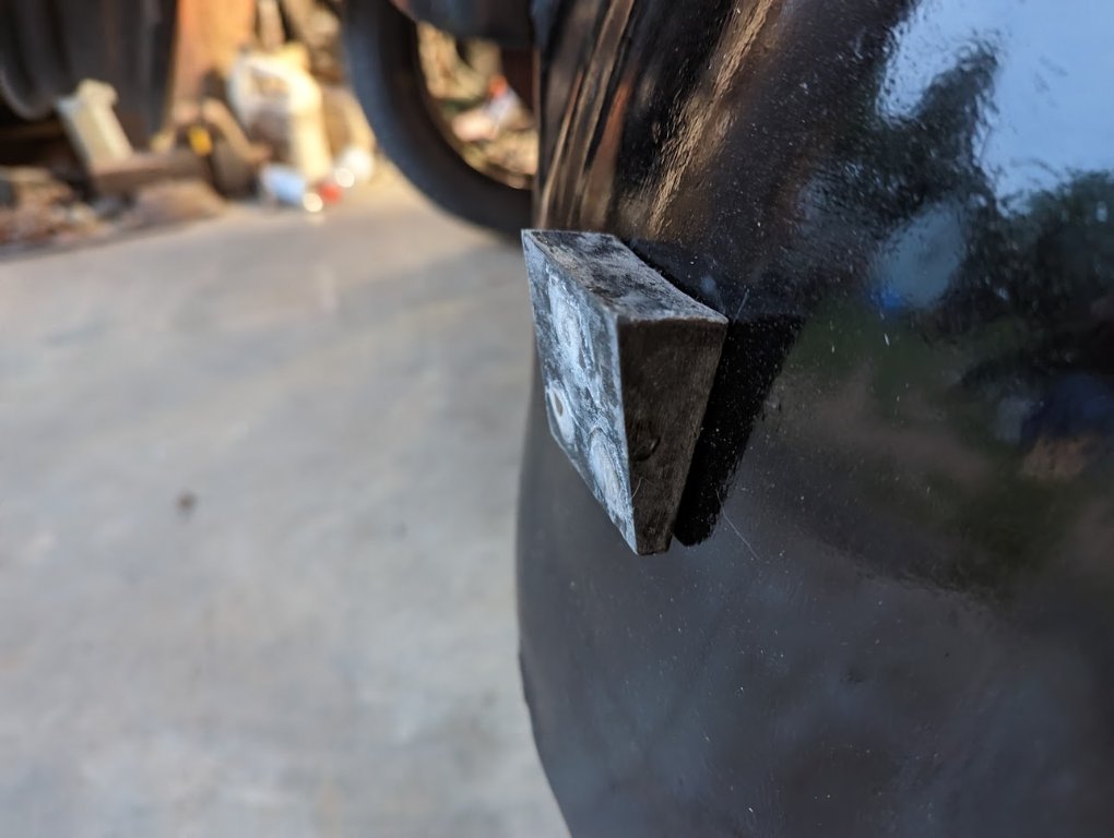

I use them on my roadster. I bought rare earth magnets and glued them to the signals. They work great and it allows my wife and daughter feel better when I take my granddaughter for a ride. They make me feel safer because many of todays drivers take a left turn hand signal as an invitation to pass me instead the correct meaning.
I find that they last for a few trips but don’t hold a charge if I leave them unused for a week or so. They come with a charger that does all 4 at once, but not the controller, it needs a separate cable to charge.

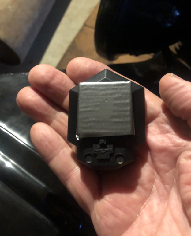

I have been using those wireless signals for months now. They work great!
I also added strong magnets to the back of the signals and dremeled off the protruding plastic square on the back. I added duct tape to the magnet to prevent scratching.
I did the same to the controller and stick it on the firewall in front of the steering wheel.
The signals work well but need to be charged periodically.

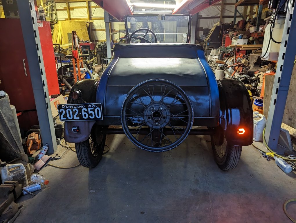

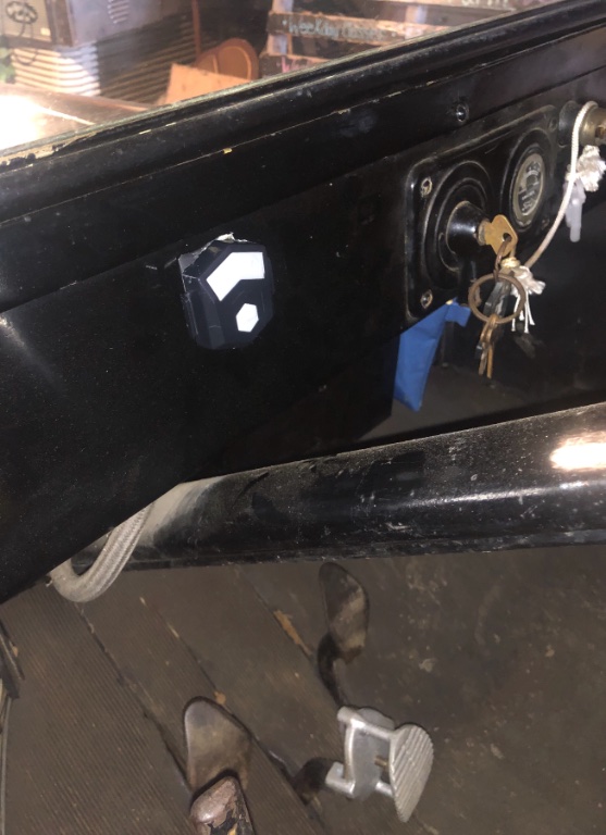

Here are some pictures of how I mounted the bicycle lights on my 1926 Roadster. The front and rear wedges are 3-D printed with a curve to fit the fenders. They have recesses for the six magnets, three to attach to the fender and three to attach the light to the wedge. I will be attaching cloth to the wedge to keep it from scratching the body.

Robert, They look great. Will do the Steering mounting like you did. Will look for magnets!

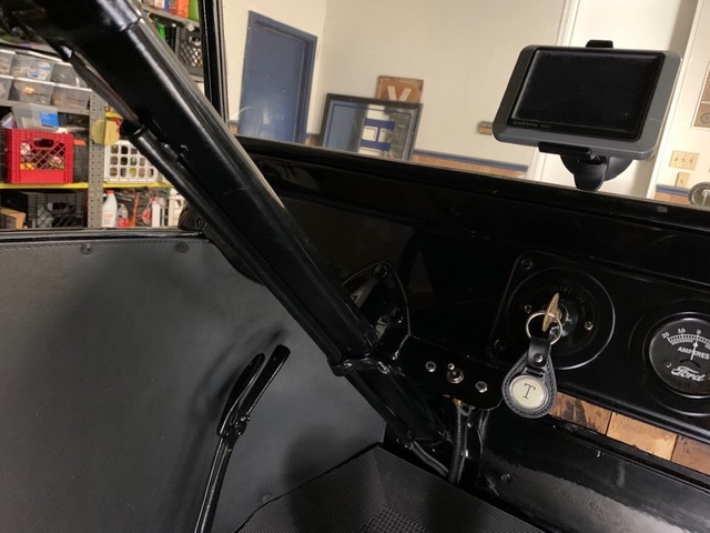

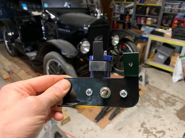

Just wanted to show a wired version I made up for my ‘23 Touring. I made a bracket that uses the bolt on the steering mount and screw that holds the lower left corner of the instrument cluster so no modifications.
The blinker unit is on Amazon for around $8 for two, the signal indicators and switch off Amazon as well.
For lights I found some glass turn lights at a flee market. Makes a nice wired kit and plenty bright and runs off electrical system so no battery worries.
