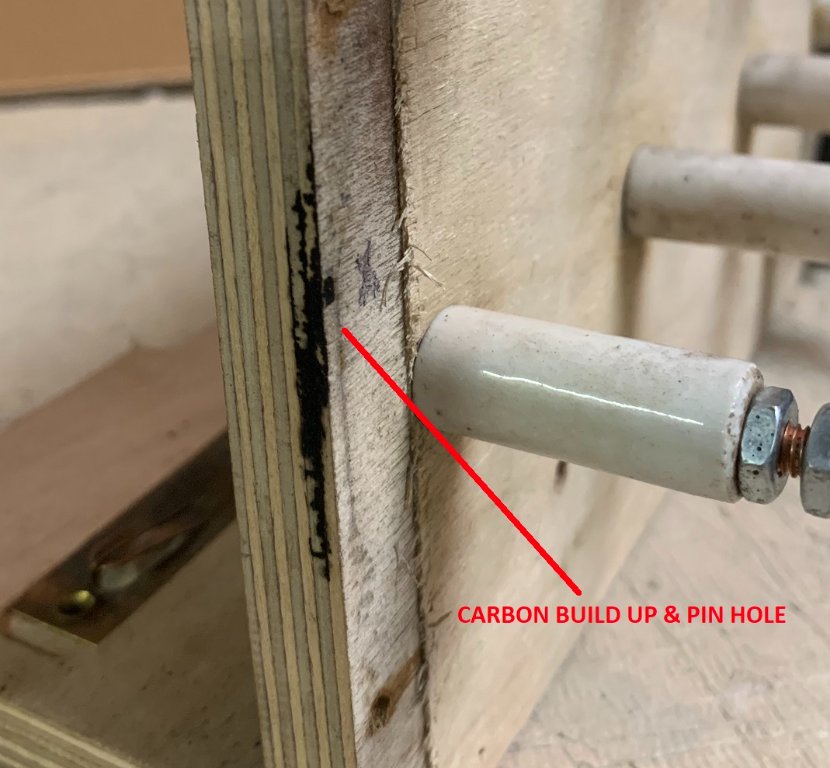

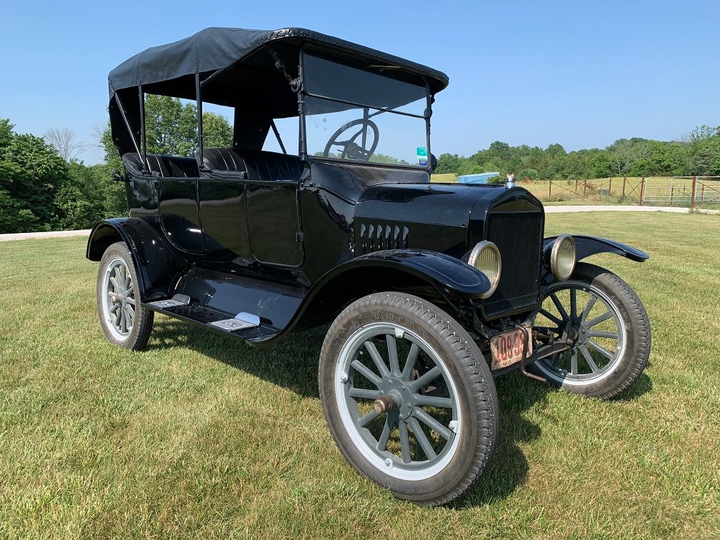

First thank you Joe Bell, better known as ‘Engine Joe’, for your help with the final diagnosis of my ’21 Touring electrical problem! Last Saturday, after spending almost a year out of commission, I decided to carefully wash it, wax it, and take it for a drive. After the wash, it would only run on #2 & #3, but all four coils were buzzing. I called Joe and his advice was to check and see if the spark advance rod or something was arcing to the #1 & #4 commutator posts. Instead, I discovered tiny sparks arcing to the coil box metal on both sides…from the wood! I took it apart and found that the arcing had created a thick path of pure carbon on the wood on both sides of the box (see below). A little rust staining on the wood might have also contributed. After sanding the wood, I further discovered black pin holes at the edge of the wood that extended through the wood to the #1 & #4 electrodes. After sanding, I cleaned out the pin holes and rubbed a heavy coat of silicone on the two edges of the panel followed by a wrap with two small strips of sheet-pvc over the wet silicone. The problem likely began after the bath with moisture getting into the coil box wood. Aside from having to do a sponge bath in the future, doe’s anyone make a plastic board assembly for the Coil Box?

Tom.... Bring up coil box parts on your supplier website, and there are plastic versions for your coil box. The condition you found is called " carbon tracking " . Be sure that you put your coils out in the Sun for them to dry out thoroughly and then follow with a coat or two of boiled linseed oil for further moisture protection.

Thank you for posting your experiences and the photos! A lot of folks don't realize that the arcing can occur internally, between the layers of plywood.

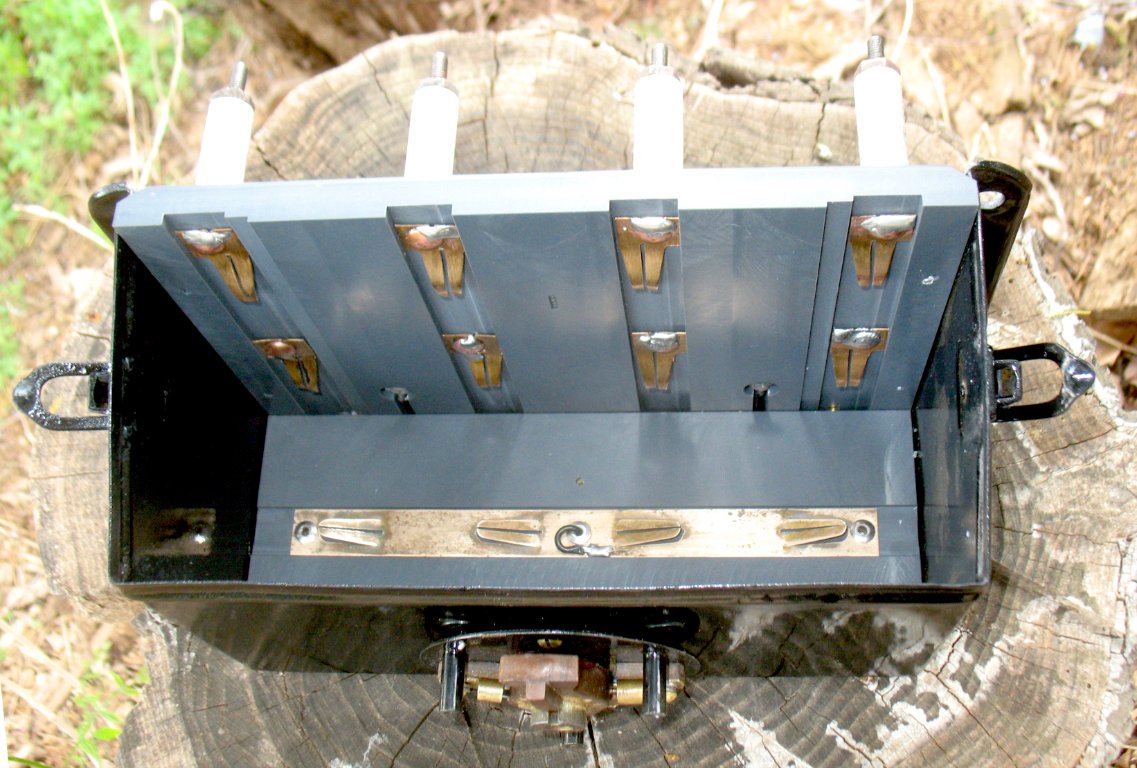

John Regan's Fun projects kit:

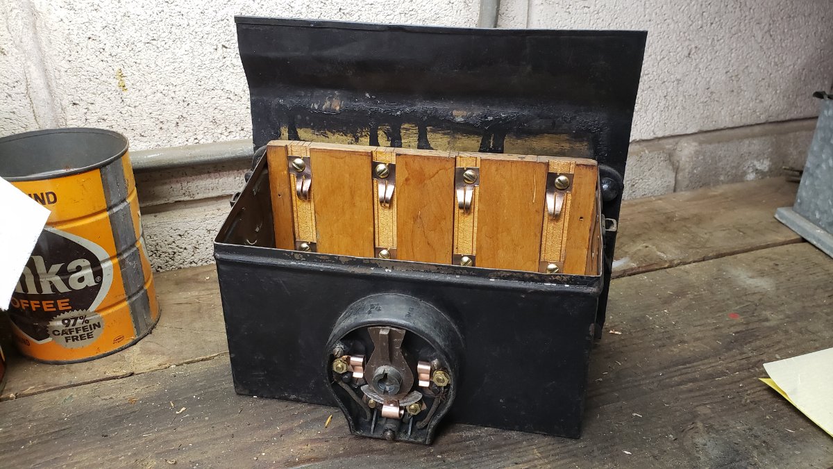

Post by Moxie26 » Mon Jun 19, 2023 9:29 pm
What you have there is a newer wood coil box replacement..... you should really reconsider getting the non-conductive plastic panel sections so that your past problem does not repeat itself. If you consider using the wood coilbox panels, they should be coated with at least three layers of boiled linseed oil before any hardware is attached to the wood. The boiled linseed oil will seal out any entrance of moisture into the wood for a given time period of a few years when used on the coil box wood and plus the four individual coils.

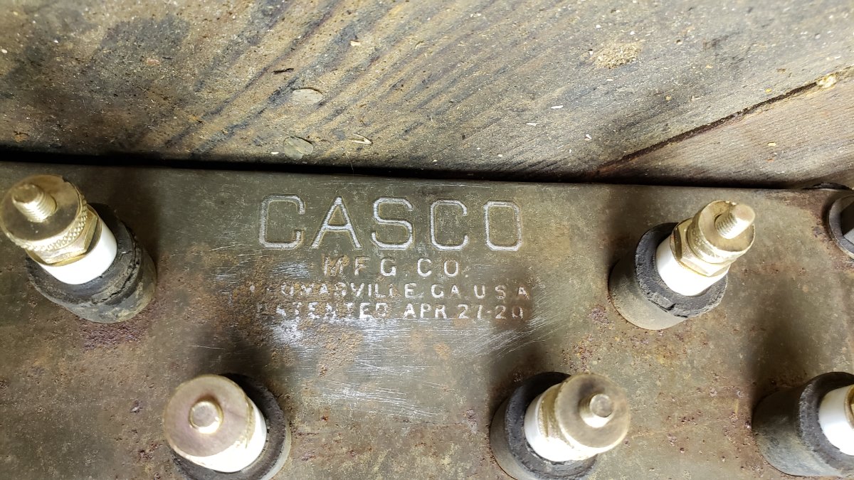

One can also utilize this unique Casco accessory to keep the water out... have this on my T, and although hidden, it gets the job done woth shield and rubber grommets.

That Casco is very cool Andrew.
