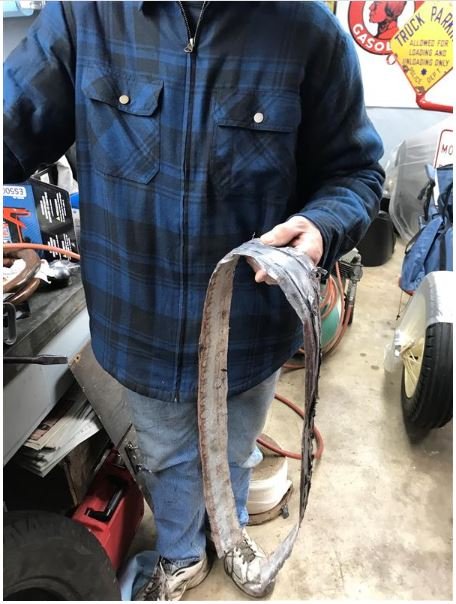

Re: rim strips vs rim tape
Here-s what duct tape does in a wheel long term.
I've had the same result with Duct tape - a bad solution, and I've peeled the stuff (actually it fell off) the inside of wooden wheels. Also I've had tubes want to bind on the stuff, and a couple even tear - I used to use it on touring bikes, but after a couple failures like that, well, on a motorcycle that's not a happy result!!! IF you can get rim bands that's best (and yes, I forgot about cutting them from an automotive tube, wich is a good trick)... I ALSO carry one of those small squeezy botles of J&J Baby Powder (can you still get that, or has it been banned yet??) and believe in liberally talcing tires and tubes.
