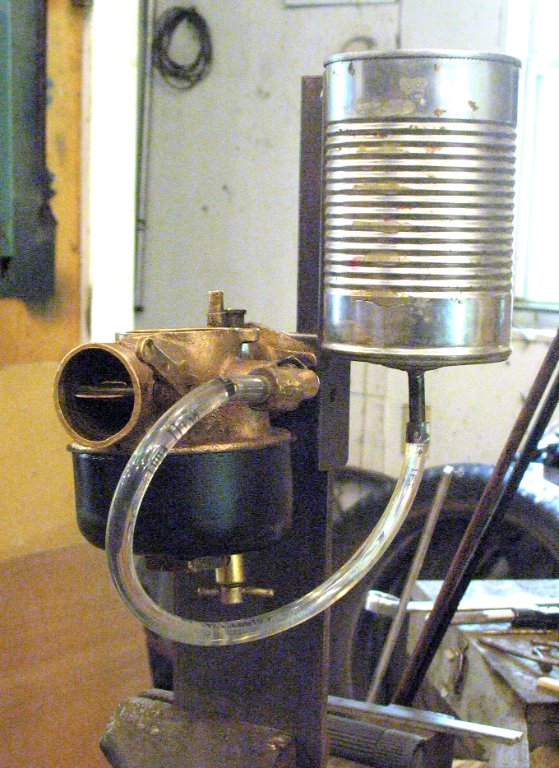

Setting the float level is best done on the bench. The MTFCA Carburetor book tells you how.
Home made level setting tool. Crudely made, but it works.

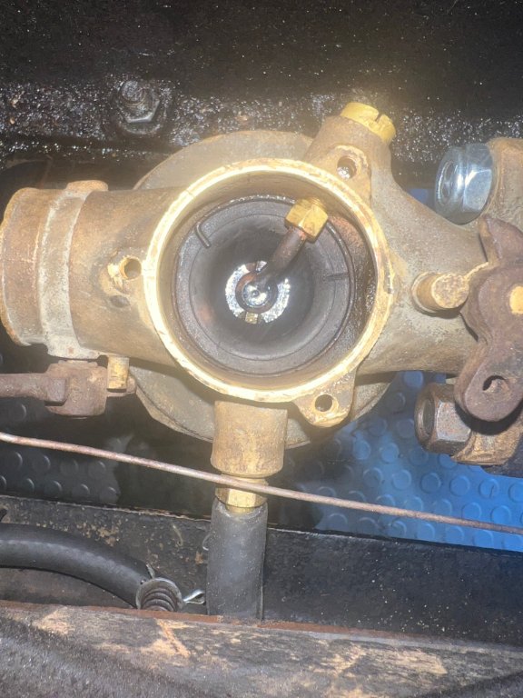

Thanks for all your help so far! I decided to take off the needle valve and see if there was any fuel in the upper bowl, and there wasn’t any! It seems the float is set too low, I will try to just bend the float lever up first to see if that fixes things. If that is unsuccessful, I may try to trim some float off. Thanks again for all your help!

Here is a photo of how the upper bowl looks now with no modifications.
- Posts: 6725
Re: Holley G carburetor running poorly, and on half choke.
can't see much, but if the idle pickup is submerged in fuel and fuel height is not so high as to be flowing out of the (hidden) overflow pipe, then you've got it.
Skyler Kimball
Topic author - Posts: 37
- Joined: Mon Jan 07, 2019 9:15 pm
- First Name: Skyler
- Last Name: Kimball
- * REQUIRED* Type and Year of Model Ts owned: 1916 Model T Touring
- Location: Waterford ME
Thanks, it is now submerged, and not leaking out the overflow hole. Timing is another issue I should discuss in another thread…
