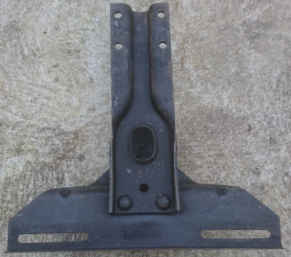

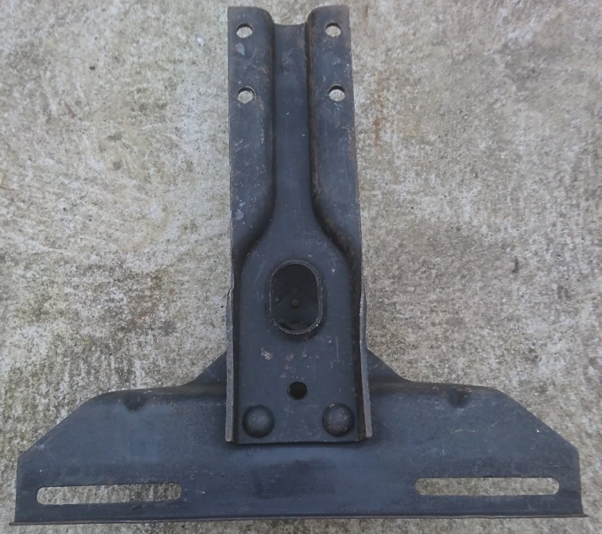

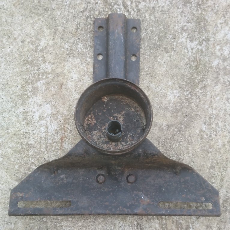

Hi all
I'd like to positively identify this tail light / license plate assembly. Its in Australia, so if it came here in 1926-27 its likely a Canadian part. The drop arm looks like the standard US part for a 1926-27 roadster-pickup. The license plate holder and light body look like standard Canadian 1926-27 parts. Its a factory assembly - the rivets have not been messed with. Is this particular combination for a 1926-27 Canadian pickup? TT maybe?
Andrew
Andrew

Re: 1926-27 rear light / licence bracket - Canadian?
Looks similar to ' 26- '27 TT - USA applications
T roadster pickup!! I have one exactly like it.
Thanks Bob and Les.
Yes - seems similar to the TT assembly but with a different license plate holder.
Les - am I correct in assuming Canadian roadster pickup?
Does anybody have a photo of one on a car?
Andrew
Andrew

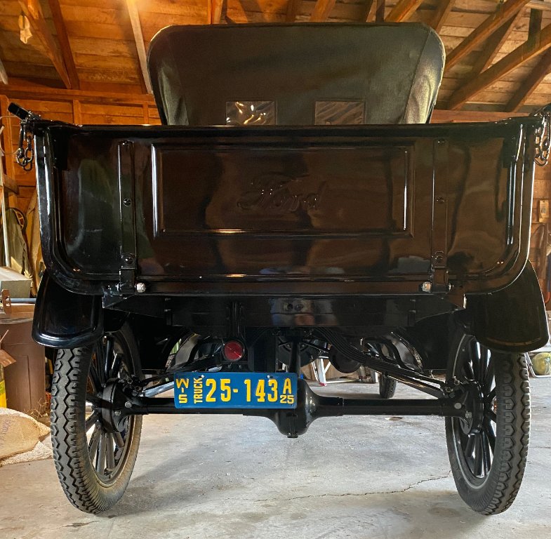

Scott C.
- Posts: 863
- Last Name: Clements
- Location: Waynetown Indiana

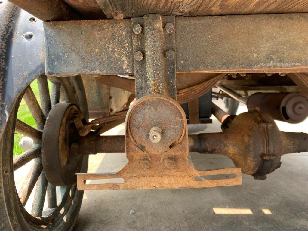

Here is a picture of the one my 25 RPU.
Scott C.
- Posts: 863
Here is a picture of the one on my 27.
- Posts: 3953
- First Name: Larry
- Last Name: Smith
Yeah, the mounting bracket is 1925-27. The license plate part looks like a very good rivet job.

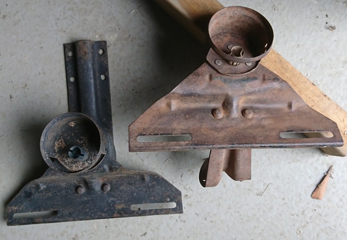

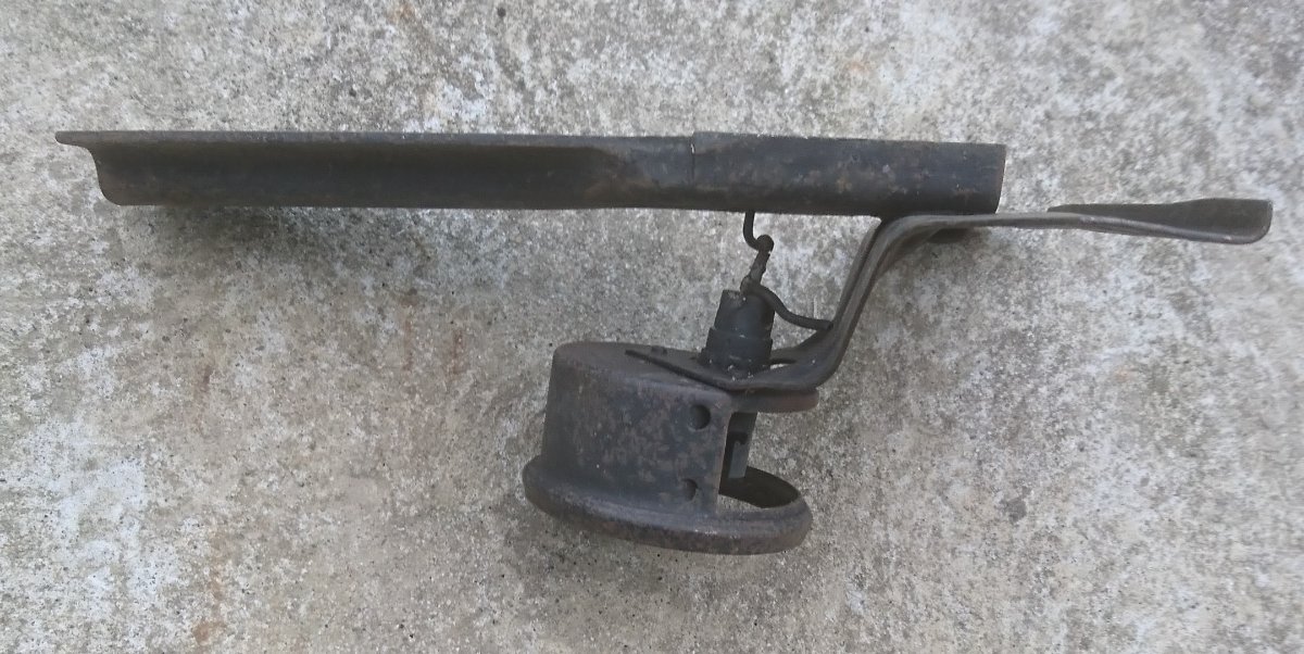

Andrew Brand
Topic author - Posts: 51
- Joined: Mon Jan 07, 2019 3:46 pm
- First Name: Andrew
- Last Name: Brand
- Location: Australia

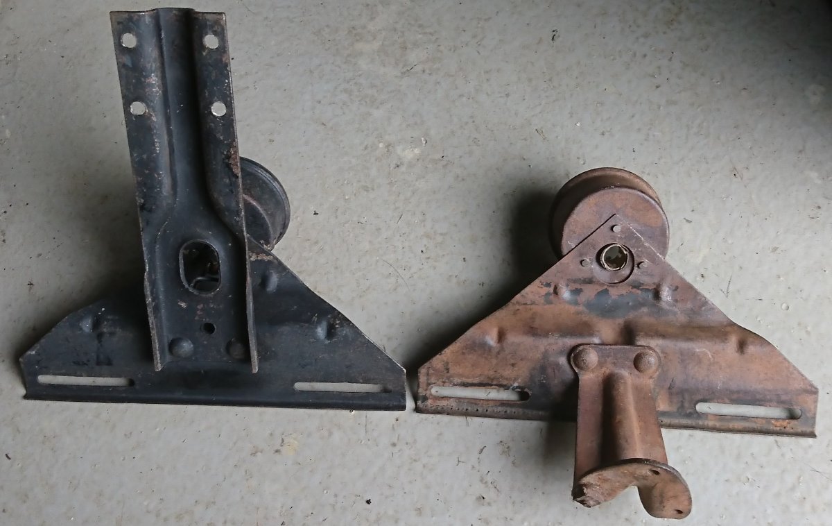

Here are some comparison photos showing the (apparently) Canadian Roadster Pickup assembly next to a standard fender mounted 1926-27 Australian (Canadian) assembly. Same license plate holder / tail light, just a different mounting bracket. Also an Australian ad for a "Light Delivery Runabout". In Australia these had a wooden tray - we didn't get the steel trays like US production.
Andrew.
Andrew.
