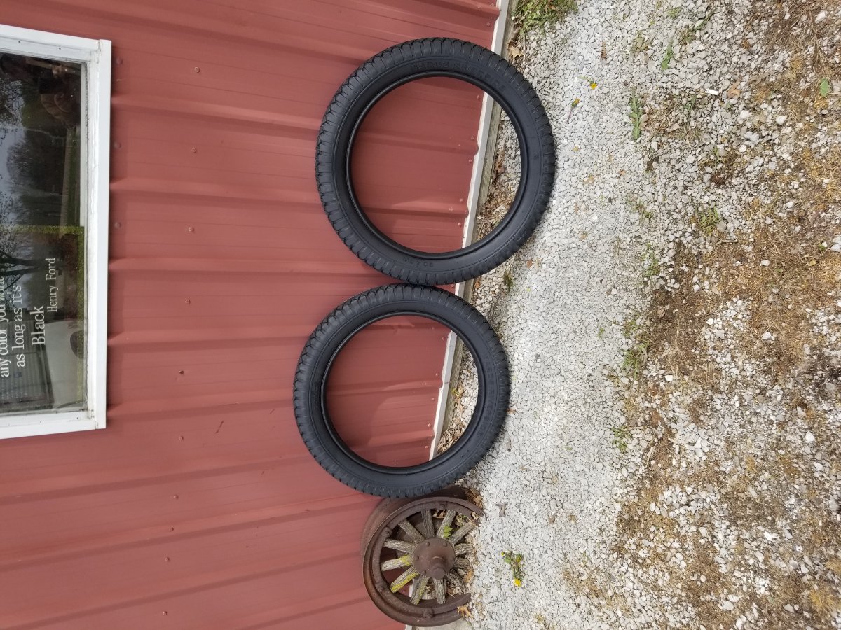

What are you doing with your "T" in May

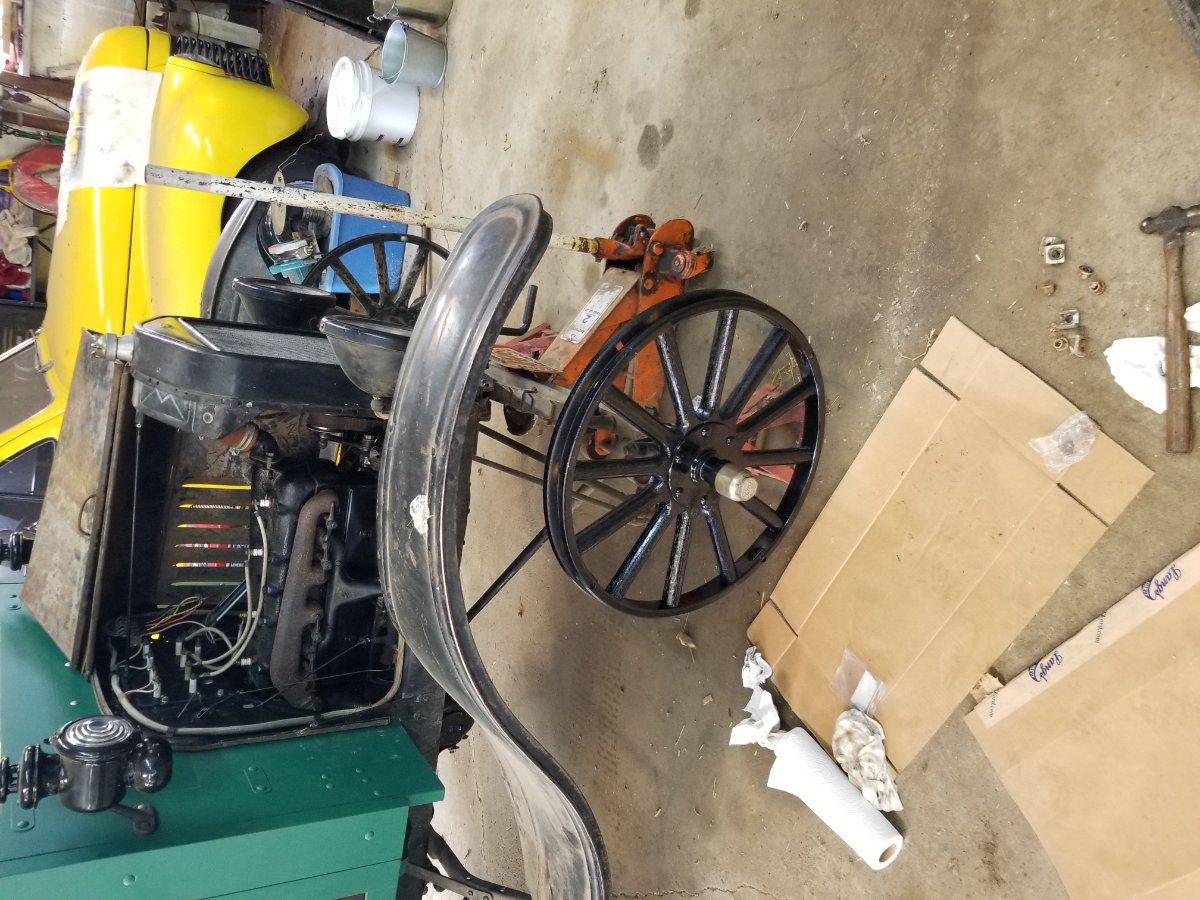

When the rain stops I hope to finish 'Lulubell'. I fell a couple of weeks ago and cracked a rib and then came down with the flu. I have to get her ready for the Kansas tour .

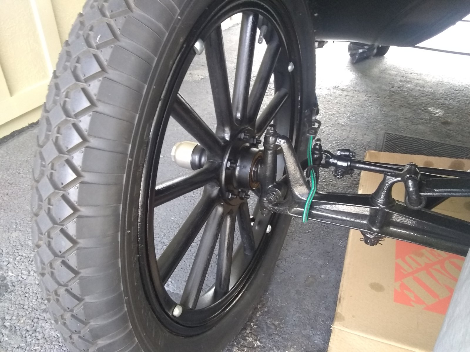

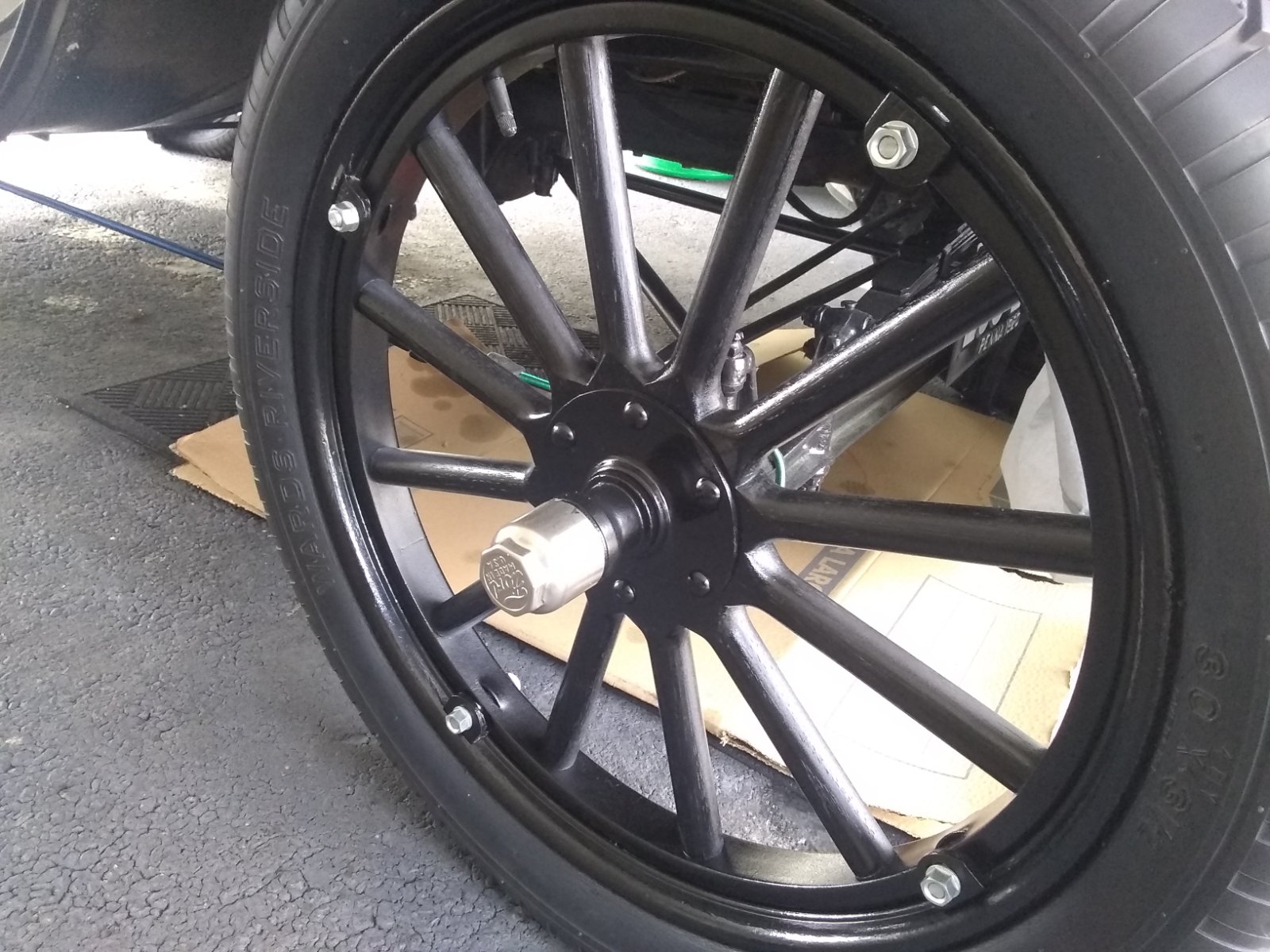

Re: What are you doing with your "T" in May
Enjoying the last of the wheel rebuilds.
Began last October. Done!

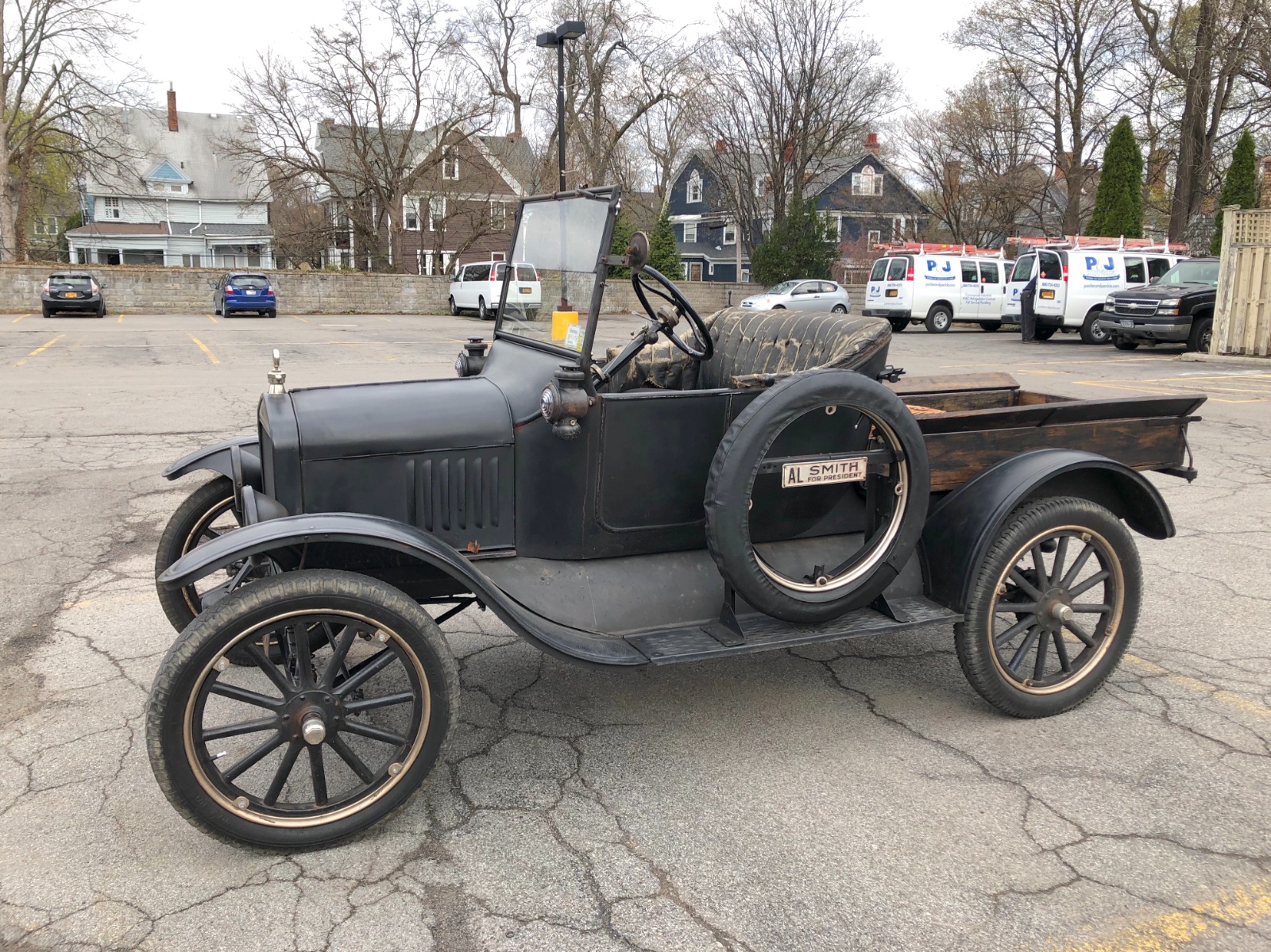

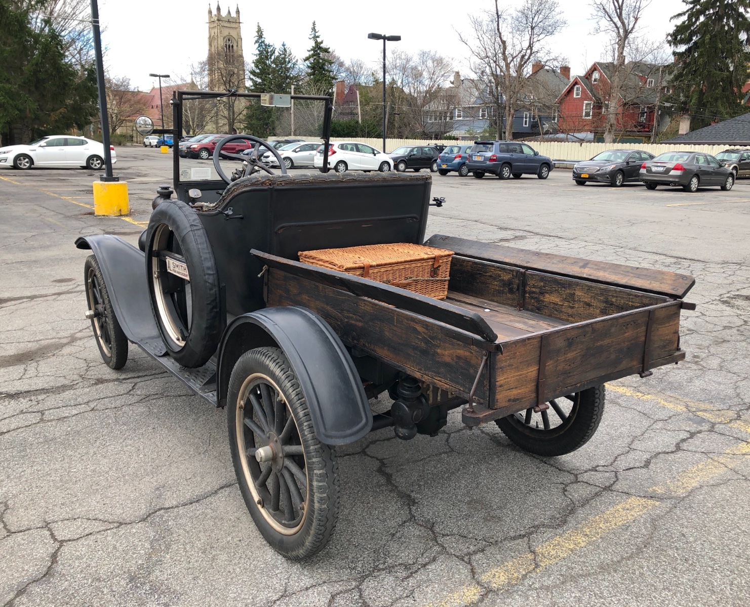

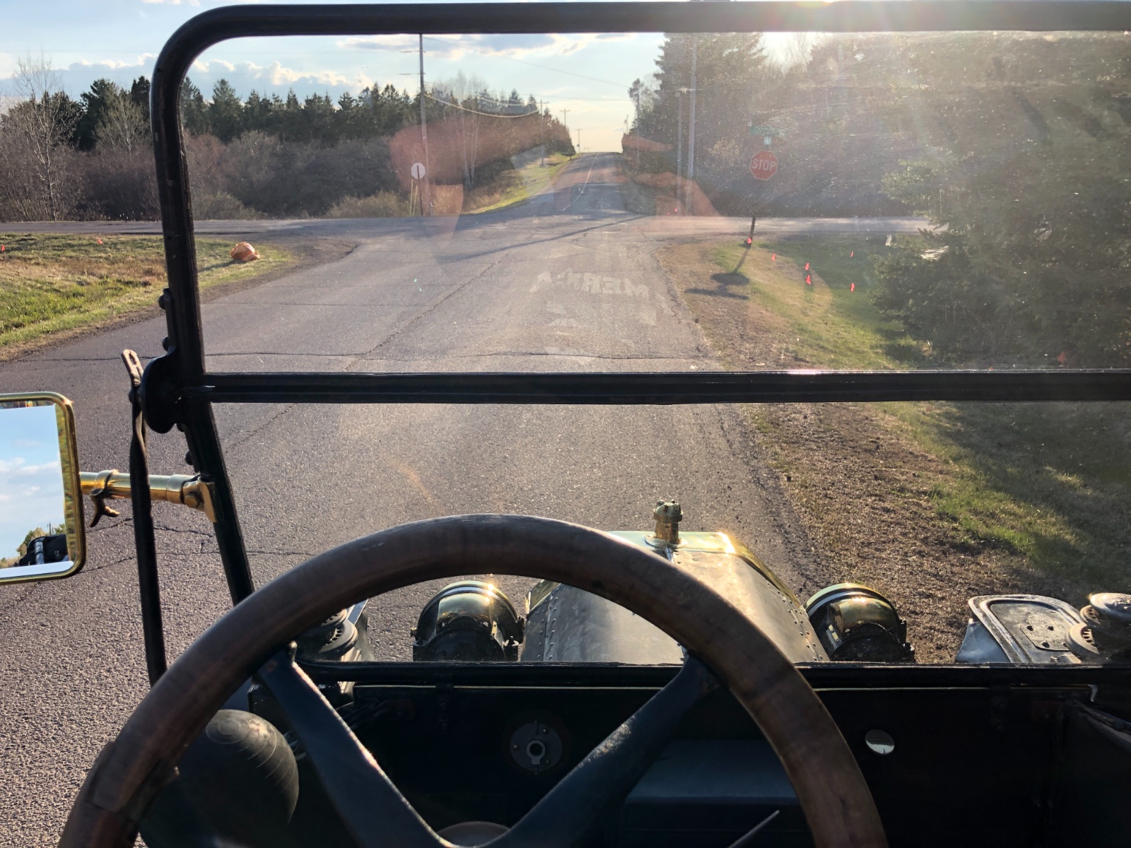

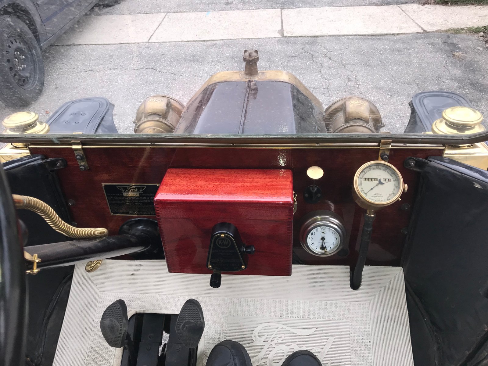

Now that the snow and salt are behind us in Rochester I’m driving the T to work every day.

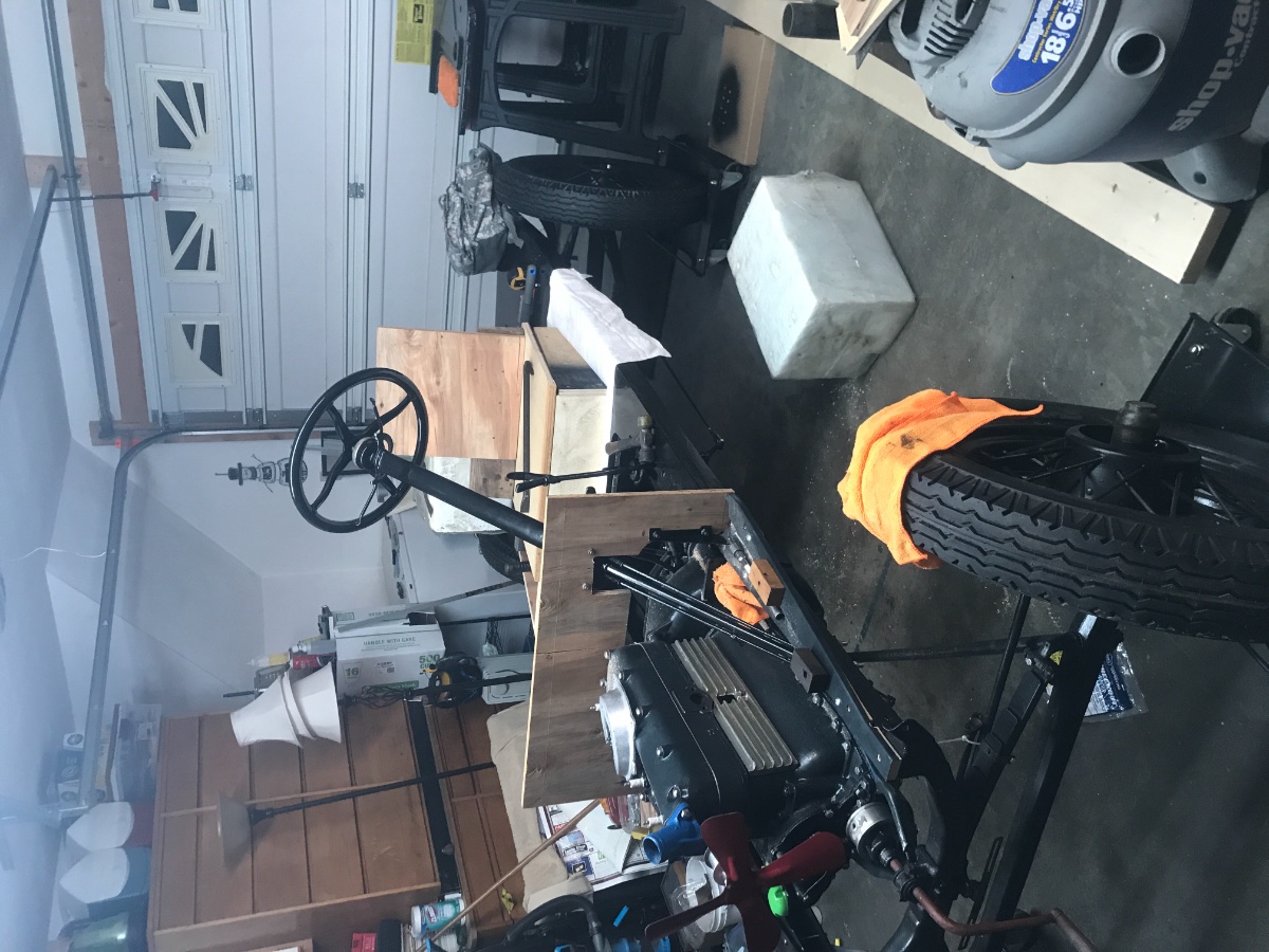

We're putting in new floors in the house and painting the whole interior....that's consuming a lot of time.
However, my goal is still to get the T running before the end of the summer. So I'm purposefully going to make some T time this weekend to move things forward.

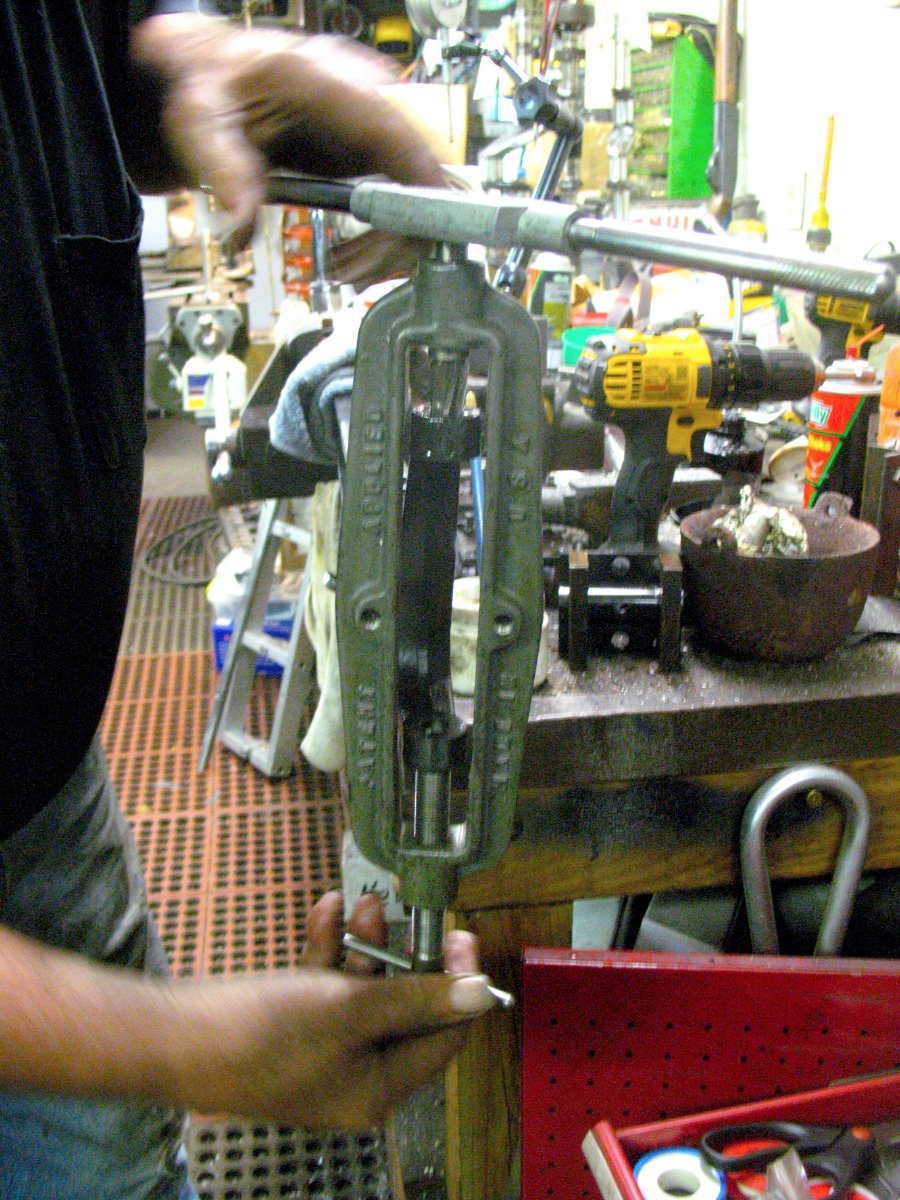

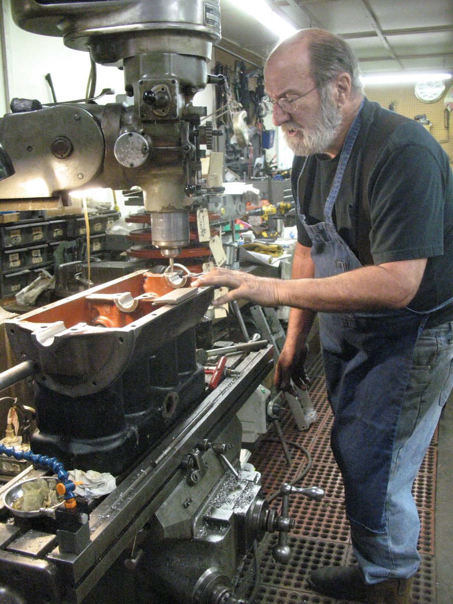

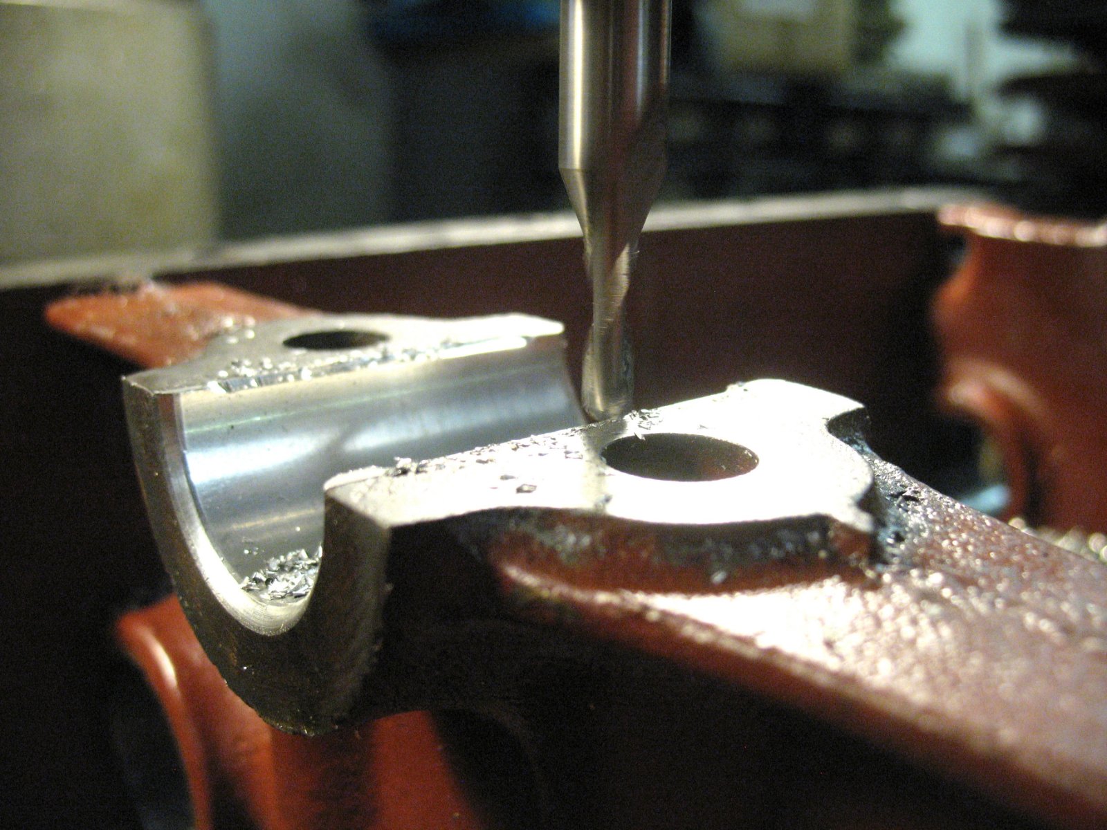

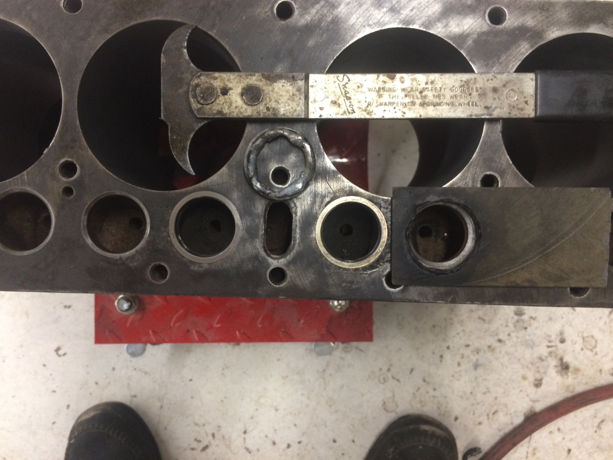

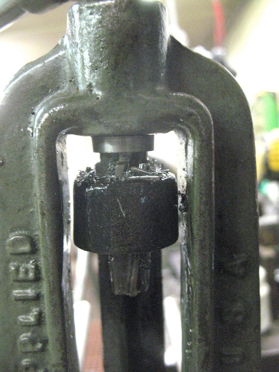

Bored 40 over, hard seat installed, valve and lifter guides reamed oversized. Babbitt comes next.

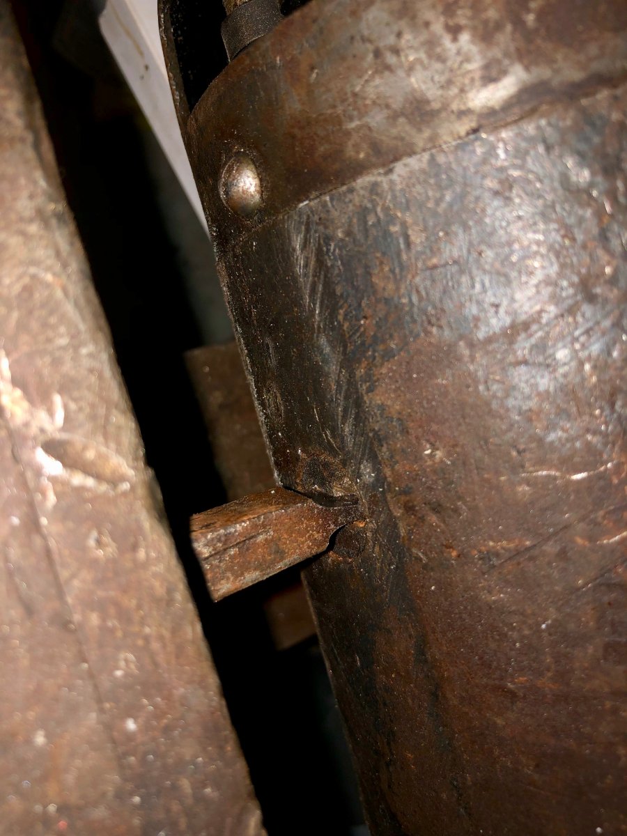

Brooks, now all you need is correct rims. The wheel you show is the type with the notch in the felloe at the bolt hole. it should have a loose lug rim which has the U shaped piece held in place by a flanged wheel nut. Fixed lug rims will go on, but they will not wedge on the felloe. The load is all on the 4 bolts.
The photo shows what I think is a Hayes lugged rim. It does not appear to go right to the back of the felloe, and looks like it sits well off the outside. This is caused by the 'foot' on a Hayes lug needing a relief in the felloe edge to allow it to go fully on. If this is the case, your is the lest desireable combination.
Sorry to dampen your enthusiasm, but it may become a safety issue, and should be addressed one way or another.

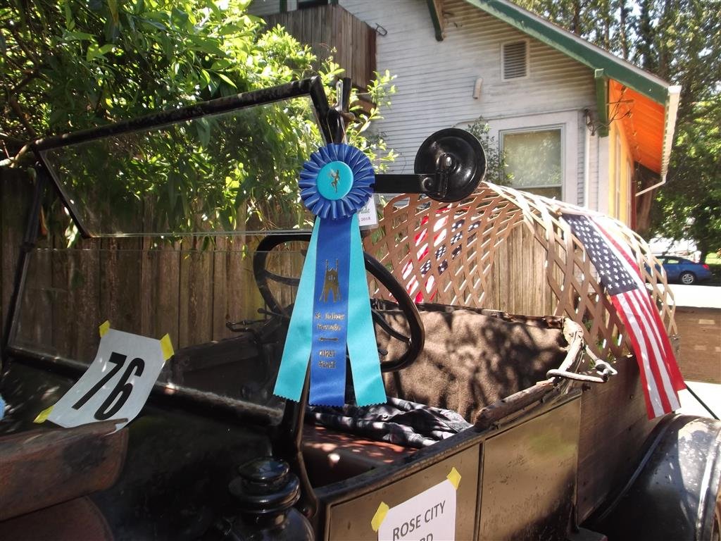

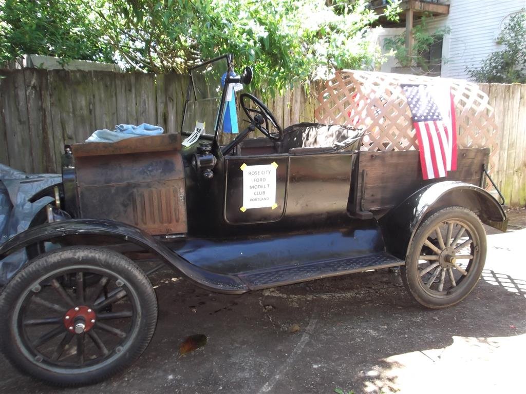

Today was finally a sunny day in Ventura county CA, took the coupelet to our local cruise night, she ran flawlessly.

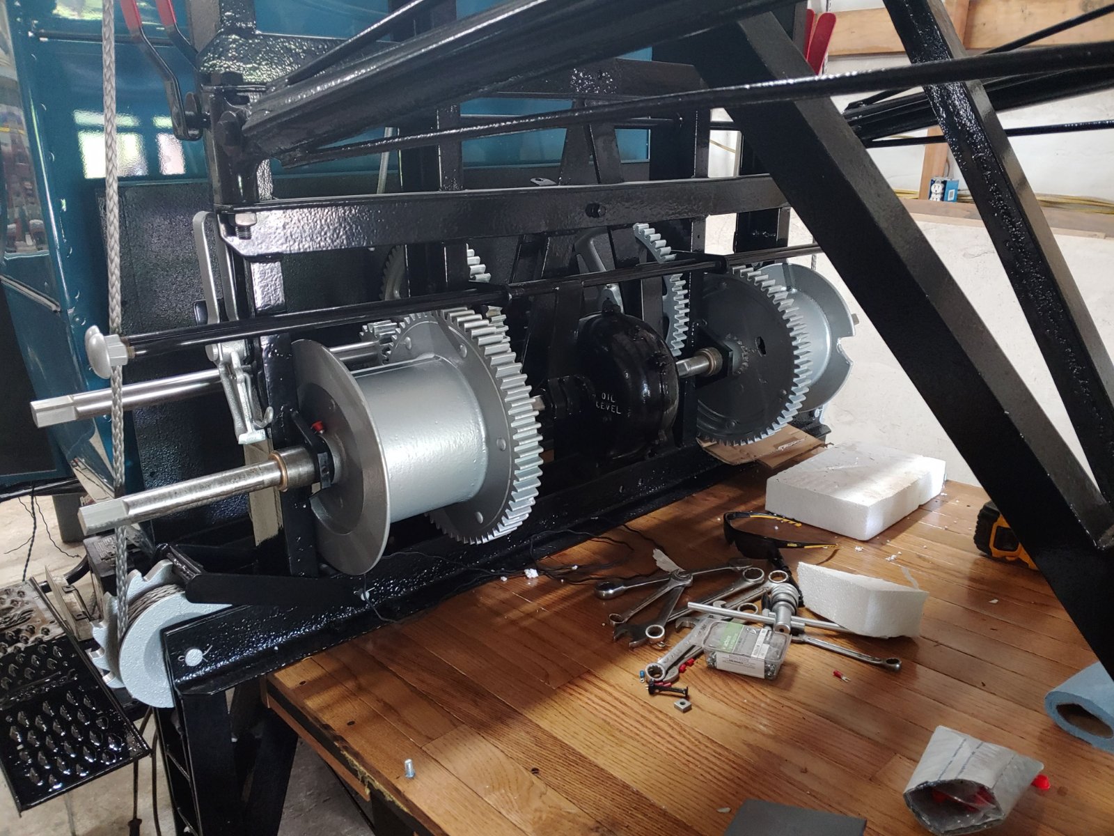

I threw some trash in my TT dump truck today.

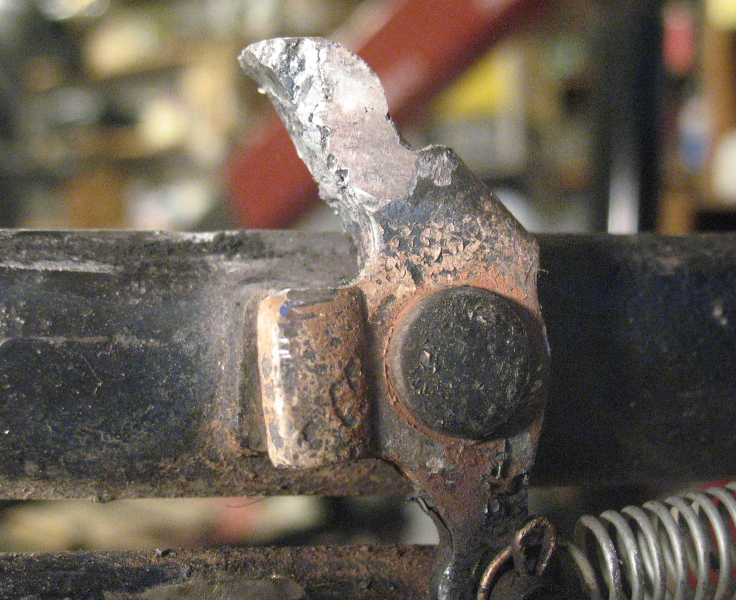

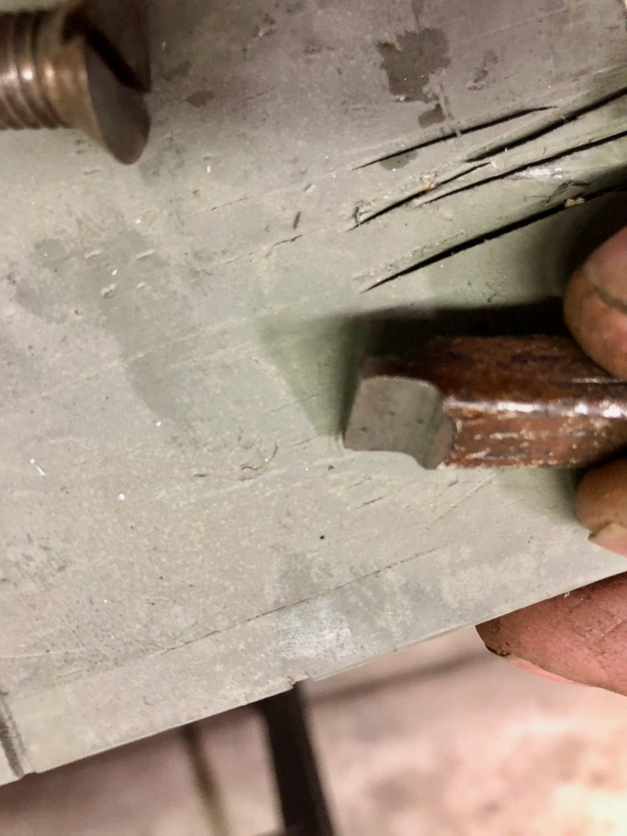

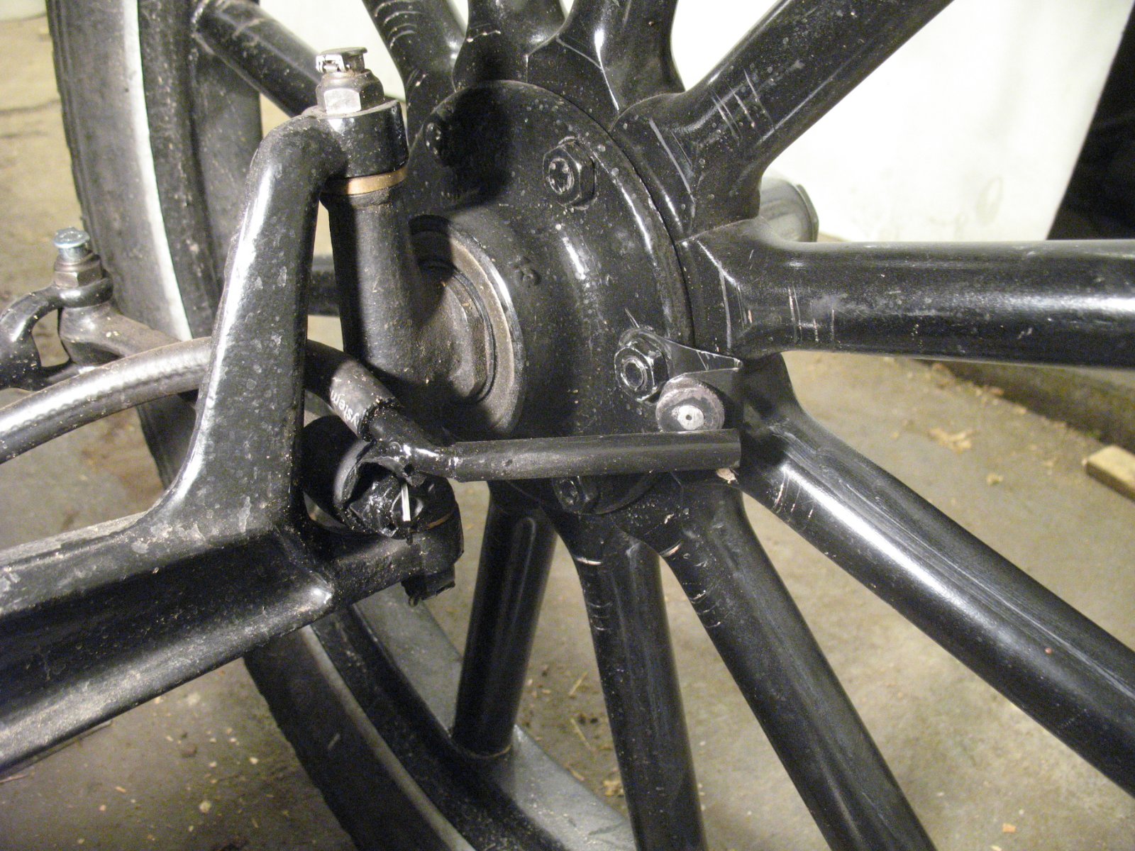

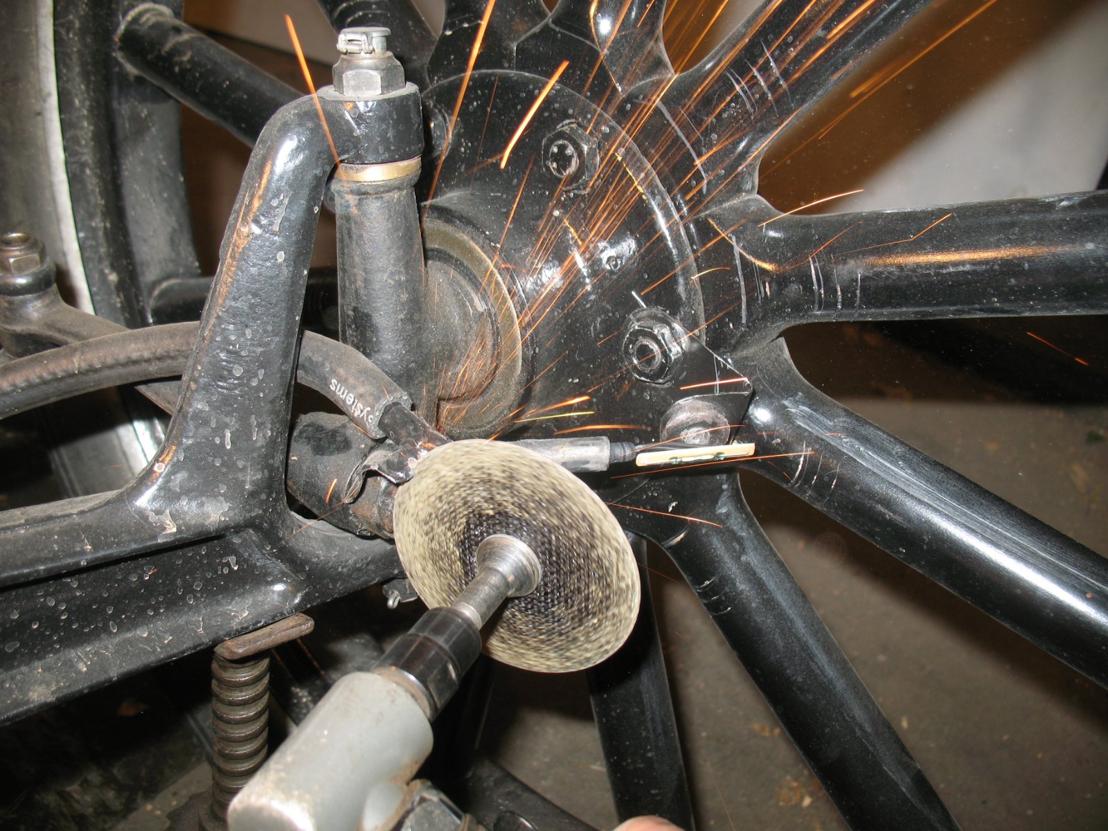

Yesterday my speedometer was skipping around to all sorts of crazy numbers (26, 52, 47, 19, 300, etc.).
I found that in a hard right turn the bracket holding the sensor was pressing against the axle. This forced the tube covering the sensor against the wheel (thus the scratches on the spokes), and the covering was now gone, with the sensor hanging loose.

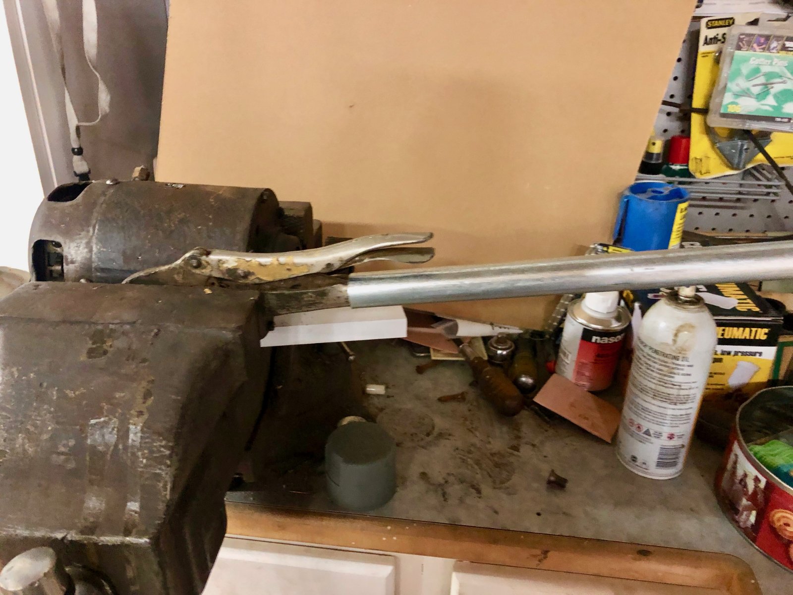

So today I narrowed the bracket so it wouldn't contact the axle....
...installed a new sensor cover (3/8" brass tubing), and sealed it with Ultra Black.
Later I drove up to the county seat to renew my driver's license (a round trip of 37 miles), and the speedometer worked perfectly. I checked it against the "Your speed" sign in Winfield.

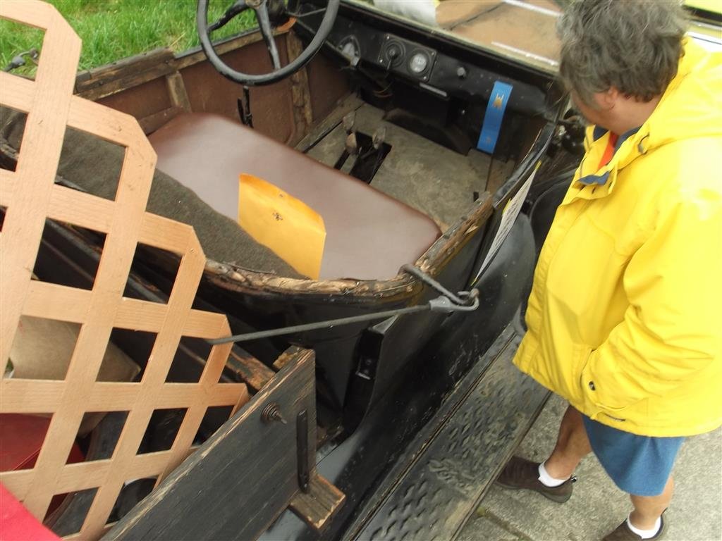

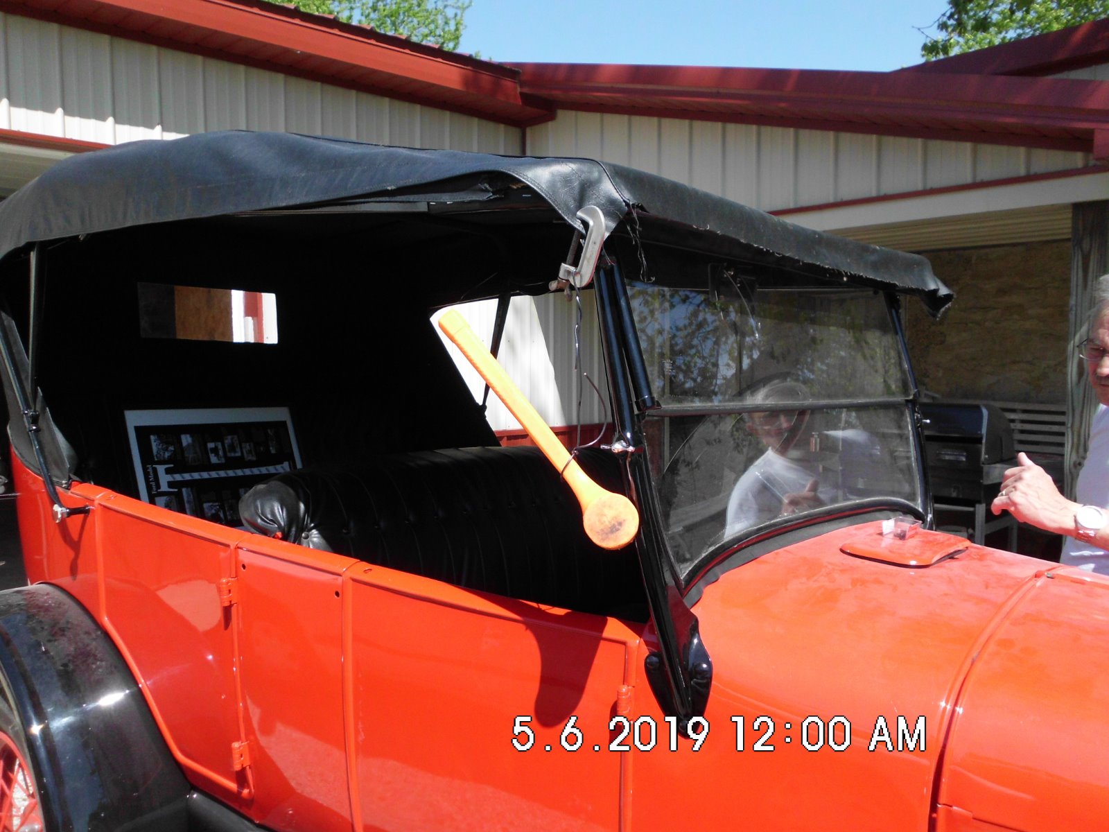

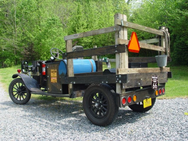

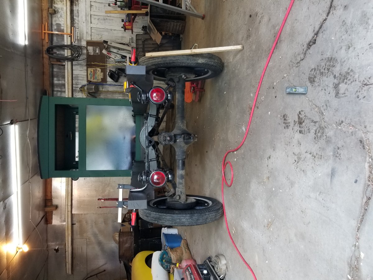

I got Ellie Mae's rear gate on...
- Posts: 7413
Hauling livestock, Tom?

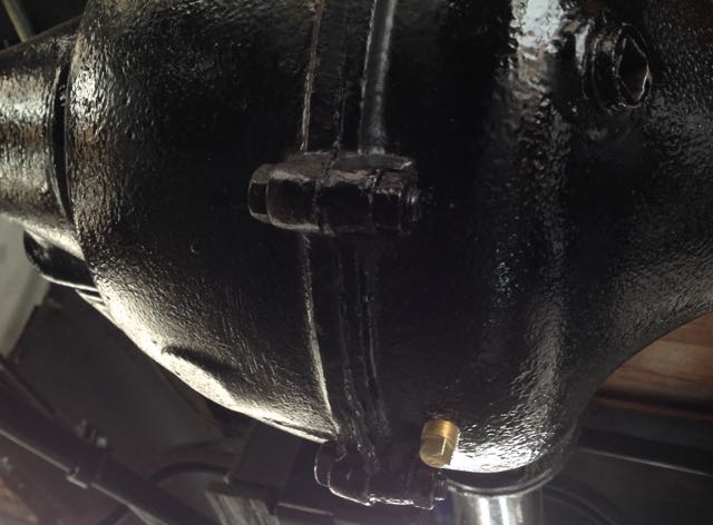

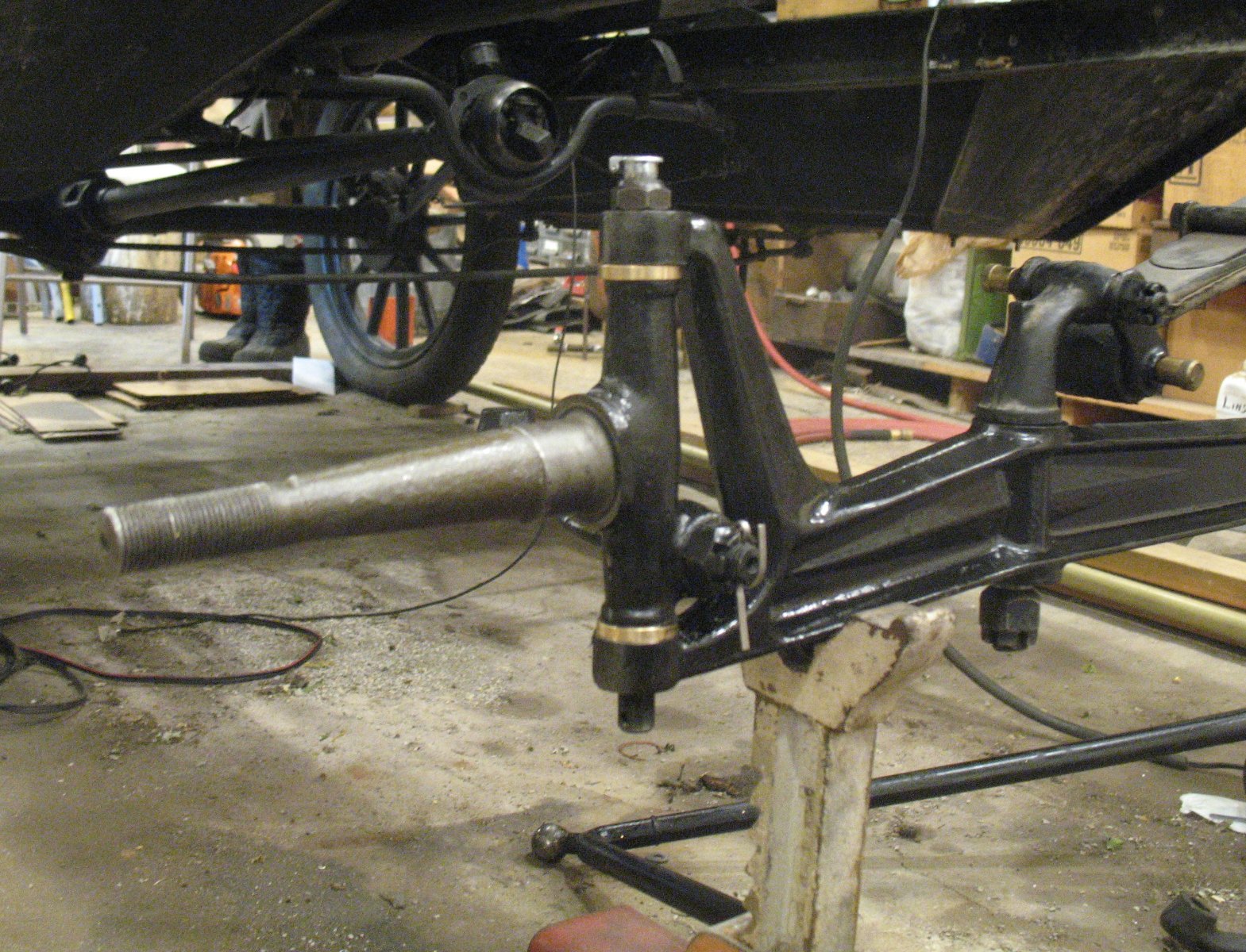

Drilled hole in right differential housing and tapped for 1/8”- 27 pipe thread and installed 1/8” brass drain plug.

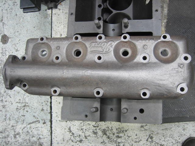

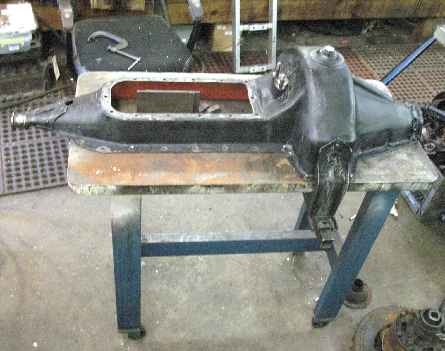

We just this one cleaned.Believe it or not no cracks for a 1915 engine.
Surprisingly in good shape.
- Posts: 6821
Michael
very nice!
and welcome!
very nice!
and welcome!

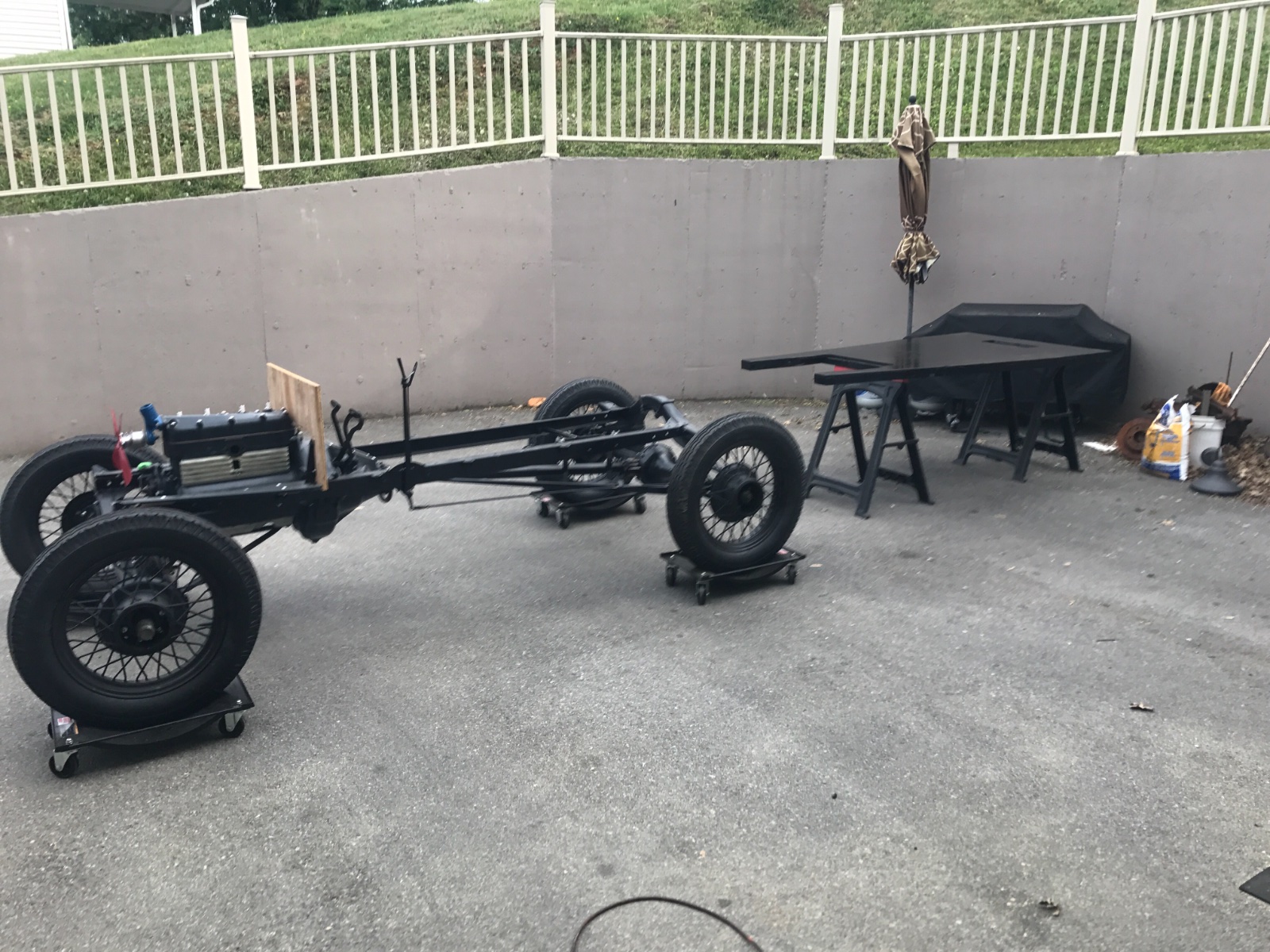

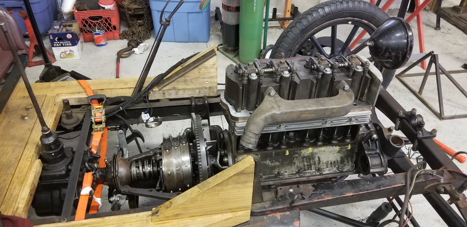

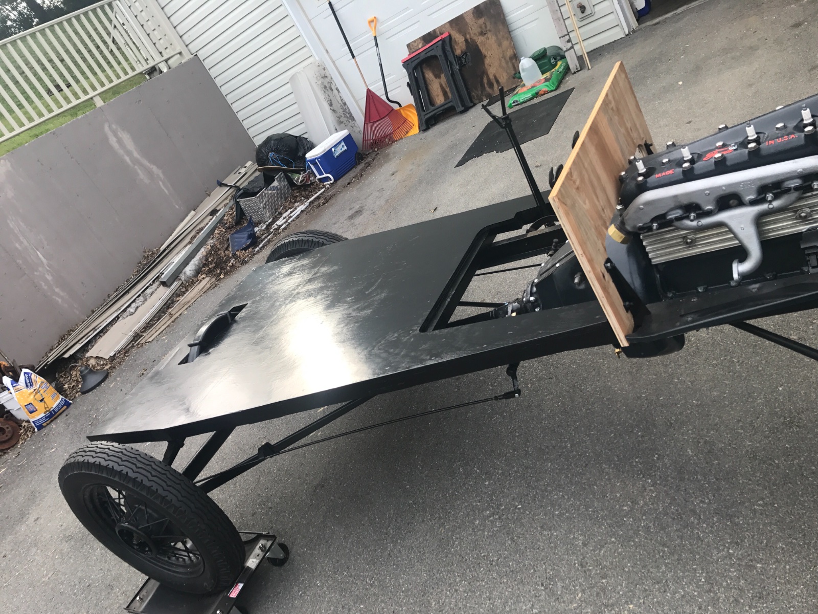

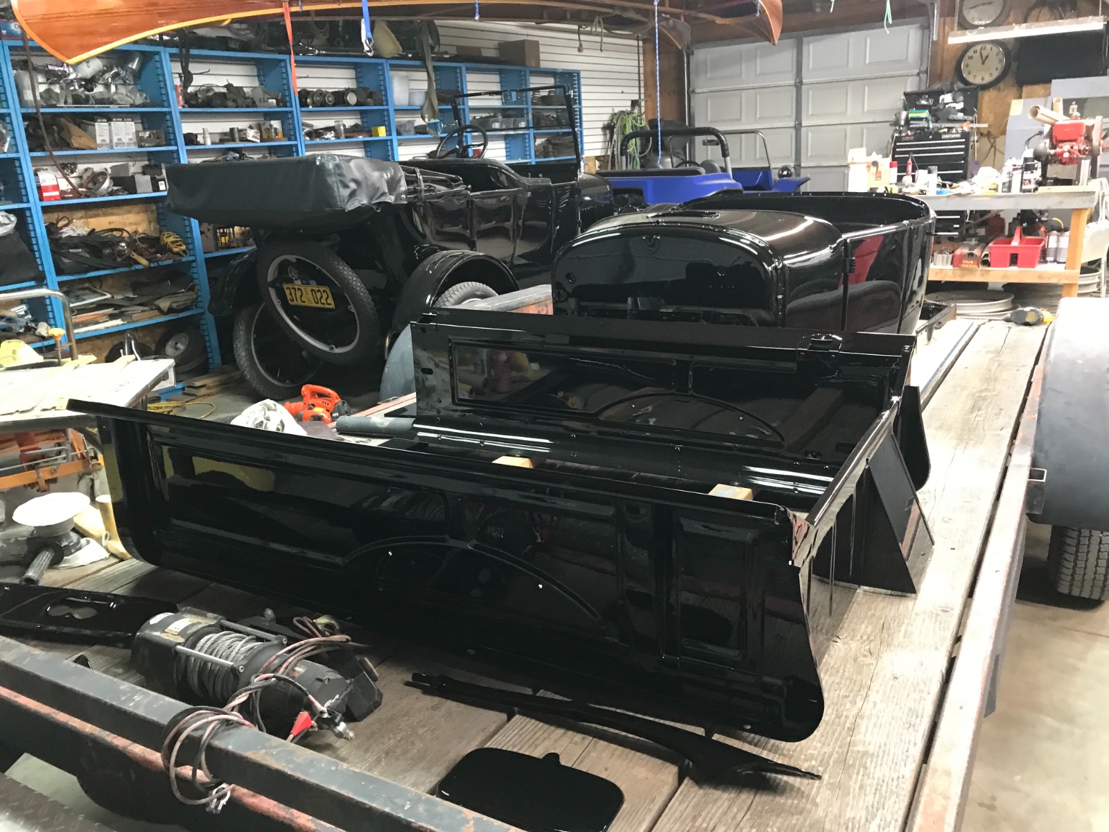

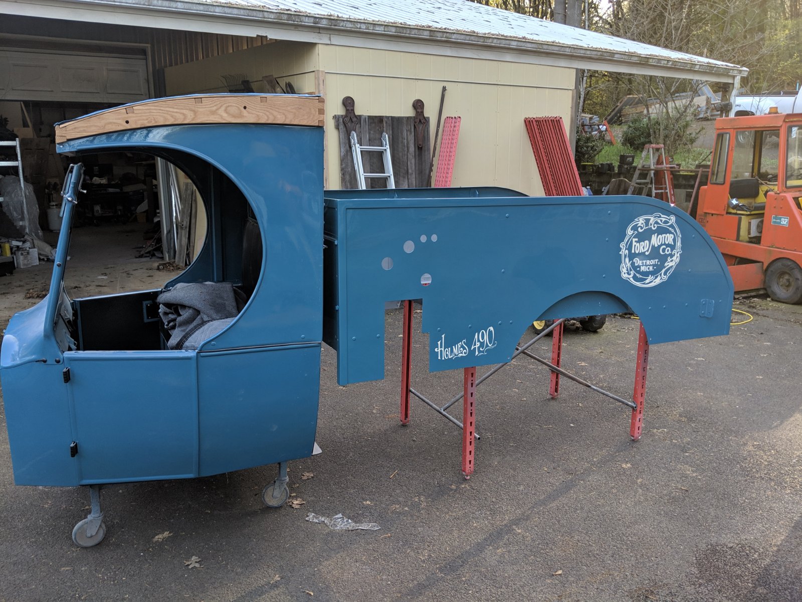

Got the speedsters body partially mocked up! Summer here we come!

Installed the correct style coil box in my early '13

Took a fellow for a ride today, who's building a 24, but not a lot to experience driving one. He was asking questions about the Ruckstell, "show and tell" is easier and way more fun !!
After setting the toe correctly and the spindle being tight...straight down the road. I even let go of the wheel for 10 seconds or so !!
(I don't recommend or condone this behavior)

Started this morning with this
After a wrastlin match I had this
Then the next logical step was mounting these
And wound up here
Now I getting rear wheels ready for paint on the TT

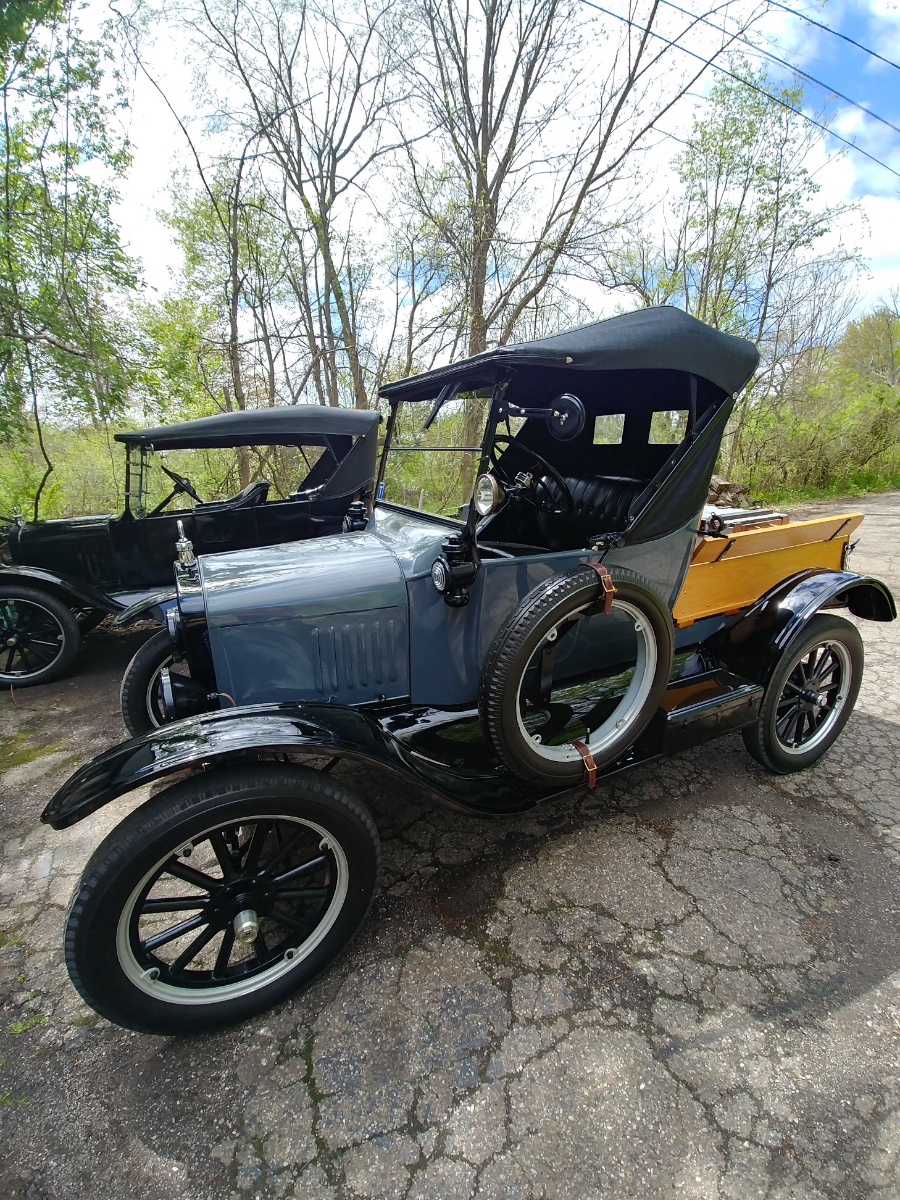

Brought a friend over for my T to visit with, same age so they hit it off good.
I let Bill borrow my headlight adjustment tool as his right one was coon hunting in the trees !
Looks close now, but darkness is needed to be sure. Nice and sunny today.
Holding down the trash can, shootin the $h1t...

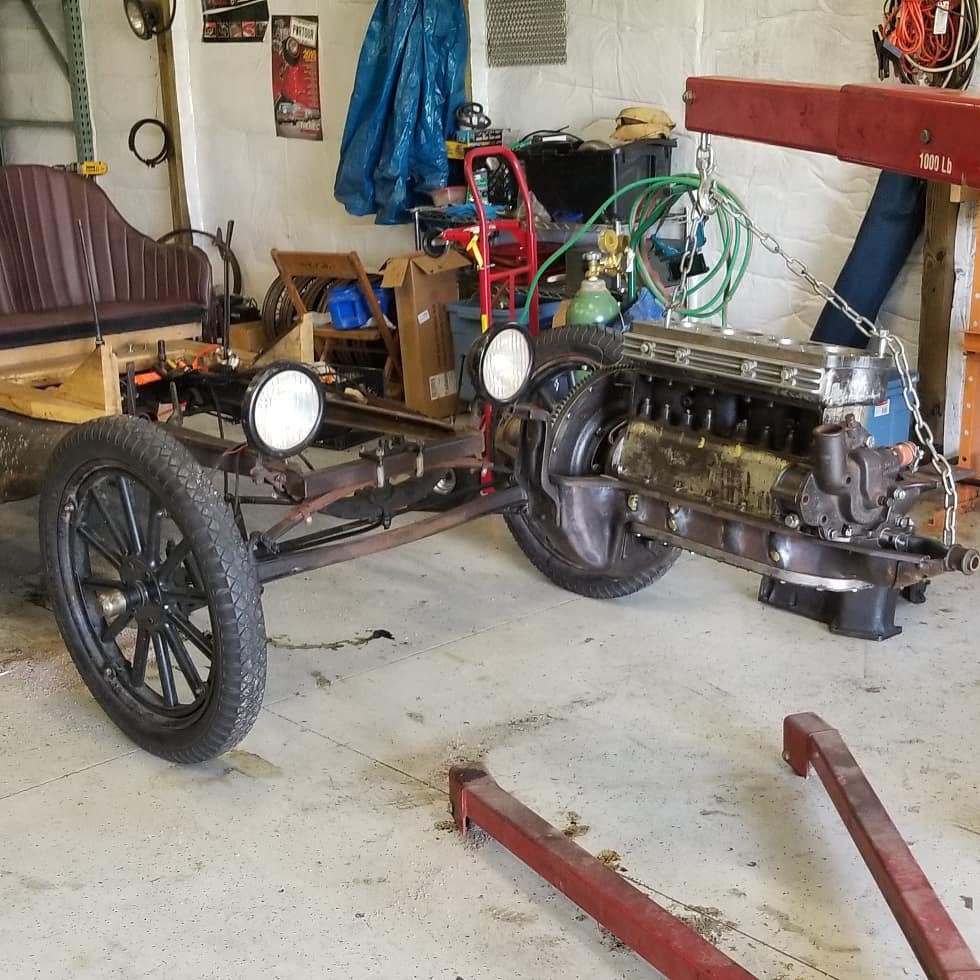

Finally got the motor into Virginia, my speedster. There hasn't been a motor between the frame rails since 2016. Life and other projects have gotten in the way, but the time is now!
Zoom zoom!

Picked up my 26 T Roadster pickup from the paint shop Friday.Im very happy with the results. Now the real fun begins!

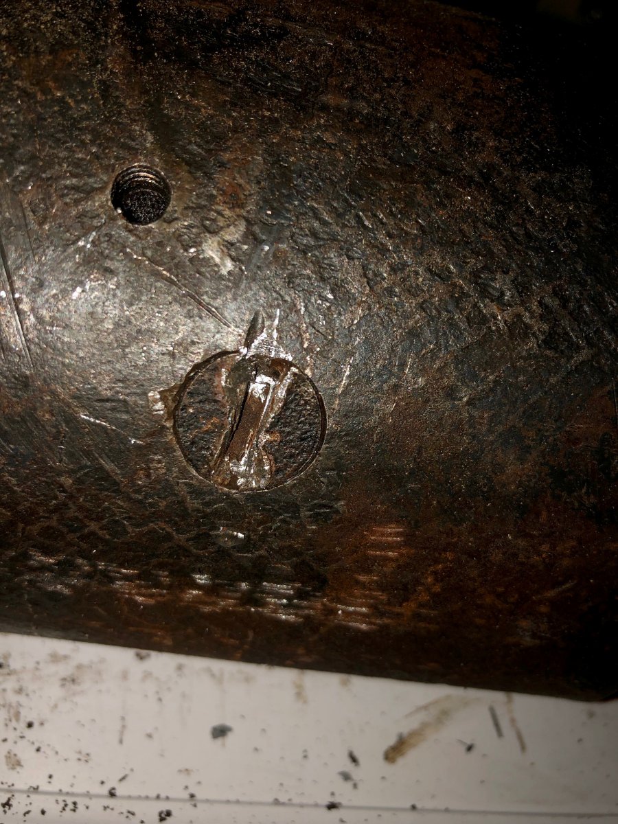

When the brake lever won't stay put it's at least annoying, and in some circumstances it can be dangerous.
The pawl was worn down to such a little nubbin that it wouldn't catch on most of the quadrant teeth.
Milt Webb's recent piece in The Vintage Ford suggested welding it up and grinding to fit, which is what I would have done anyway. Not having a good pawl for comparison, I overdid it a bit. When I installed the lever it had gone from moving too easily to not moving at all. I had to take it off and grind some more, reinstall it and try it, take it off and grind some more, etc. The third grinding got it right. With some filing on the quadrant and the pawl built up, my brake lever now stays where I put it.

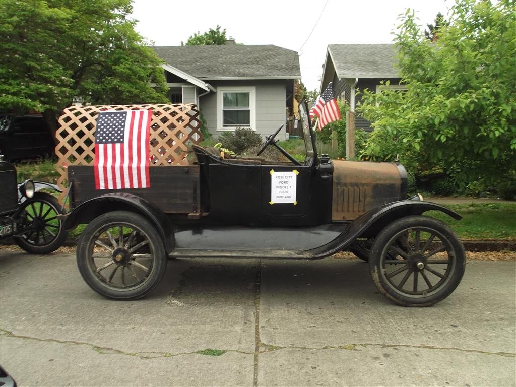

I am thinking about using the 25 for the parade here in North Portland as it's only about 1 mile travel. It has been sitting all fall thru winter now into spring. Put water in it, fresh gas, coils and a battery. When I turned the key to battery side, nothing. So turned the lights on to check meter, LOL the coils are buzzing!
Decided to try starting it any way. Turned the crank to check for spark at all the plugs, turned the gas on, gave it a couple of prime cranks. Turned the key, I mean lights on, first 1/4 turn she started. This is an old tired engine with cast iron pistons. Had taken the rods up when I got her and installed 2 1/8" rings in each of the top grooves so she has nice compression. Oh I figured out what happened, some how when I put the wires back on the switch backing plate after fixing the pins I swapped the coil box wire with one of the light wires. Here are some photos from last years parade;

Took the front axle off my runabout today. I'm going to Tulsa tomorrow for an engine/transmission reassembly session, and will take along the axle to install the spindles with new bushings, as Mike has the proper tools.

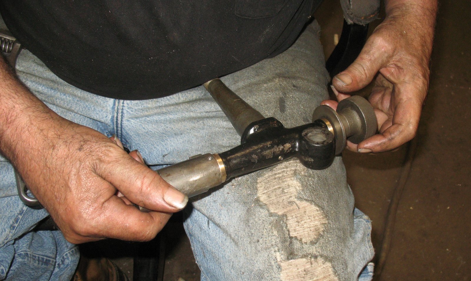

Change of plans: I'm going to look for a better axle. For my work day at Mike's I did mostly grunt work, sandblasting and cleaning. Mike handled the jobs that take skill and knowledge.
Machinist at work.
Taking off a sharp corner.
Removing old gasket and sealer.
Checking the pan. It was straightened a few years ago, but is a little off now. I wonder if that big pothole in Chicago bent it. I suspect that very few Model T's that get driven have perfectly straight pans.
Machinist at work.

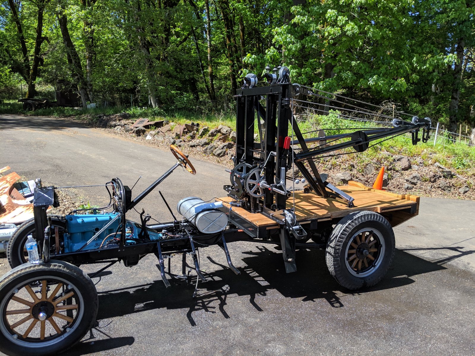

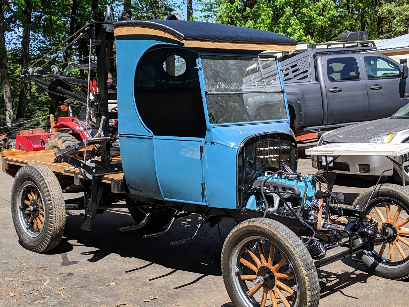

The tow truck is coming together. After some body work on the fenders it should be hitting the road. It's been 5 years in the making.
Tow TT's are neat. What type of wench? Pictures are always nice.
1925TT
- Posts: 48
- Joined: Wed May 15, 2019 10:45 pm
- First Name: Forest
- Last Name: Ledbetter
- * REQUIRED* Type and Year of Model Ts owned: 1925 TT Holmes tow truck
- Location: Oregon
- Board Member Since: 2014
It's a Holmes 490. Hand operation or cone clutch.
- Posts: 2844
- First Name: Dallas
- Last Name: Landers
- Location: N.E. Indiana
How cool is that. Nice job!
Tom Hicks
- Posts: 761
- Joined: Sun Jan 06, 2019 12:07 pm
- First Name: Thomas
- Last Name: Hicks
- * REQUIRED* Type and Year of Model Ts owned: '24 TT, '26 TT, '24 Speedster, '26 Speedster
- Location: Chesterfield, VA
Wow, looks like a first class rig!
After almost three months of part time "tweaking", I finally got my flywheel magnet clearances correct. It was a long haul, involving the correction of original Ford machining errors that were discovered during assembly. Now perhaps I'll get some "juice" to the ignition!
This morning is the start of final assembly of the engine.

Finished the top on the MP cab
Final paint on the 8in1
Mounted tail lights while paint dries on the 8in1
Took it down the road for the 1st time with a cab. The chicago 3 speed and high speed rear with the rebuilt engine makes it a screamer for a TT!

Part Two
Pressing new bushings into the spindles.
The spindle bushing reamer is really two in one. The bottom one cuts the bottom bushing to pilot the shaft, and the larger upper one cuts both bushings to fit the bolt.
This shell cutter flattens the surfaces where the bushing faces will fit.
That's flat enough.
The final step is cutting the bushing faces to fit.
That's flat enough.

Part Three
The axle is back on the car awaiting more reassembly.

Life is good, when you have the right tools Steve !! Good job

Life is good, when you have the right tools...
That's why I took the axle to Mike's shop.

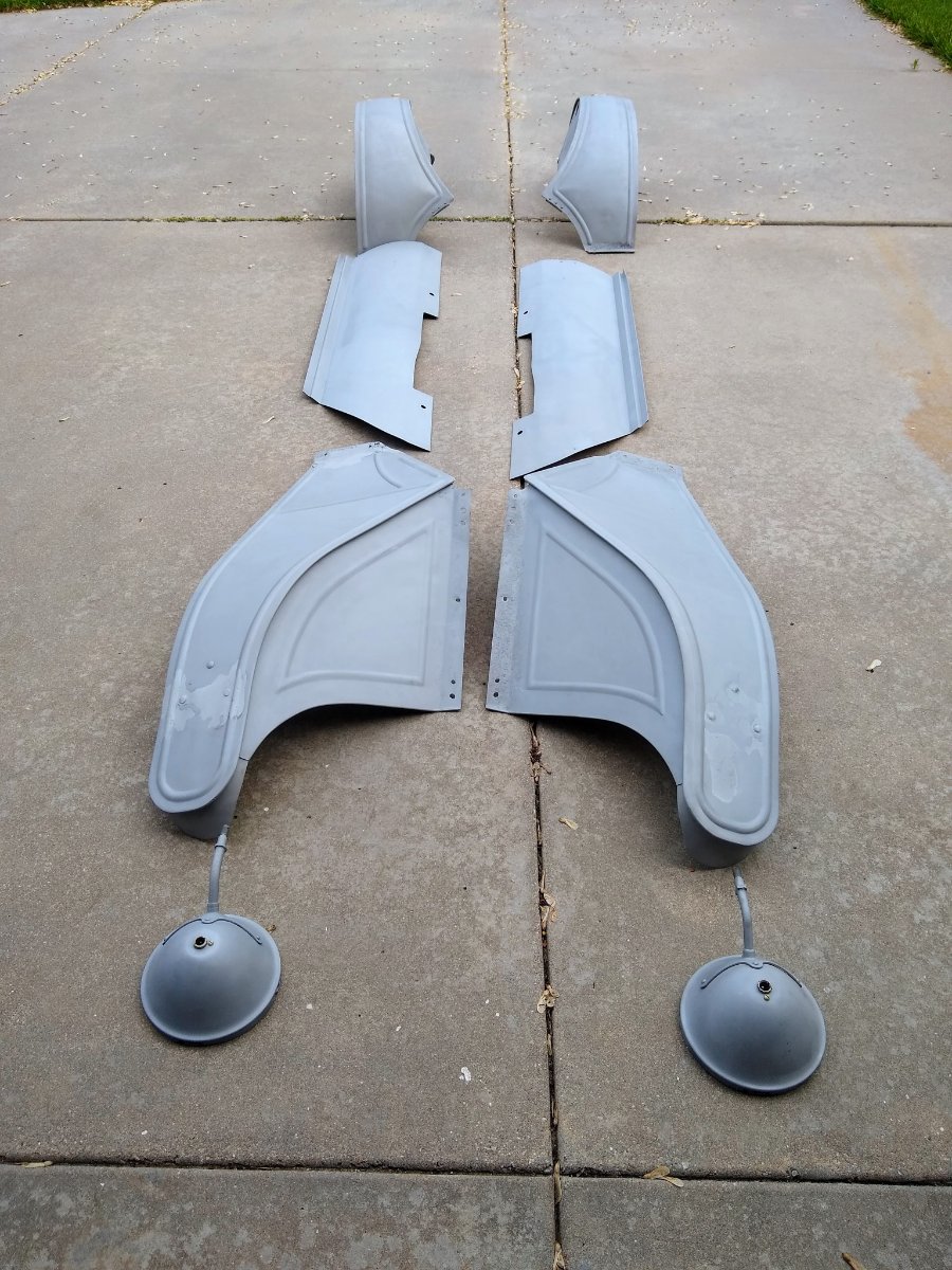

[image][/image]I have been able to make good progress so far this month on my 15 runabout restoration. Progress includes:
Getting my non demountable wheels back from Stutzmans. They finished them in less than 3 weeks. They do beautiful work! Current pricing is $190/wheel for correct year spoke and felloe shapes. I provided the wheel hardware and splice plates. I used appliance epoxy paint on the hub parts and bolt heads, but left the rims in primer because, based on past experience installing tires, I will likely nick them up a bit installing the new tubes and tires!
Got my fenders, headlights and splash boards low pressure/high volume media blasted by a company specializing in this process. Very reasonable price with no damage to the parts. I've since etch primed them. This was a very old original restoration, and there is some lead work on the front fenders around the area where the three rivets attach the brackets.
Finished removing everything from the body. I felt like I was working on an old piece of furniture instead of a car when I removed the upholstery and top. It is amazing how small a runabout body is once everything is removed.
Also got my running boards and leaf springs back from the blaster/powder coater. Reassembled the springs after applying slip paint between the leaves. After mostly disassembling for the last two months, it was nice to finally have something restored and finished!
Mike Bender has also been making progress on my engine, with getting the babbitt poured and the block and head machined.
We are working hard to get the restoration complete by the car's 105th birthday at the end of September.
Neal

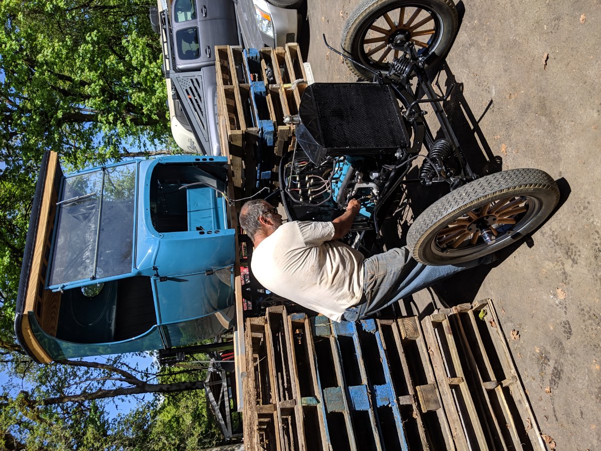

All of the blue is Done. Now to finish up the body work that will be black
Bi-weekly trip to the co-op for feed and fuel. I almost grabbed a bungee cord to secure the gas can to the runningboard carrier, then thought it would be better to be "period correct". A length of sash cord not only worked better, but looks better !
"Get a horse !"

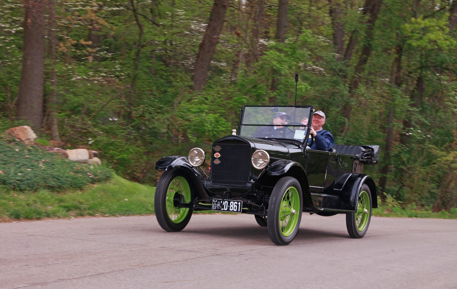

I drove my 26 in the Gilmore Museum tour. A photographer along the route (Museum volunteer John Lacko) shot this photo of me and passenger, Museum Education Director Fred Colgren.Folks, this is a do not miss tour.

I started to rebuild my generator but ran in to a problem right off the bat. I did not have the correct tool to remove the field pole screws and I made matters worse by using the same method as the last guy, a punch and hammer!
I did manage to get one loose, but the others would not budge. So I sacrificed one of my extra chisels to make a "tool" that would work and fit the new screw correctly to reinstall.
I then put it in my vise to hold the tool tightly to the screw. I tried using the 3/8" end wrench that fit the shank but I didn't have enough leverage. So I added some vise grips and a piece of 3/4" EMT conduit for added leverage. SUCCESS! the rest broke free easily. Now to get every thing cleaned up and ready to assemble.

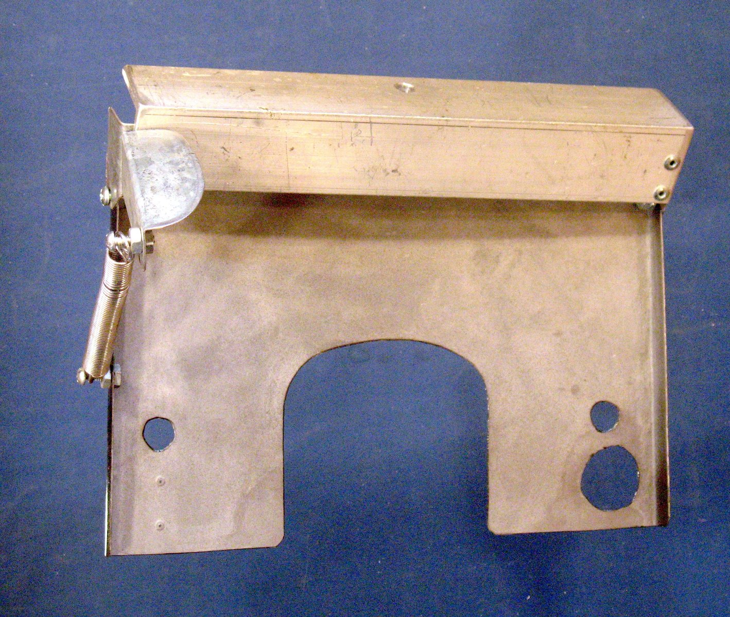

Yesterday and today I worked on an instrument panel for my 1923 touring car. I installed it this evening, but I still need to do the wiring.
Under construction. Making the thing is the easy part. Mounting it behind the dash is something else. Working on anything behind the dash of a car is torture.
On the left is a switched outlet for a phone charger. The switch on the right side is for a speedometer light. There's room for more switches if I want to add more accessories.
When it's not needed it flips back under the dash out of sight.

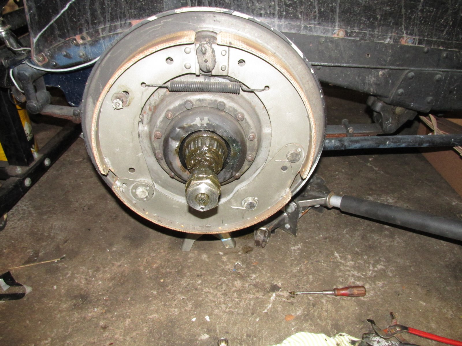

Havent touched the touring car but I did put new brakes under the 1929 Packard 640 roadster
