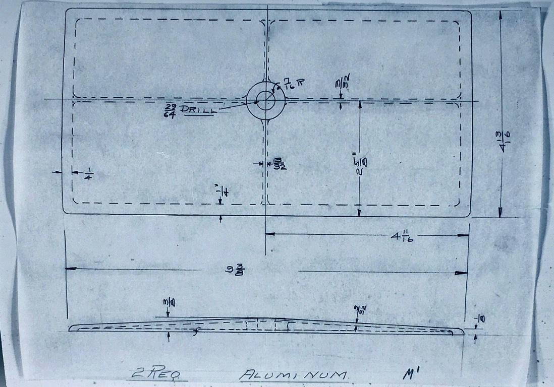

On a side note, Ford had designed, and used a 2 piece valve cover as early as the summer of 1911. This drawing (courtesy of THF, Benson Research Library, all rights apply) shows the two piece covers used on the largest Ford Special racer (initial 389, then 410 c.i.). This racer still exists at THF, off display, with these early two piece valve covers. Another feature Ford incorporated with this racer that later became an important safety improvement was an under axle wishbone.
Not necessarily pertinent to this thread, except to demonstrate that Ford’s racing program developed technology that made it to production years later.
