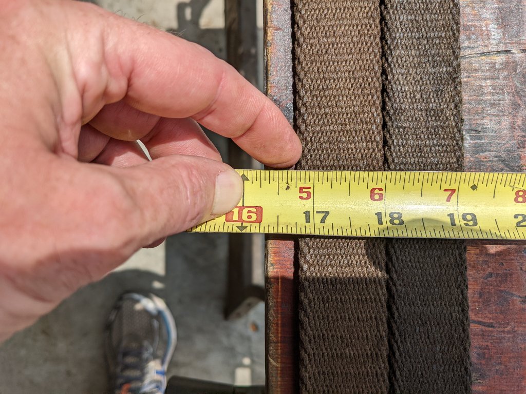

Mark Nunn
- Posts: 1288
- Last Name: Nunn
- Location: Bennington, NE
Re: Scandinavia Bands - What's the Difference between pre-1926 and 1926-27 versions?
26-27 wider brake band is on the left below.
