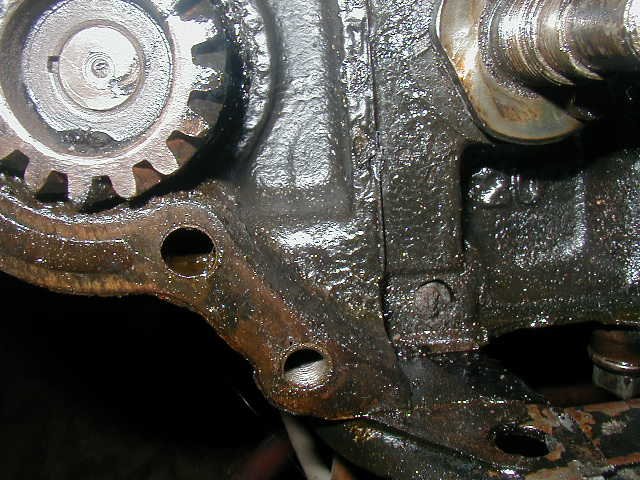

Is it OK to bump this Robert? Looking for timing info to send to an acquaintance tonight, I found this old pic of the 23 engine in the 18.
I needed to reset cam timing a few years ago as it was way off and found this nice ball of fuzz sitting in the end of the oil line.
Pulled it out and and blew more crud out of the line. You can hear it as you blow the line clean with air. Fttt, pssss.
No wonder the bearings need help. There's a screen in there now.

Duane... Thank you for adding your information to the topic, you don't need my permission, you help everyone when you share your information. Did you pull out the blockage from the cam end , or push it down and out from the funnel end? Compressed air at funnel end helpful ? Thanks !. .,and Thanks for the picture!!!

Thank you sir. You're very kind. Strangely enough, I've never had this transmission cover off so all work was done from right there at the front.
I may have never seen the oil line blockage but detective work said it hadn't ran for the last caretaker/rebuilder.
I needed to reset cam timing, move the poor accessory oiler output to a real thru bolt and wake it after 30/50 years +.
The transmission screen was installed very soon after. An unclean engine so I'm kind of gambling and need to check it again.
Cleaning/blowing out from the funnel end would be most ideal along with the front cover off in my opinion.
Then we don't blow a fuzz ball back into the system. Perhaps a burr in the end of oil line caught the fuzz ball.
The idea of going thru the inspection cover and blowing out the oil line is super cool. Sort of like I did yet easier.
Fttt when the next fuzz ball is blown out and psss when it's clean with air.
This psychOdelic time machine's engine is hot on top but not on the bottom. I type too much.
