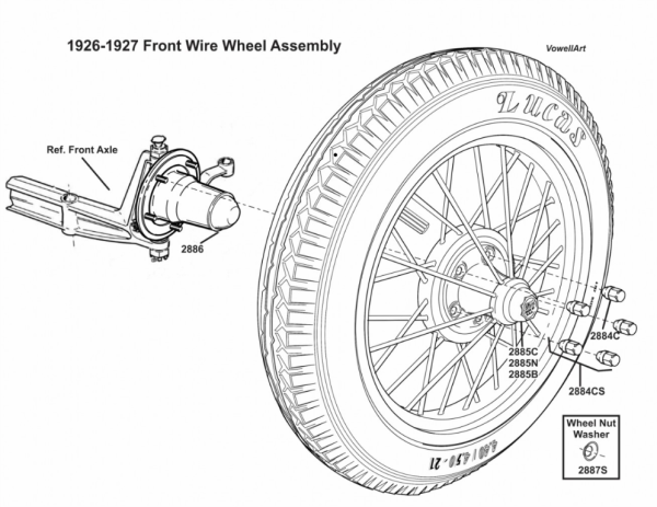

Steve, I noticed that you are running without the caps on the end of your front hubs. Are you not concerned about contamination getting into your wheel bearings?

I am also concerned about that, yes. I just haven't got the hub caps yet. I will though.

So, you didn't have them on there before you swapped wheels too? There is a dust cap for the hub and a hub cap for the wheel. Images from Lang's website.

Scott, thanks for pointing that out! The depths of my ignorance are vast... I did not know about the dust caps. Never had them (!) I see them now "2886". I will get some of those new repro hub-dust-caps at the very least - then I can hunt around for old beat-up wheel-caps. I would rather not buy new repro shiny wheel caps; they just won't look right on my beat-up old car!
