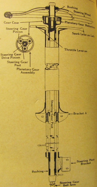

Correct spot, just above the throttle lever on the throttle rod as Jeff posted.
Try as you like to place it higher, but that little guy will wiggle down against the lever anyway. Sketch shows it against the lever.
