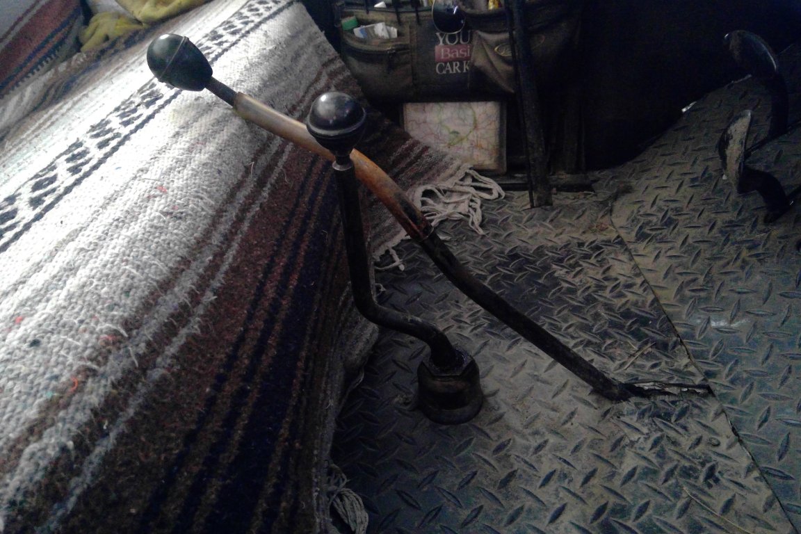

I have a TT with a KC Warford and Ruckstell. The levers are close, too close but I can shift them. I plan on bending one a bit one way and the other a bit the opposite way. Just to get a little more clearance.
Lang's sells a Rucstell left hand shift lever. I purchased one to use on our Center Door. This lever is very much like the brake lever and actually uses the same slot. I'll try to post the link: https://www.modeltford.com/item/P189B.aspx
